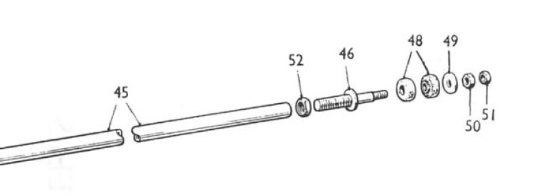

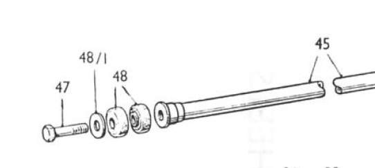

There are different nuts used on the panhard bar. Take a look at the two screen shots from the Tiger parts supplement manual.

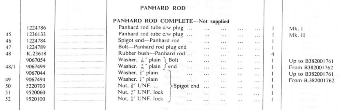

And here is a screen shot of the parts list for the panhard bar.
Since it is hard to read in the screen shot the fractions for the nuts, here is what it says:
50 5220703 Nut, 3/8" UNF
51 9520060 Nut, 3/8" UNF, lock
52 9520100 Nut, 5/8" UNF, lock
A 5/8" UNC nut has 5/8"-11 threads. And the 3/8" UNC nut has 3/8"-16 threads.
Good luck with your panhard bar!
