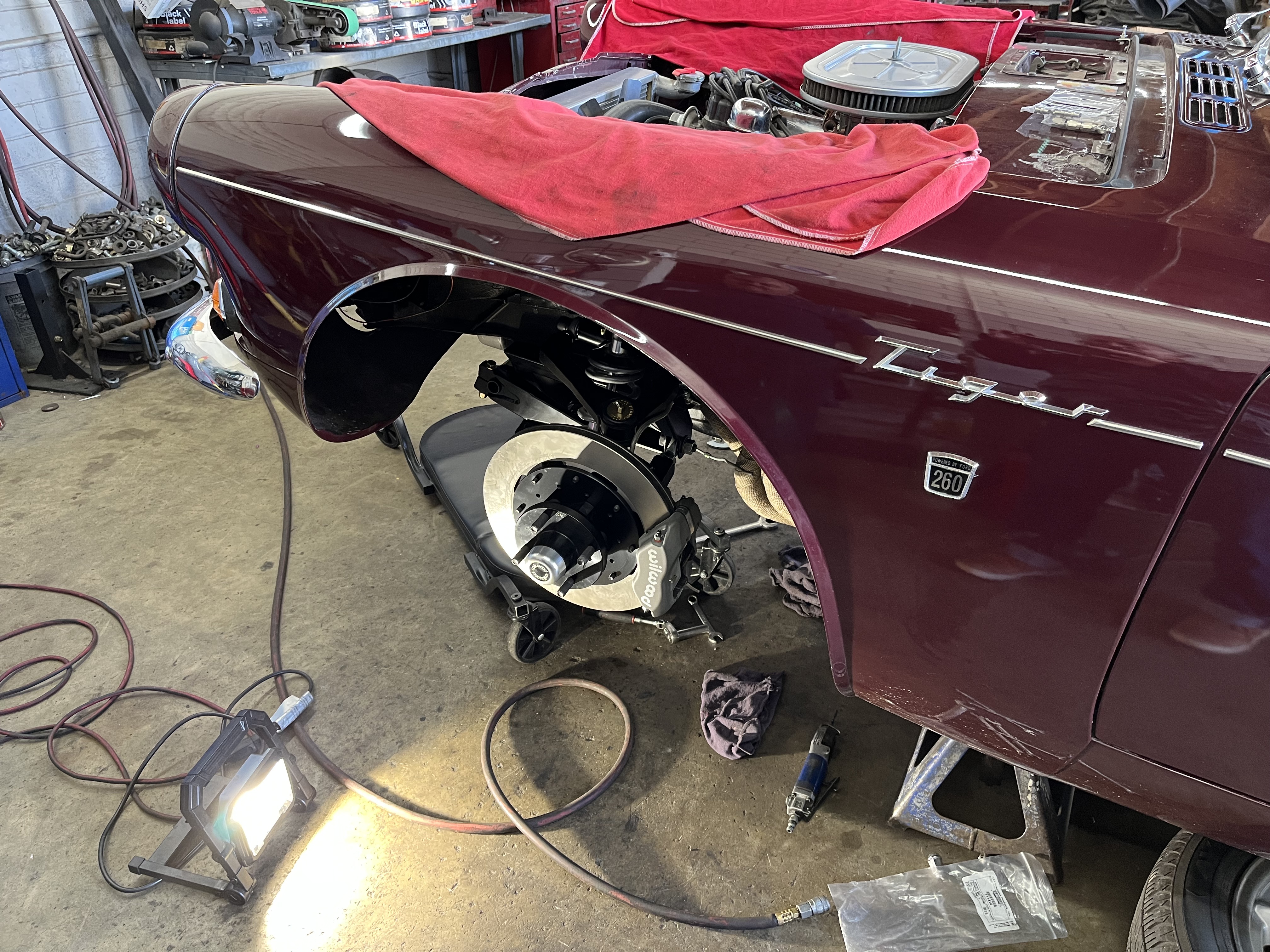

I am present owner of Lou Anderson’s Tiger, sadly the kit was removed. So, a Dale’s kit being installed right now. He does them by order only.
