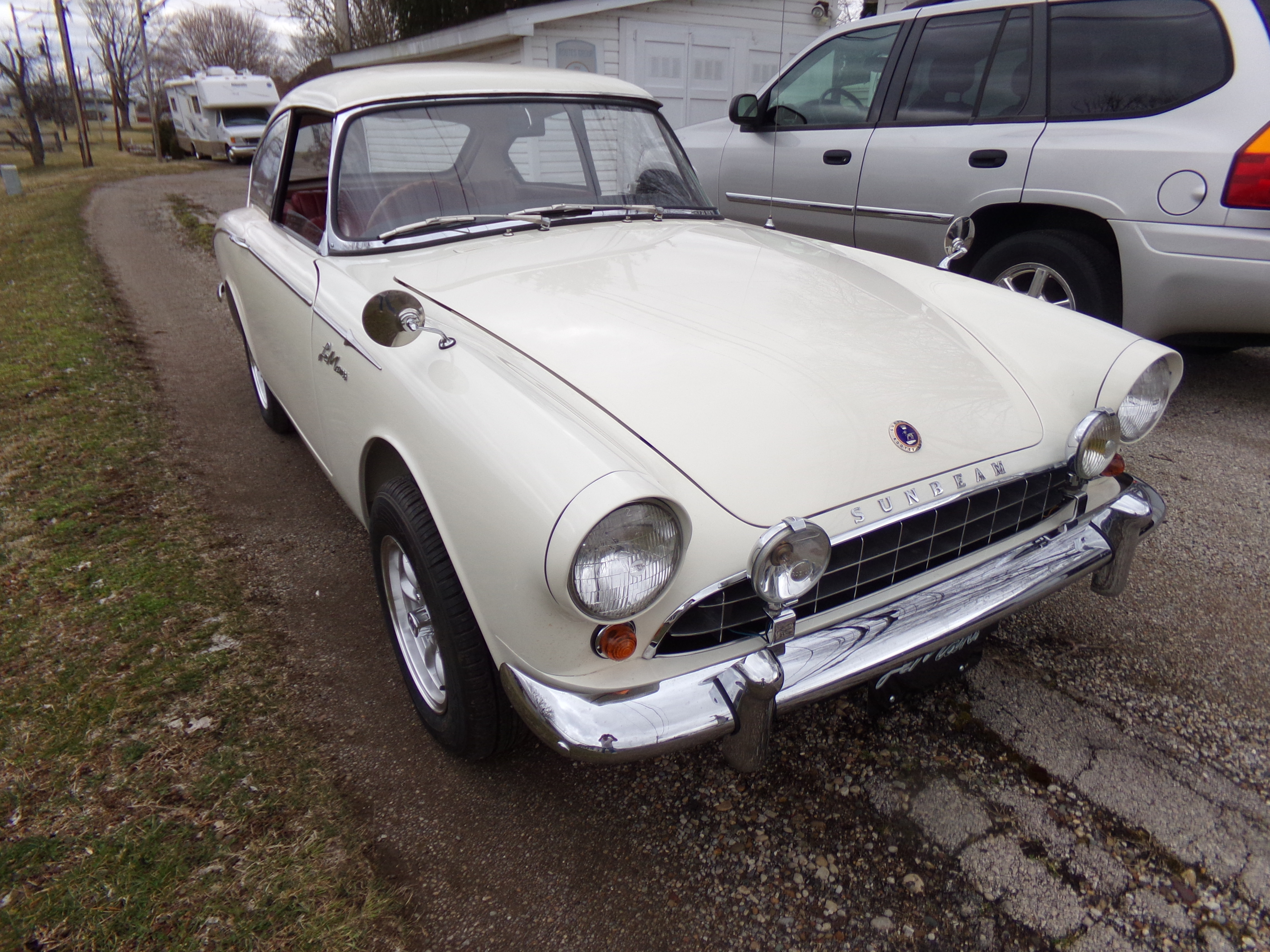

FYI, VTO wheels list a 15X6 wheel for Tigers and their wheels show roughly 1 inch or 24mm off set. I have their 13 X 5.5 wheels on three of my cars and the off set is 19mm. A 3" off set plus an adaptor may cause handling problems. This photo gives you an idea of where the front tires set under the fenders. The amount of tire extending past the front fender lip is at the edge of the tire tread so that's maybe 1/2" to 3/4" past the fender.

So, if I understand what you are saying correctly, you have a 19mm offset on the front, and it still sticks out past the fender??

Yes, on two of my cars. I also have them on my 69 fastback Alpine GT and they are OK but it's an entirely different body with struts instead of upper and lower control arms. VTO lists a 15X6 wheel in the 8 spoke as having a 24mm offset which is less than 1 inch. Their 15X7 has a 12 mm offset. Google "wheel offset" and read how to measure the offset of a wheel.

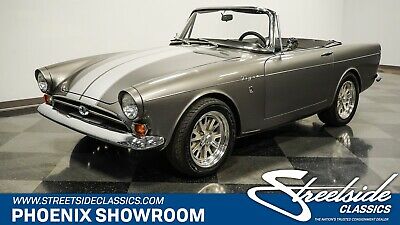

The sunbeams are very prone to having aftermarket wheels sticking proud at the front due to the location of the hub mounting face to body.
Ro keep them inside you need a shallow outer lip and the rim to go back inside.. This can then causes issues with interference on the steering arms.
Your springs, ride height and if the front valence has been trimmed will also impact any further issues with body contact.
Pse used to offer wheels that work.. They have since been bought out.. There is a tiger on ebay with a different design halibrand style wheel im 15x6 thats got the right offsets.. As you can see shallow front outer rim and stock ride height

VTO does have listed for Tigers a 15X7 wheel with a 12mm offset. That's an inch wider wheel but half of the offset of the 6" wheel. Anybody installed a wheel this size on a Tiger?

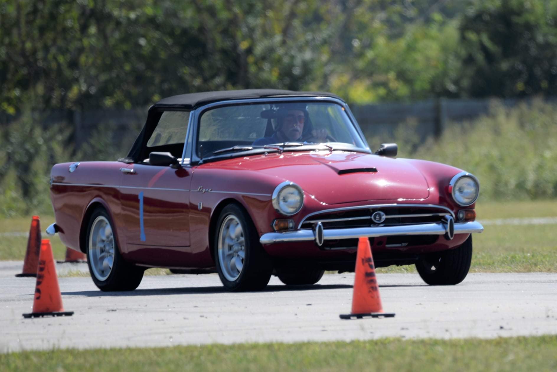

I have 15x6 with 20 offset on front and it pulls the wheels in fine. Mine are Rota.

Previous owner had put on 7x15 offset 20 all around with 195/55 but had spacers on front as wheels hit tie rods on sharp turn. Changed front to 6x15 offset 20 with 185/55.
