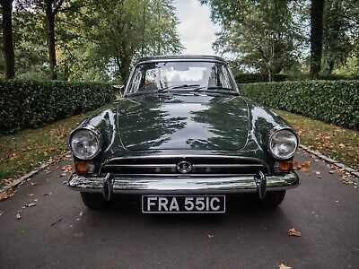

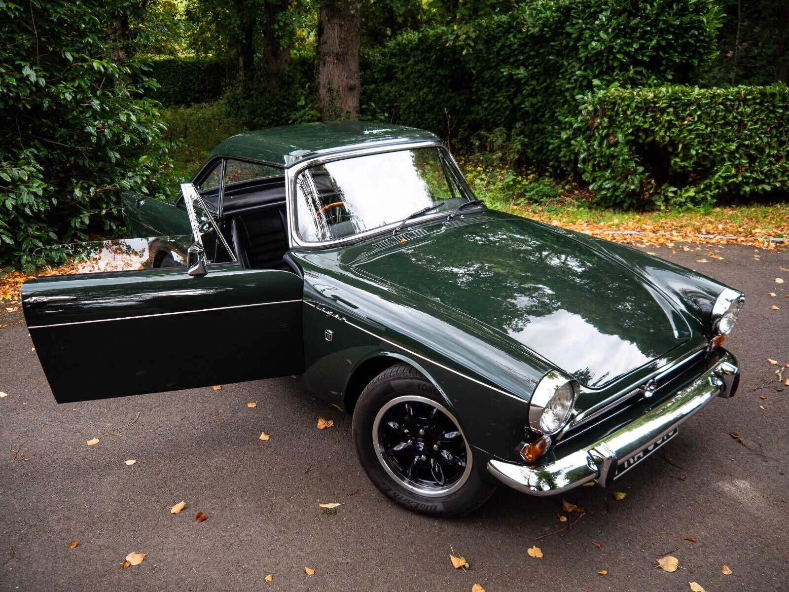

This time on EbayUK... listed by private vendor B9472191HROFE This car should have round corner panels and a metal top cover. It has square corner panels and a vinyl top cover....
Ebay item # 134436936022
4,152
Shaun,
I think add the VIN to the thread title... I thought the way they are trying to dance around the rebody is interesting.. it also implies when they did find a SV alpine donor it was the same colour as the Tiger that got scrapped.... And that when they did the rebody they didn't completely strip the car to bare metal... The the idea that because the VIN and colour code is listed in the BON as a justification..... Creative....

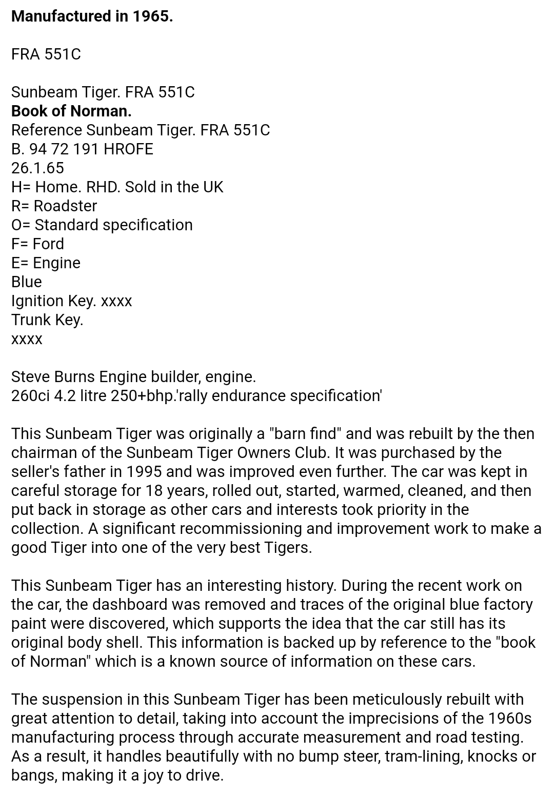

"This Sunbeam Tiger was originally a "barn find" and was rebuilt by the then chairman of the Sunbeam Tiger Owners Club. It was purchased by the seller's father in 1995 and was improved even further. The car was kept in careful storage for 18 years, rolled out, started, warmed, cleaned, and then put back in storage as other cars and interests took priority in the collection. A significant recommissioning and improvement work to make a good Tiger into one of the very best Tigers.
This Sunbeam Tiger has an interesting history. During the recent work on the car, the dashboard was removed and traces of the original blue factory paint were discovered, which supports the idea that the car still has its original body shell. This information is backed up by reference to the "book of Norman" which is a known source of information on these cars."

Like I told the owner of the car... what's in the 'Book of Norman' is meaningless as it pertains to this car. The chassis number is way too early to be a transition body. Besides, even if it were a transition car, it would still have metal top covers/doors. There were only 2 cars with a B947 prefix that had a vinyl top cover (B9479976 and B9479976) The car is a series 5 Alpine with the parts from B9472191HROFE... it's the same situation as the MED Blue car that was on BAT a couple of weeks ago. Riveting a Tiger chassis plate onto an Alpine does not make it a Tiger... only this car is even worse, as they didn't even try to rebody it with the correct series shell....
bernd_st
316
OMG. An absolute fake indeed.

Just received a reply from Graham Vickery in the UK. The club knows that this car is a re-shell and has known about it for decades...

of course, the shell he used is most definitely NOT the same specification as it should have a series 4 type shell and the car was "rebuilt" around a series 5 shell... so 2 couple of fails!
