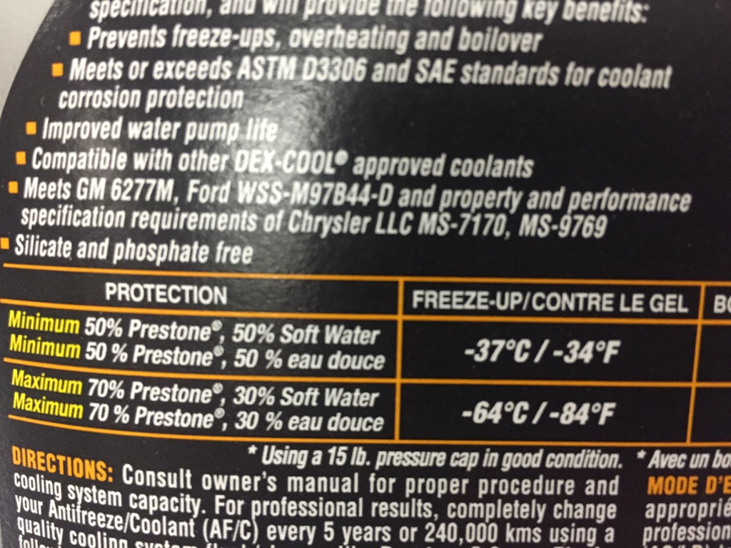

You're not paying for just water. A 50/50 blend also contains the other additives along with deionized water. The blenders do not use tap water. It's not that easy. I hope you agitate or mix the concentrate before you make your two gallons. Coolants can be just as complicated as lubes. Use the wrong blend of either and you shorten the life of the engine. My sales of premixed coolants is about 90% of my total coolant sales.
I'll take my chances... rain ( tap ) water is pretty 'soft' here on the wet west coast
