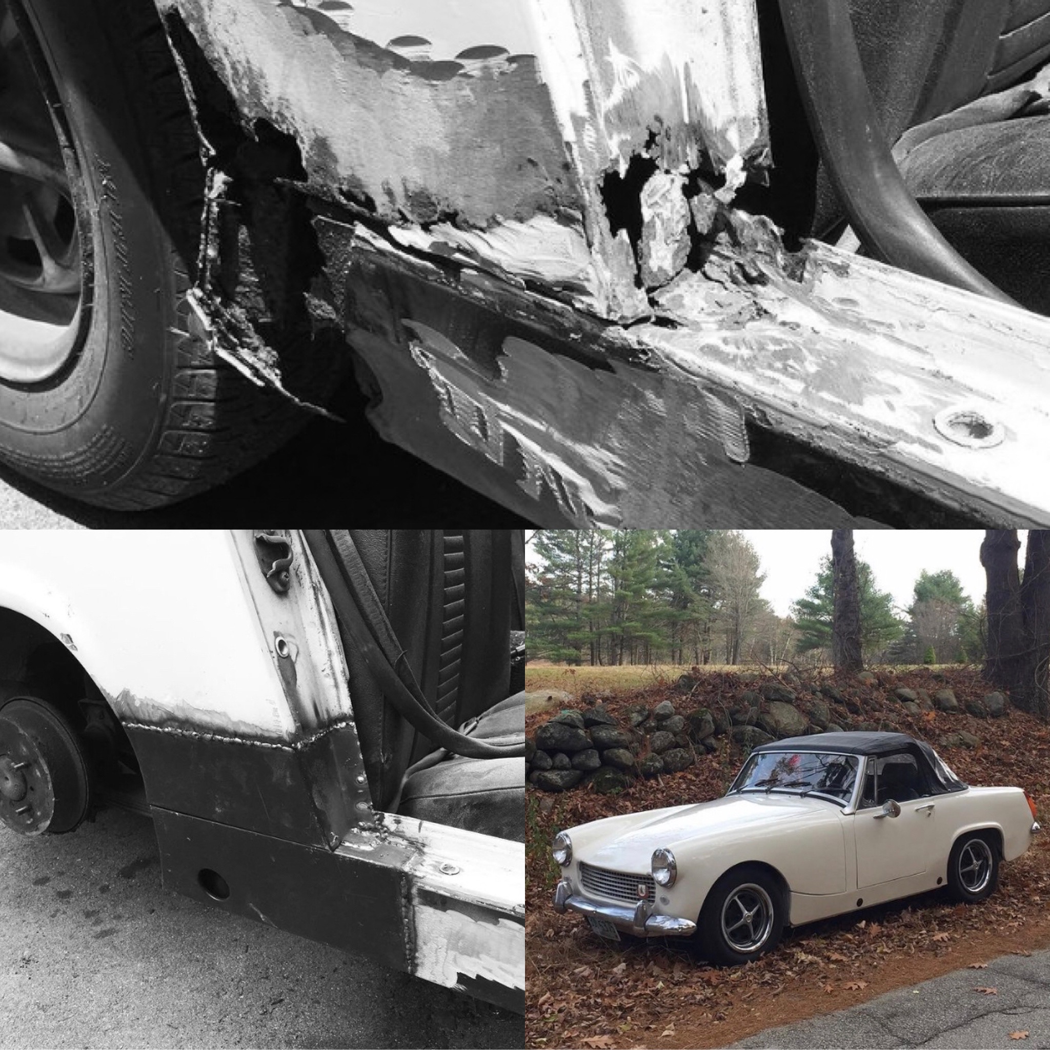

You could say I need to keep up to date on my tetanus shots ;) Iā€™ve parted out and dissected 2 trashed Alpines over the years and saved metal from cars that I knew I might need for the inevitable basket case I would end up getting, honestly thought I would be building an Alger back when the market was nuts. I was getting ready for the worst Tiger imaginable, other cars got in the way the past few years, parts gathered dust, and now weā€™re here.
Here is a pic of the ā€œgoodā€ side of this MG I did, had to do inner rocker and 2.5ā€ into the driver floor on the other side yikes! Usually donā€™t take pics with dirty hands but iā€™ll be taking more time for photos on this one. Itā€™s an important one for me, the one if you will.

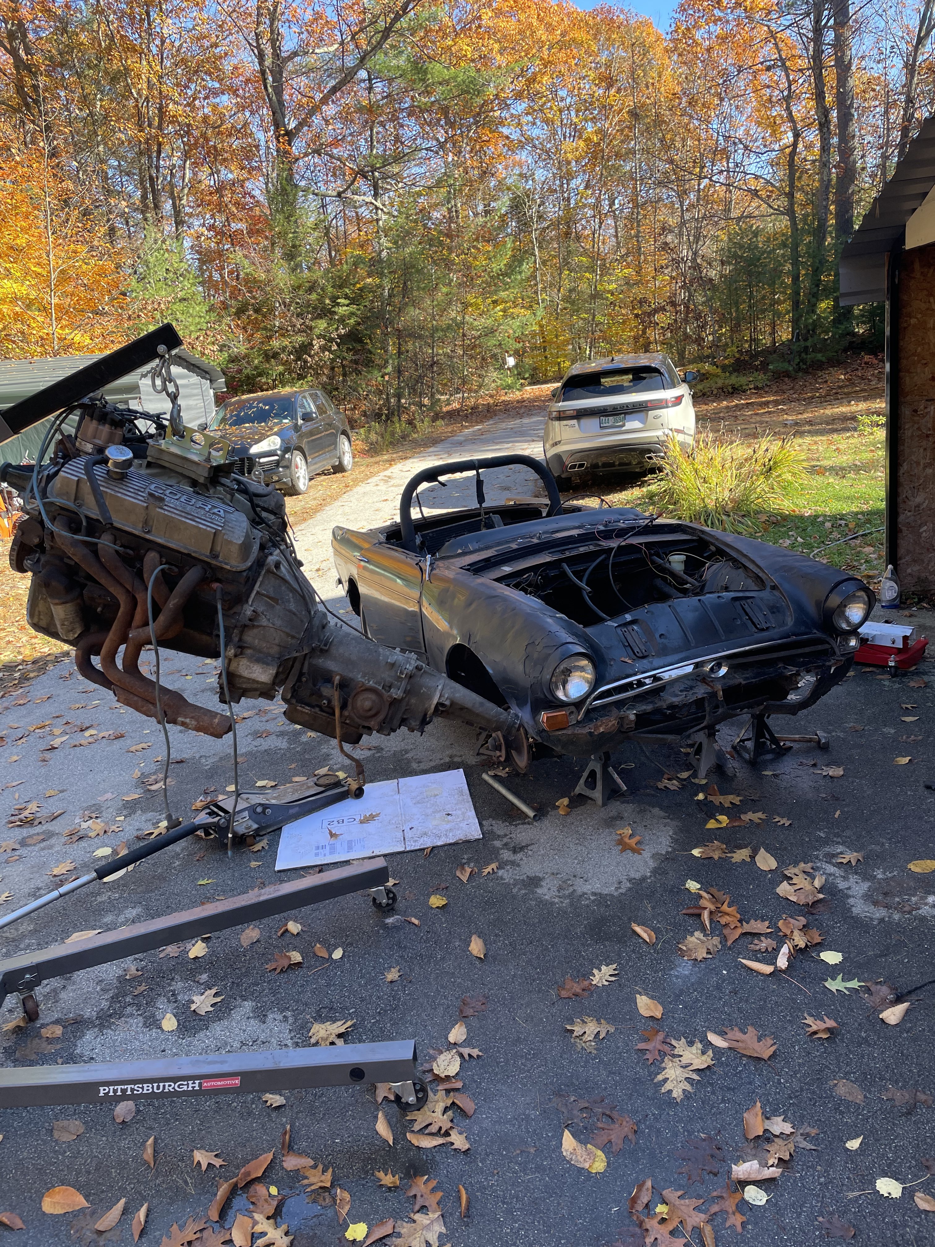

Hi again all,

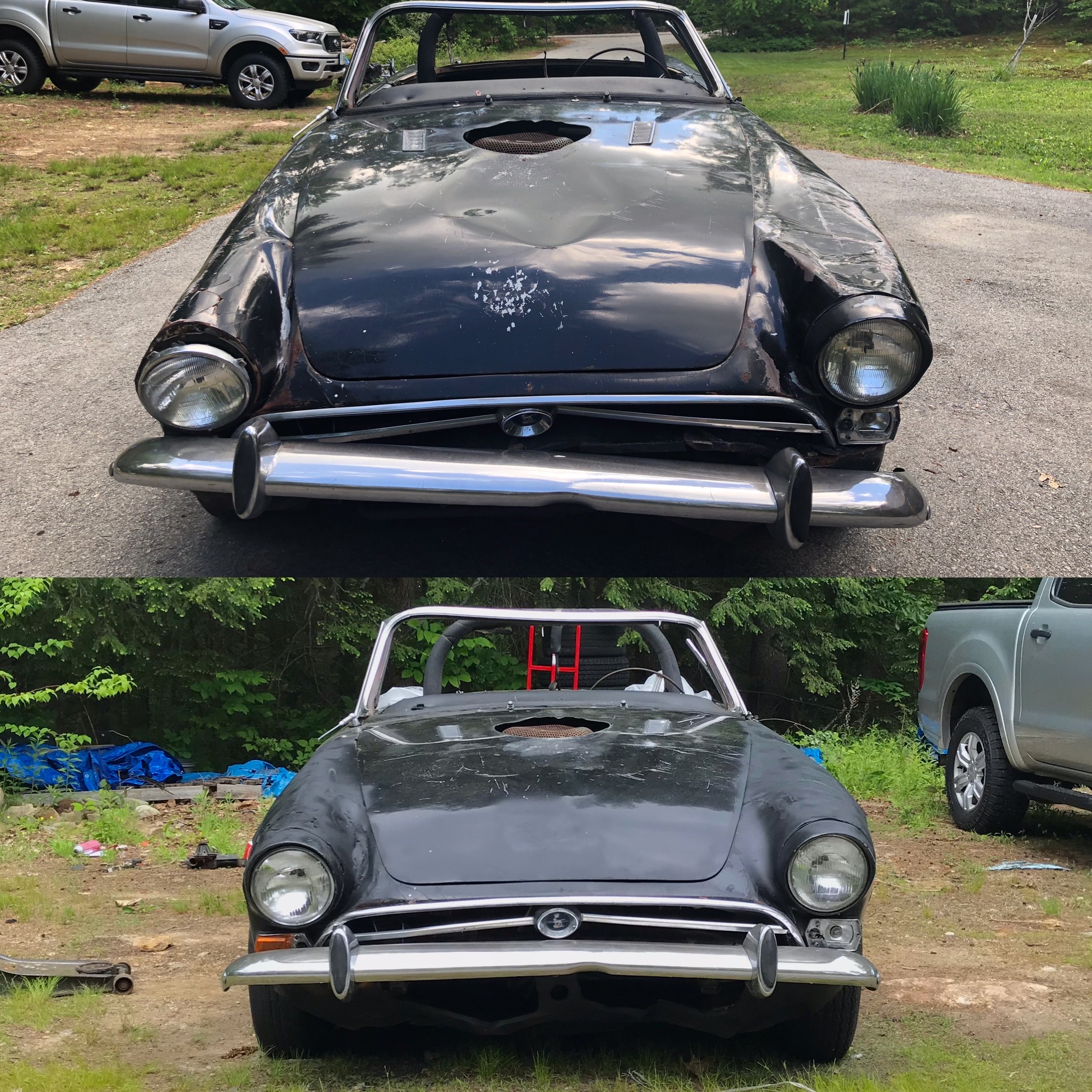

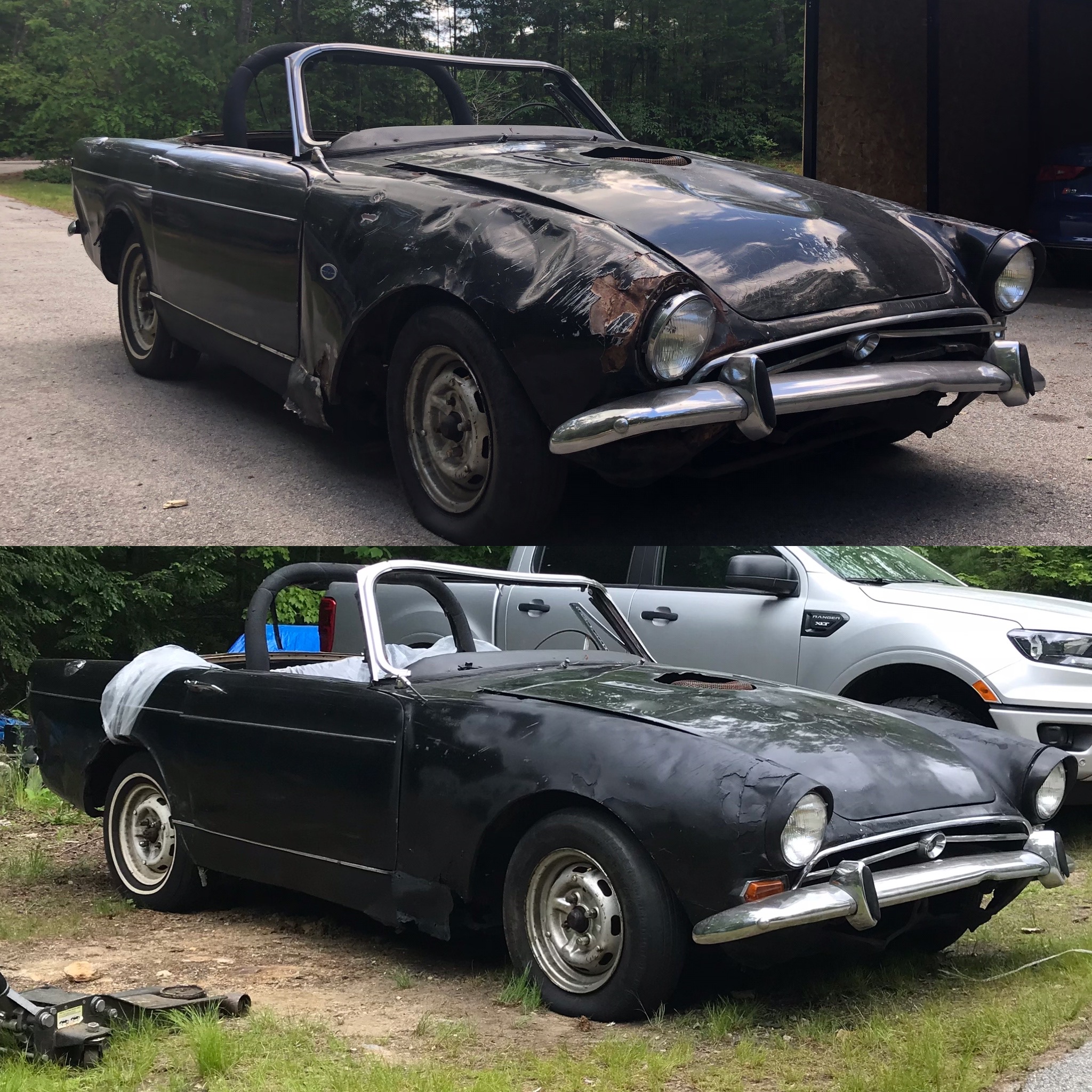

So she arrived last Thursday and so far iā€™ve knocked/pulled her straight (into ratrod status haha) so I can plan out my rhinoplasty. Everything else on the body/underbody is better than I had anticipated so weā€™re off to a good start!!

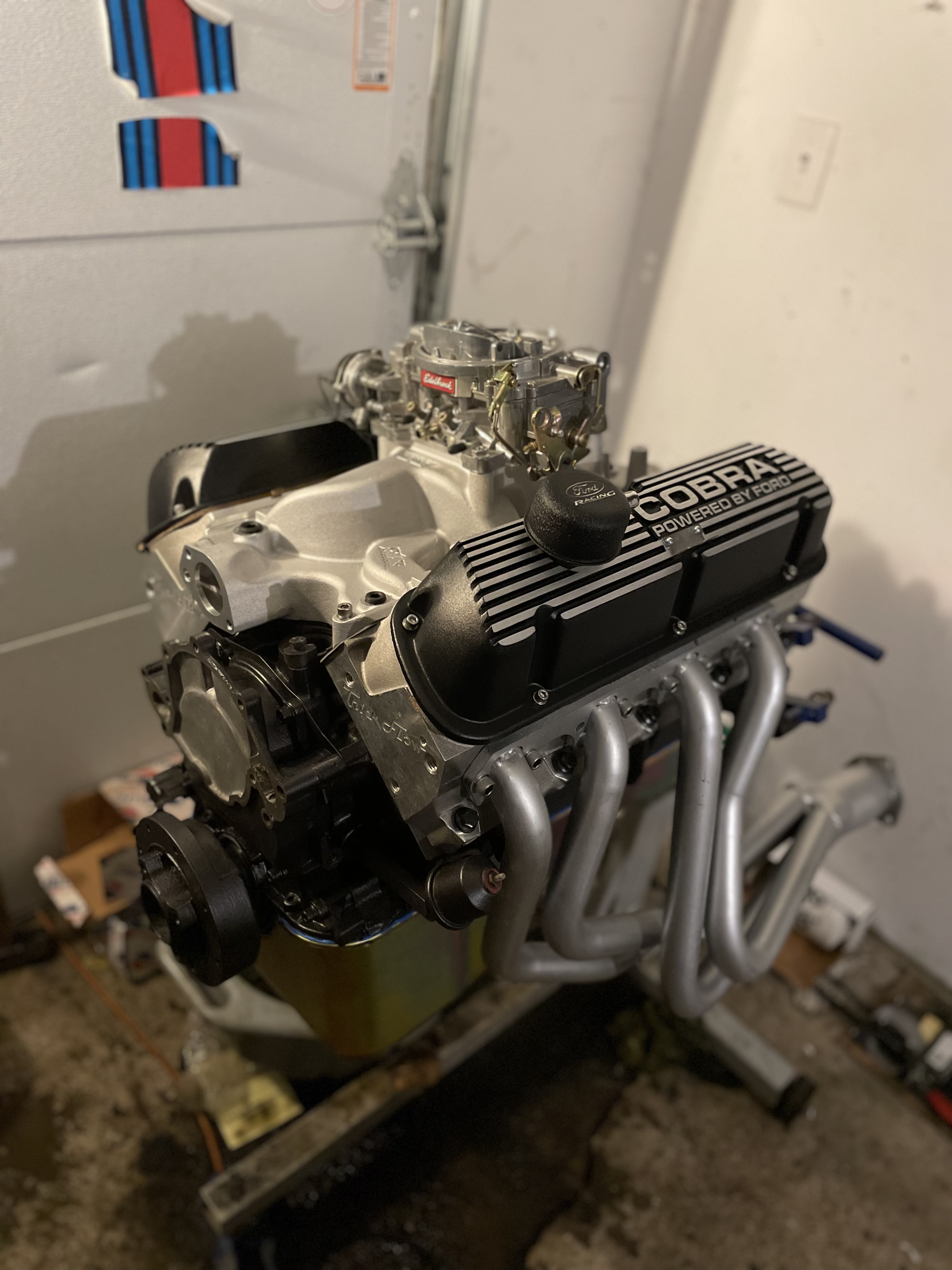

Iā€™ll be finishing up the roller 302/T5 build in the next few weeks, so iā€™ll post up some pics of that soon.

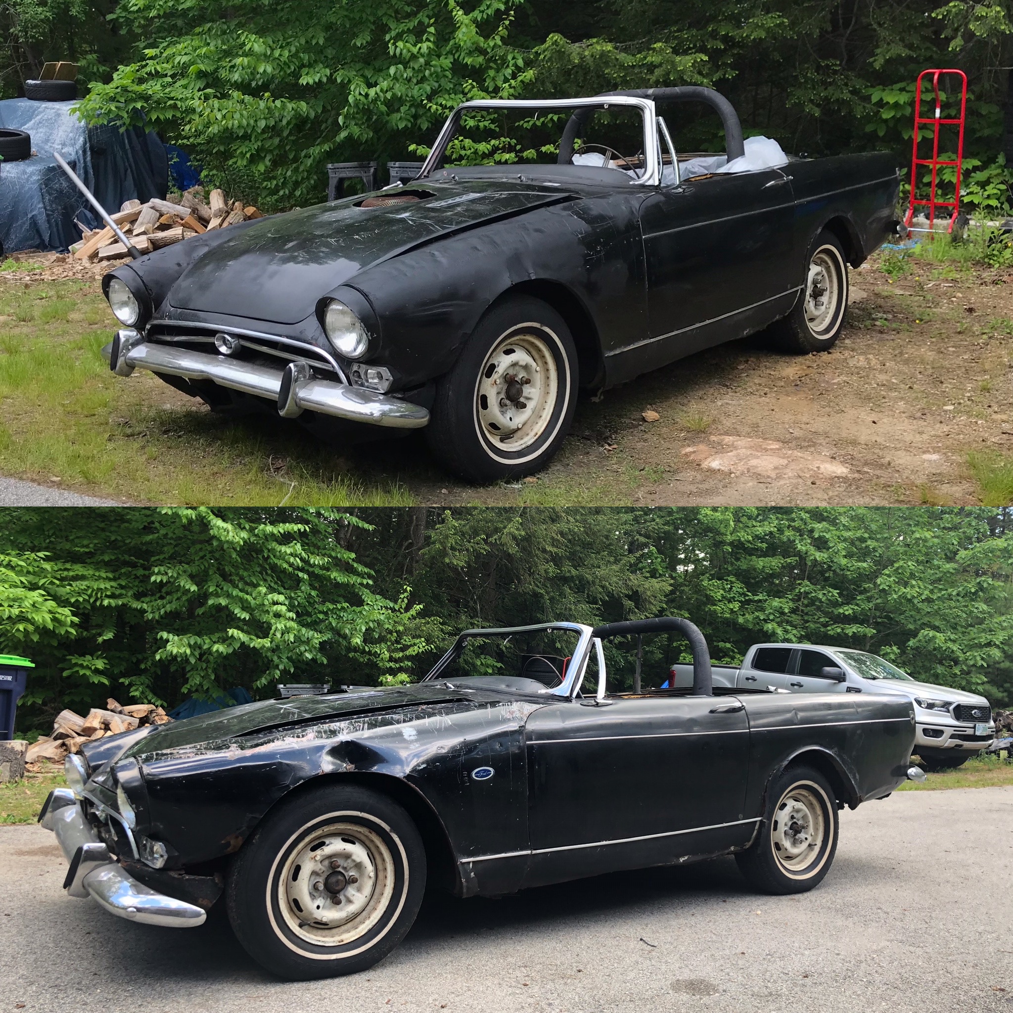

Have to mostly work on other peopleā€™s rust bucketā€™s through the winter but wanted to post a couple pics of the Cat in 2022, it being the ā€œYear of the Tigerā€ and whatnot šŸ… šŸ˜ƒ car will be ready for paint mid/late summer ā€˜23, iā€™ll get better pics of it totally ripped/torn apart prior to paint too.
