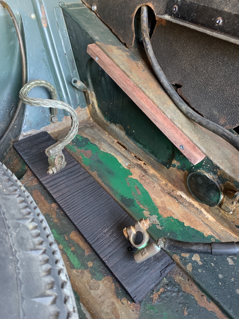

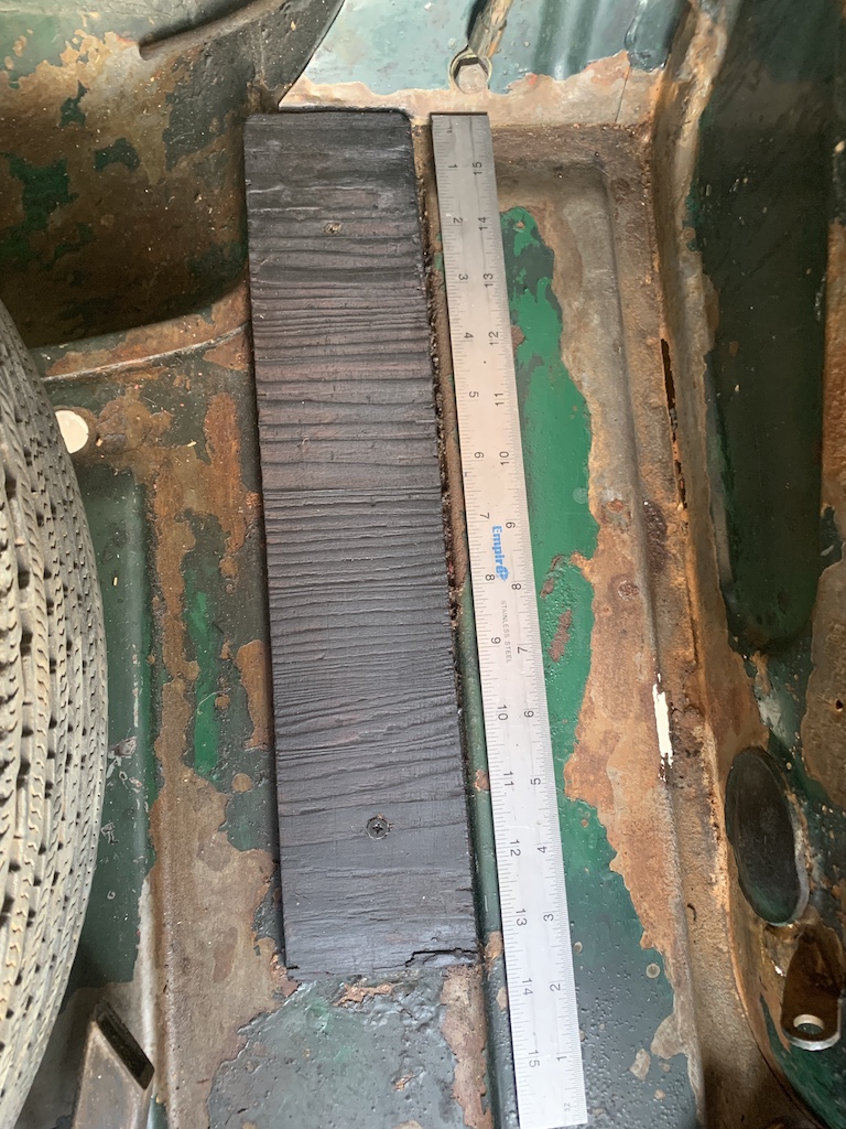

Sorry to resurrect this 4+ year old thread, but I was just going to ask about this piece of wood under the battery tray, if it was factory or not. Searched and found this thread. Anyway, thought I'd add a pic for posterity. Mine measures 13 1/2" x 2 7/8" x 3/8" and appears to be a dark 5 ply plywood held down by 2 flathead screws.

The pic of the bottom ply looks non-factory fer sure. There should be evidence of two #4 screws where the side rail was mounted. It was about 9/16" square and a foot-ish long. I use cedar for my replacements.

My Mk1 had a plastic tray under the battery and a timber piece screwed to the frame rail to hold the battery away from the rail. I have reused the timber piece and the plastic tray.

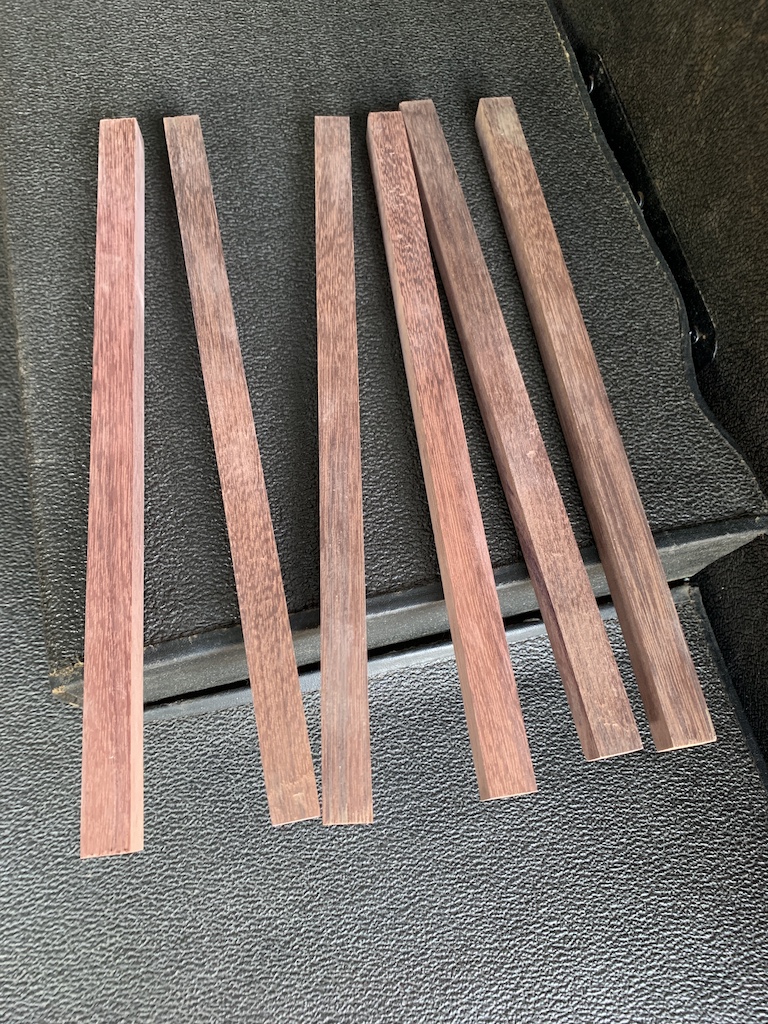

Yes, 2 holes there, one can be seen above the plug in my previous pic. Had a piece of mahogany laying around, 17/32" thick. Squared it up and cut to 11". Obviously this area of the trunk is going to need some work in the future. Thanks for the info.
KenF
396
I cut down the whole board of mahogany into 6 other pieces while I had my table saw setup. If anyone wants one for a couple bucks to cover US postage, PM me.
