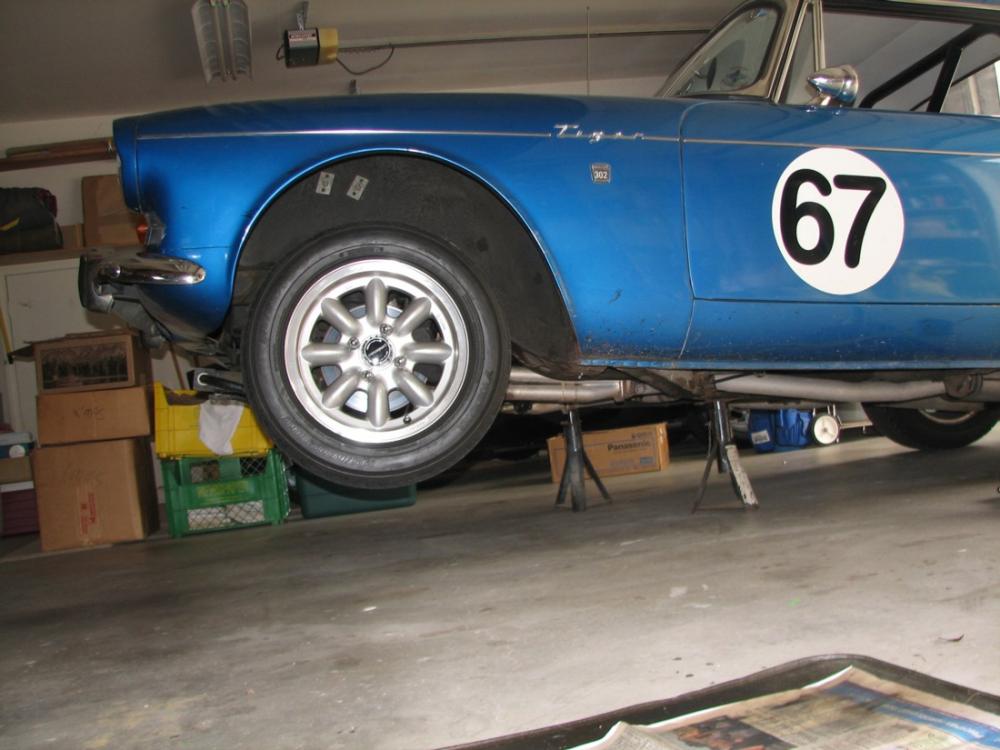

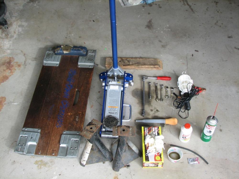

Jack it up as high as safely possible. Use safety stands!
Use fender covers always but be very very careful with the brake fluid. It eats paint to the metal if you let it. I know this.

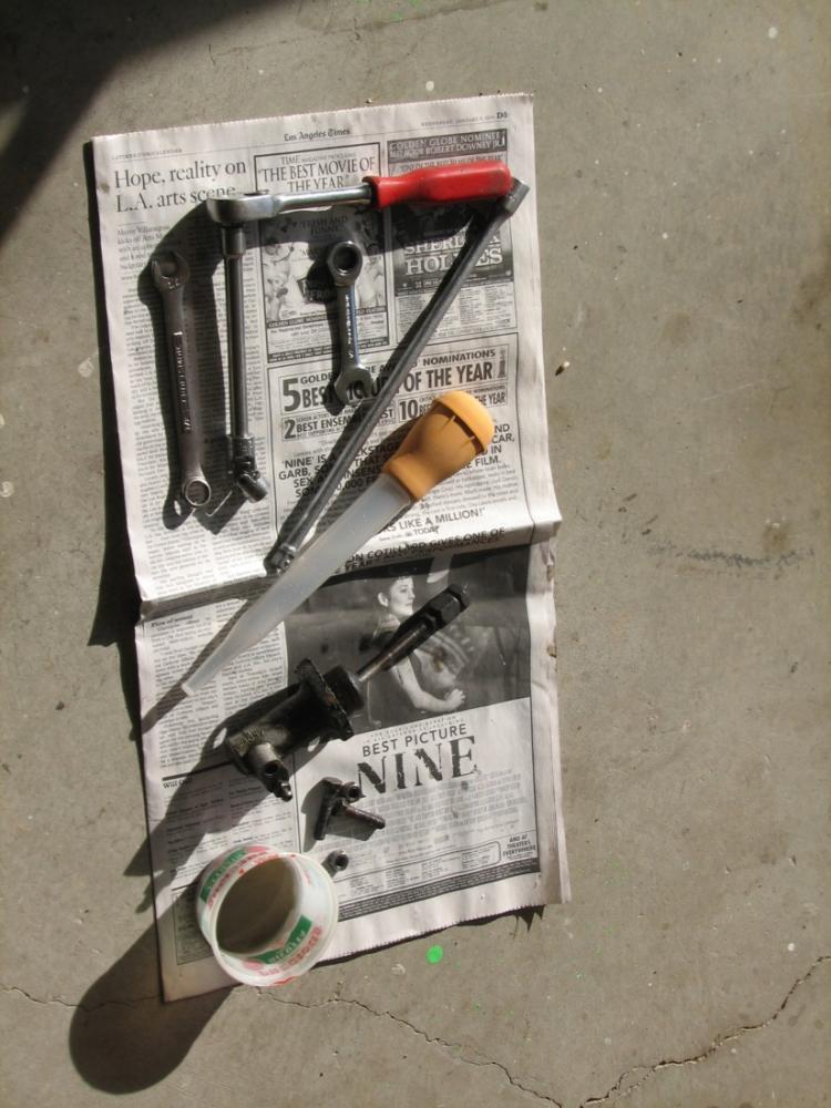

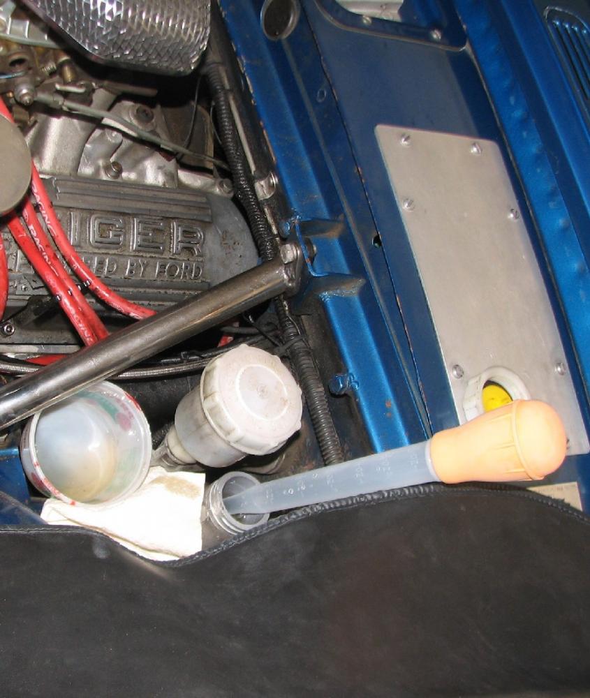

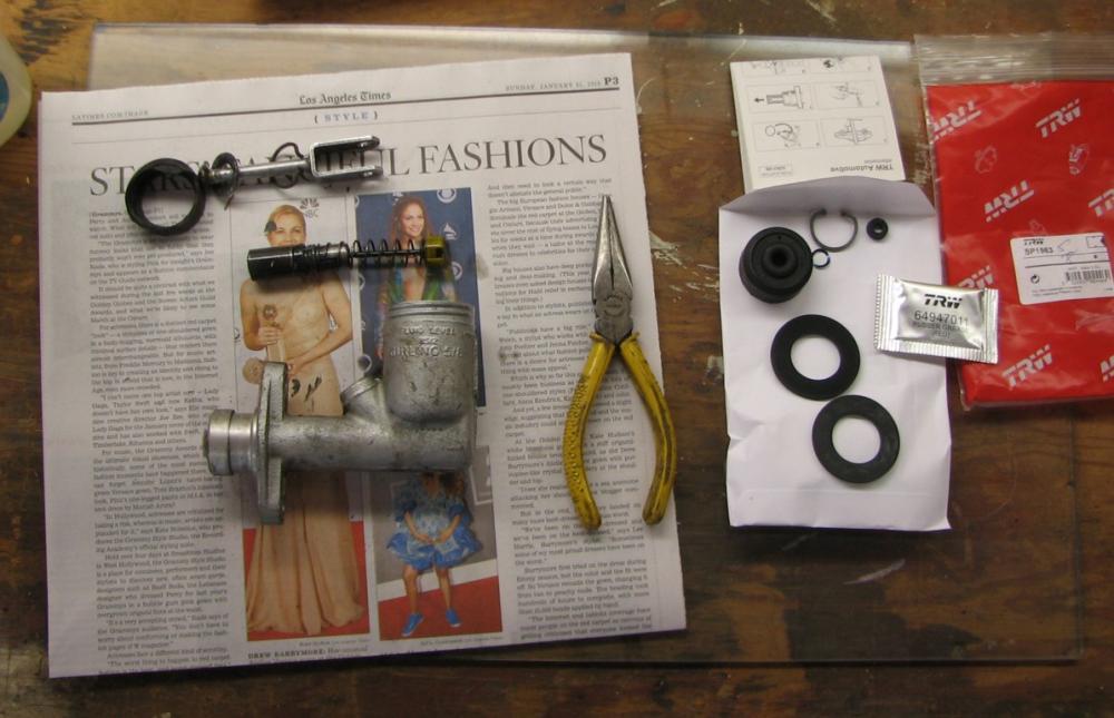

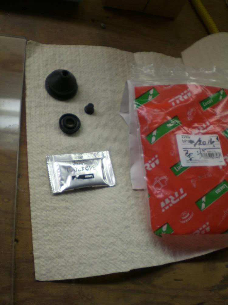

The rebuild kit had nothing you could call instructions. Only three parts and some lubricant. I only used the new boot and piston seal. The third part appeared to be a dust cap for the bleeder. Did not fit, I tossed it. There was some minor corrosion near the lip of the cylinder which I cleaned up with very fine grit. The bore further down where the seal moves looked great.

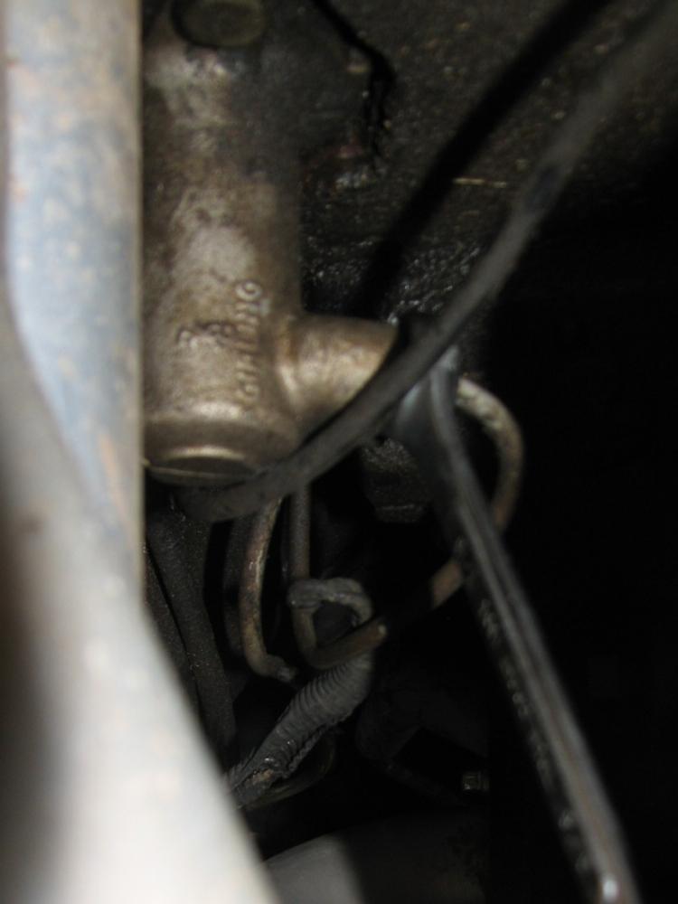

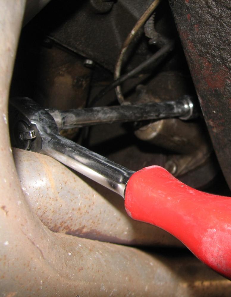

Be careful with the flare nuts on the hydraulic lines! Flare nut wrenches are a good investment to avoid rounding the flats off. The hydraulic lines are stiff, so do not bolt everything up and try to thread it in. In that tight space it is easy to cross thread. I did! and so I gave myself a time-out to think about a better way. The following day I removed the cylinder from the car again and used the bleeder (same threads) to clean up/chase the threads for the flare nut. Then more carefully with the cylinder free to move, (no bolts) succeeded in getting the flare nut started and several turns in. For the second time I installed the bolts and tightened things up. Whew! Dodged a bullet there!

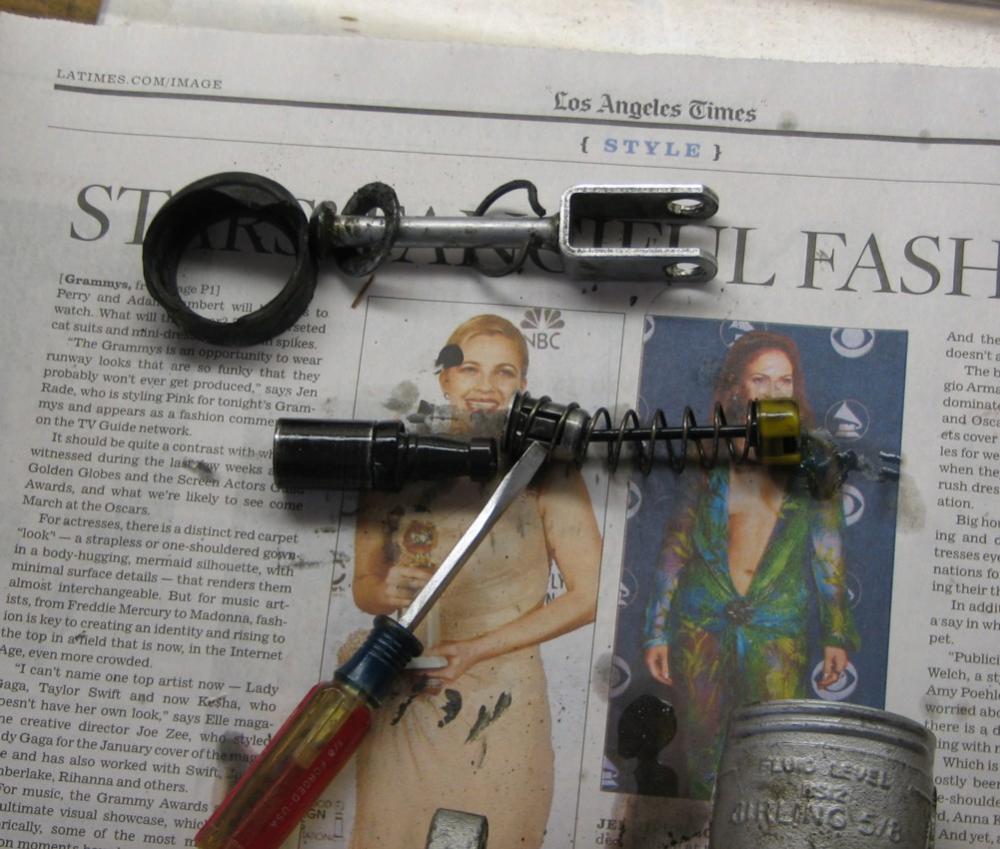

The piston and assembly is more complex in the master cylinder but I studied it a bit and guessed right as to how to take it apart. Check the photo and note the tab which the screwdriver tip points to. Assembled, that tab is bent inward to catch under the shoulder at the end of the piston. I pried it back outward and the piston was removed.
I was glad I had pictures because the spring is still under tension. The rod inside the spring is held by a slot with an open side. With the piston centering the rod it is locked but after the piston is removed it can and did let go like a mouse trap if handled a little.
After replacing two rubber parts it went back together easily and I bent the tab inward to catch the shoulder on the piston again.

I read through your posts earlier and just now sat down to look at your pics and the first image I looked at was Tiger Blue, front end up, on stands.
I still have a pair of jack stands just like yours but I would only use them on a bicycle. The cross section through one of the 3 legs that carries the load down to the base is almost flat and very thin, we're talking sheet metal thin, which could buckle very easily especially if you were to go around to the rear end now and lift it. If the legs were just in that certain position there could be a just enough lateral load to cause a leg to fold and down it would come. At least you wouldn't be underneath but I think you will understand what I'm getting at.
If anyone has stands like these I would suggest cutting them in 2 through the legs, so dumpster divers can't retrieve them, and put them out in the trash then go out and buy some new stands and swap those old ones out before you go under again.
