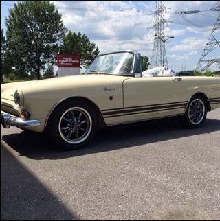

Hoe do you get 15" wheels on a Sunbeam and still make them look small for the front arches and ride height 😮😦😯... Maybe new springs that need to settle... 😳

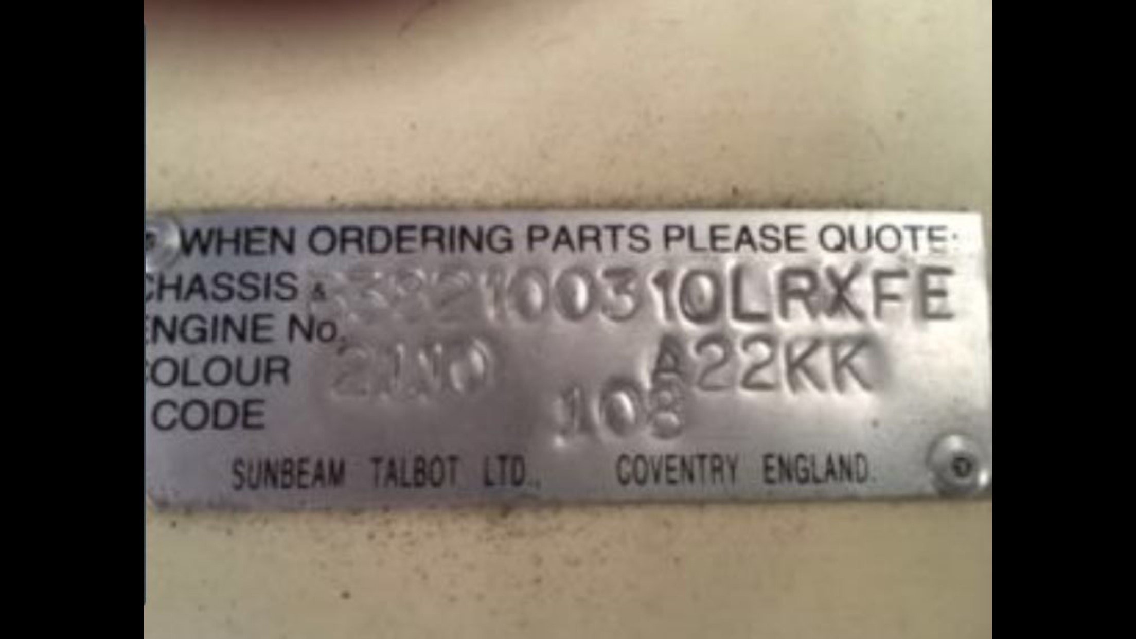

Here's the tag for the above car. It's an obvious reproduction. There should be multiple fonts. The real tell tale is that the zeros in the center of a real vin tag are really a small case letter "O"... that, and the stampings are really bashed into this tag.
Should be noted that lots had the hobby of collecting tag photos. Some restorers also made prettier ones, some machine engraved.
Not to mention the Wooden Nickel story in the BoN car cited their reason for the fake tag was so that the current color would match the car. That same car was later seen on BaT auction.
Seems Rob could have done a better job on the tag. Hard to say if it's a Lettraset rub on static cling letters or the current ink printed ones.

As for 15" LAT they just don't have the deep dish look along with the ride height and filling the wheel well.

Another thing that is wrong... The engine number and the color codes weren't gang stamped like the majority of the chassis number and engine code number. The last one or 2 digits of the chassis number is usually "off line" as it was stamped later. The same with the engine number and color code. These were hand stamped and are often slightly tilted with uneven spacing. The fonts for the engine number and color codes and the last one or two chassis numbers are the same. The primary (majority of) chassis numbers and the engine code number used a second (different) font. Lastly the zeros in the middle of the chassis number are actually lower case letters, and not numbers.

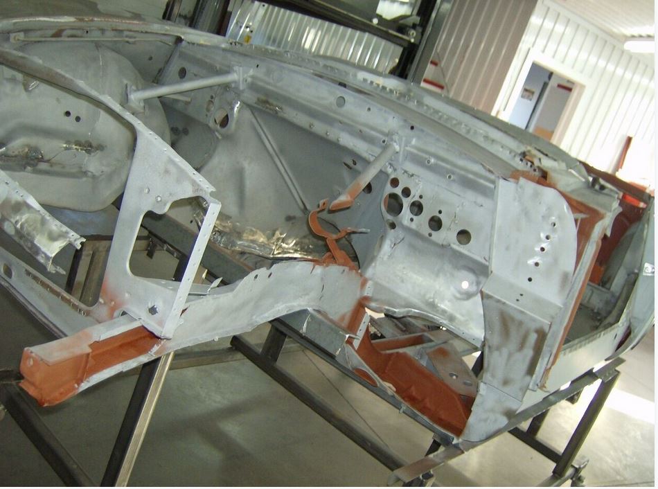

Wow - that was a lot of spot welds to drill out for sure, picture above shows someone was not afraid to tackle a pretty big project so also would assume they probably knew what they were doing my guess

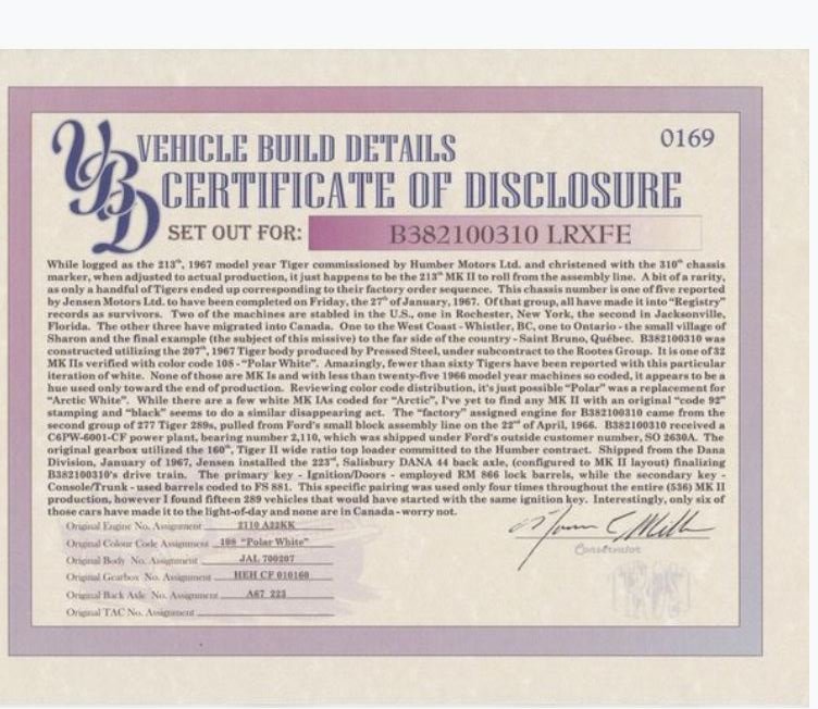

The production numbers given in that certificate make a Ford/Mustang Marti report look pretty scant ! Yeah, wow on that teardown pic!
I'm with Gilles on this the Norm certificate confirms that the drivetrain is the cars lock numbers etc. is worth about as much as the XX lb. paper from Coventry...
But it looks good without a wing and bare in the picture.

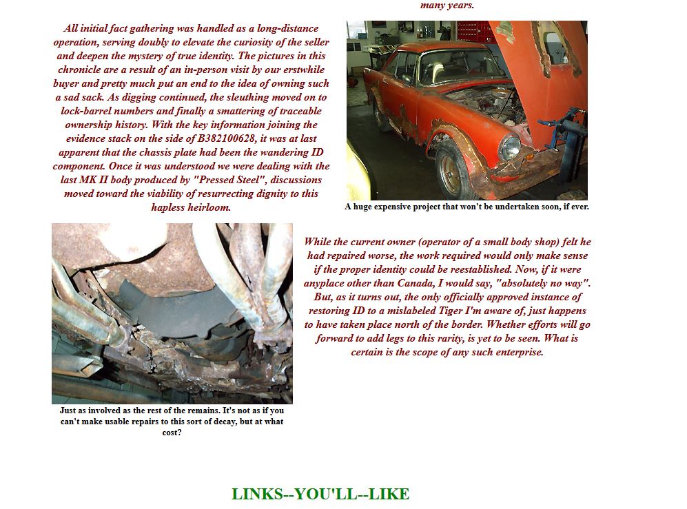

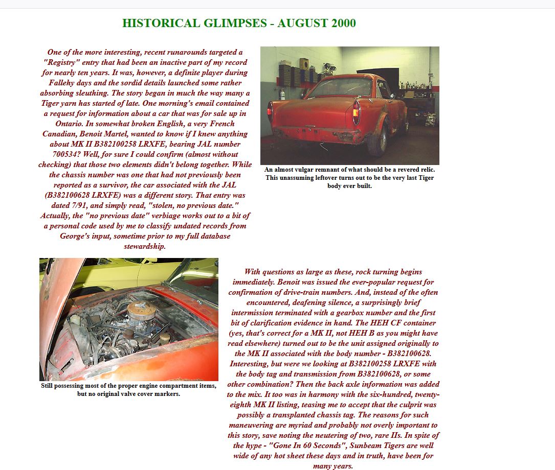

The car was bought in Ontario around year 2000 , yes many body parts were replaced , some frame parts also !!! 310 was the second car that Benoit wanted to buy , Before he went to see car 628 , But origin was questionable ???? So he bought 310. See attached article from Norm Miller about car 628
