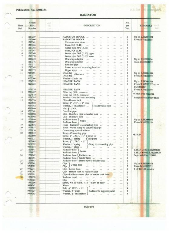

Hi Gilles
I have owned Mark 1's, Mk 1a and Mk2's and am 99.99% sure there was no difference in the fan shroud between them. My brother has had his Mk2 from new so will check next time I see it.
Ron
canbeam
154
Hi Gilles

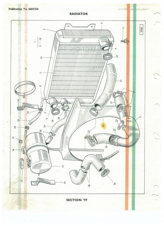

I just looked at my original Rootes Parts Manual which includes both the Mk1 and Mk 2, and it only shows one part number for the fan shroud.
Ron

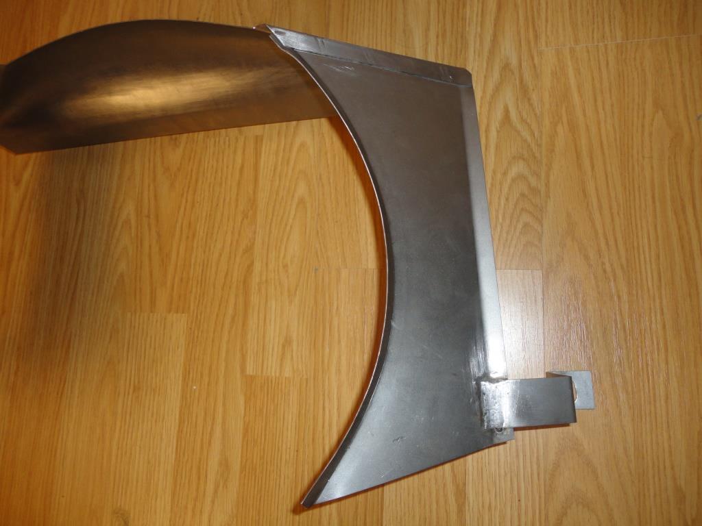

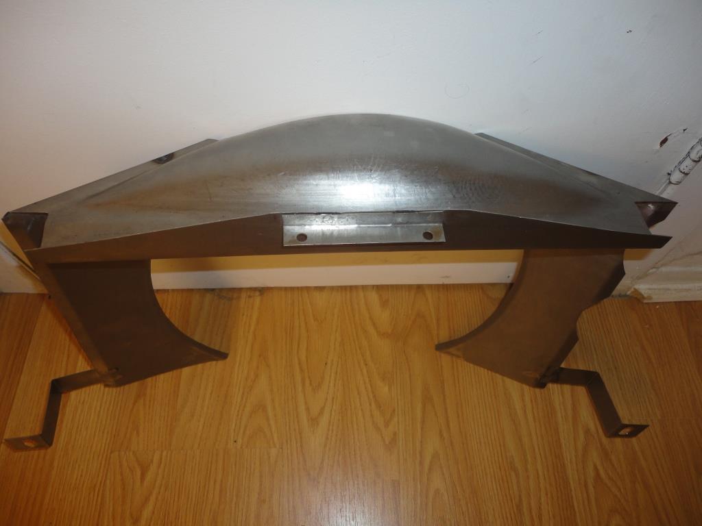

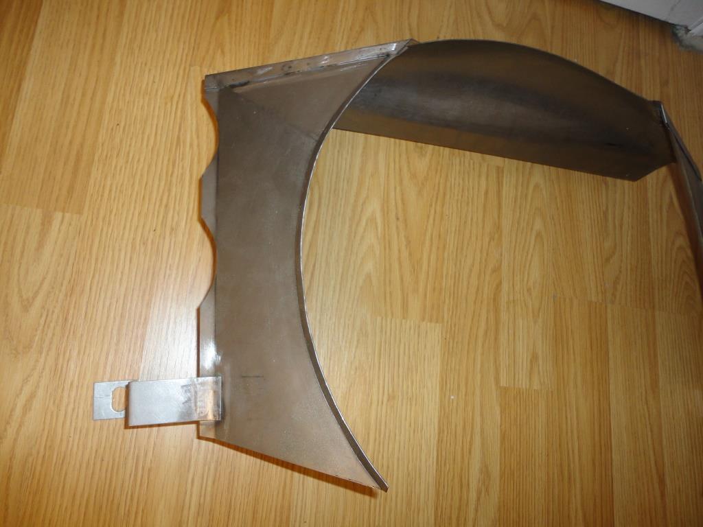

I had one made locally ( Montreal)
Will be made of 3 pieces
Top 1 pieces
Side 2 pieces
Picture to follow !!!

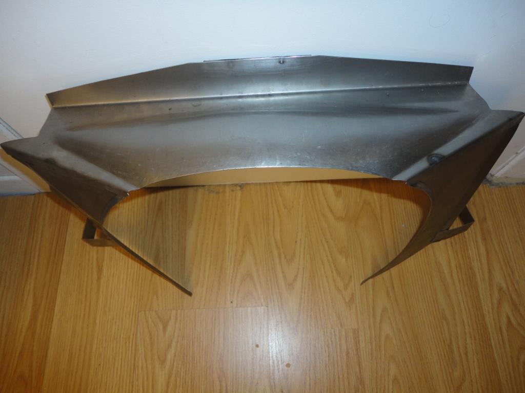

Made of 3 pieces instead of 1
18 Gauge instead of 16 not sure if original was 16 gauge.
I am very happy will be installed on my MKII to replace the fiberglass one .
Gilles

Fan Shroud
Made Locally , by someone who does steel body Patch.
He his very good with the English Wheel !!!!
Gilles

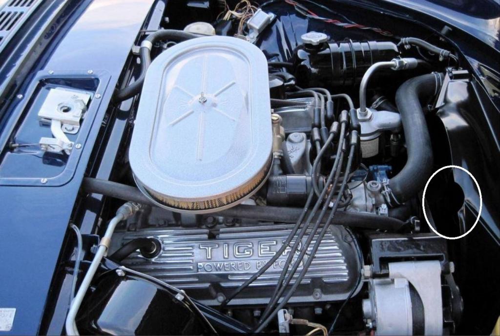

Reasonanle facsimilie
Your fab guy left out a telltale crease along the back of the area that appears like a balloon tire bike fender. The crease is in aprox. 1/2'' along the motor side of the curvy part. In all fairness the U.K. ones I have seen also have the same missing element.

fan
I think i understand what you have written
See attached picture of another car
Thanks
Gilles

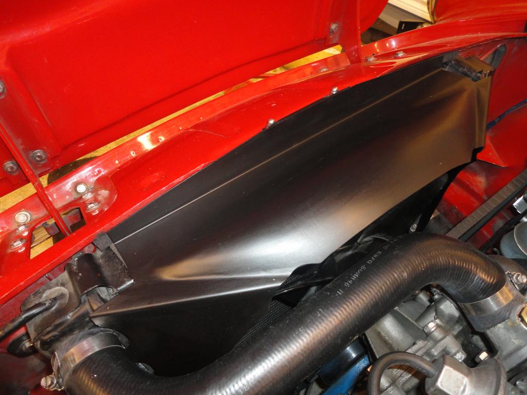

Fan Shroud
Shroud installed , better then the fiberglass one I had on the car since 1998
The fiberglas one will be for sale later on
Gilles

One member are asking us to make another one .
We are not making that Shroud , We will need to take a shroud out of the car and have one made , so we will ask the thin bender to make anther one .
Look at the picture on the tread . If interested send me a note !!!
18 gauge instead of 16.
Missing also the 2 half hole on top of the shroud !!
Let' s me know if you are still interested !!!!
