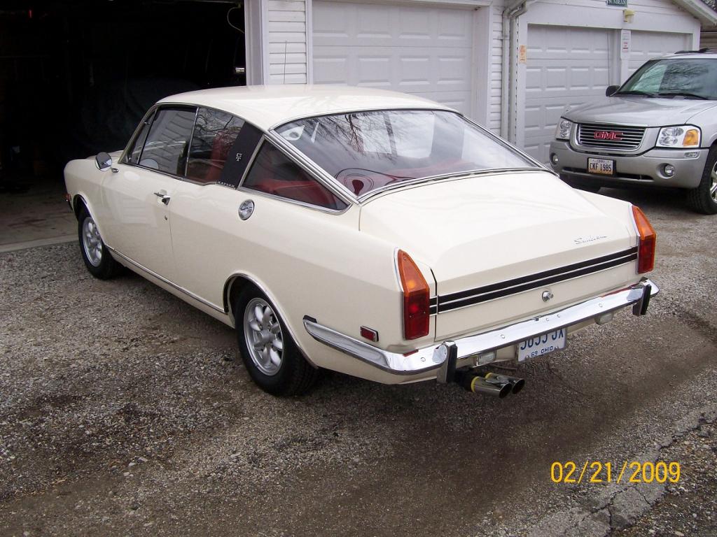

The fastback Alpine GT built after the end of production of the series Alpines and Tigers had trim that used corner pieces secured by a screw. These corner pieces are visible in this photo of my car. Could they have adapted this trim since the other four pieces are straight with no curved ends?
Screwed
Thanks for the reply. The corner pieces have no screw holes and neither do the straight pieces. It was made of several pieces maybe to make the bends. The P.O. did or had it done in approx. 1980 so guess the trim has been N.L.A. for a long time. With the right length trimmed down and careful work it may be a reasonable facsimile. Too bad can't get the rear screen without the slot for the trim.
