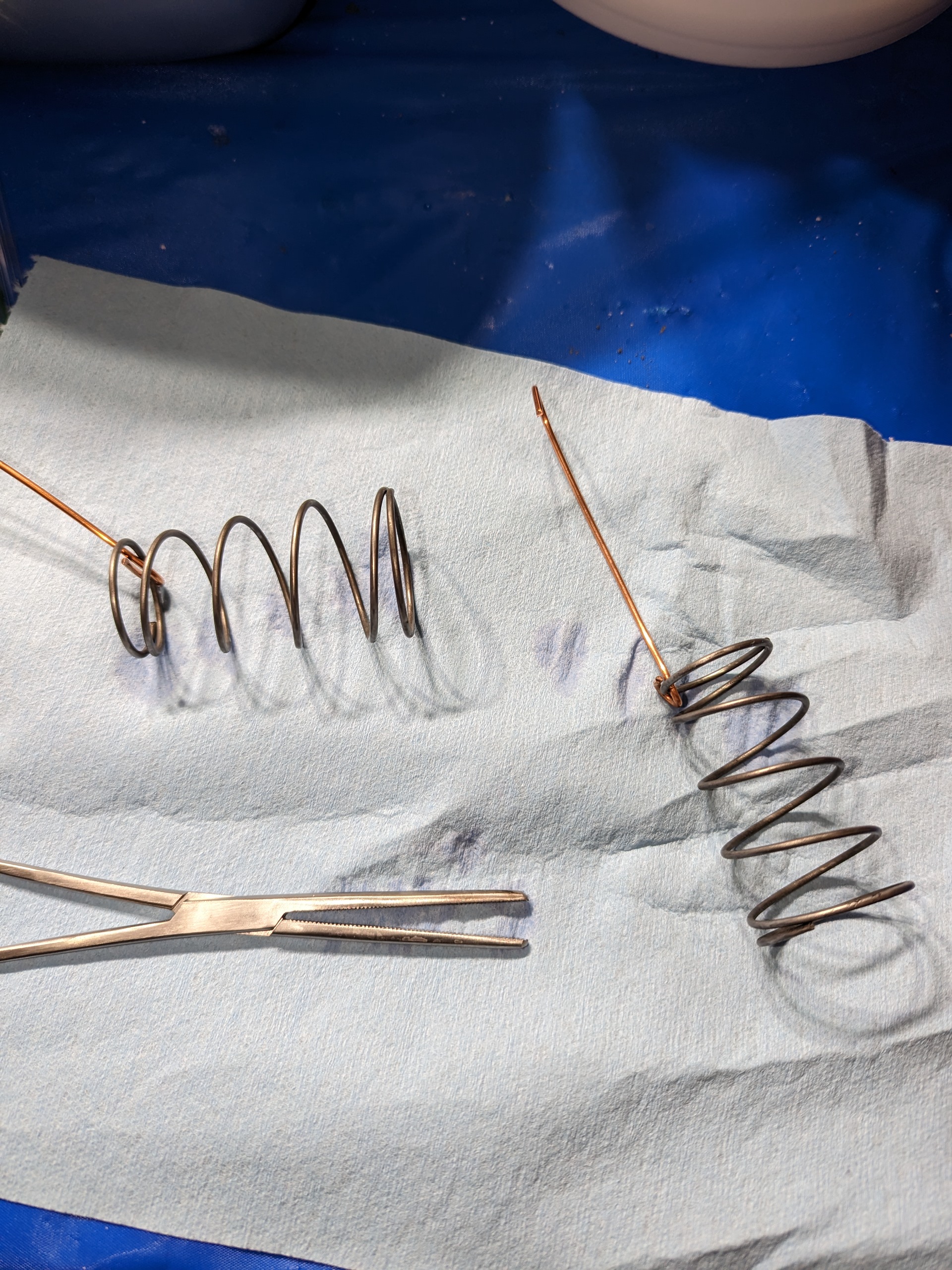

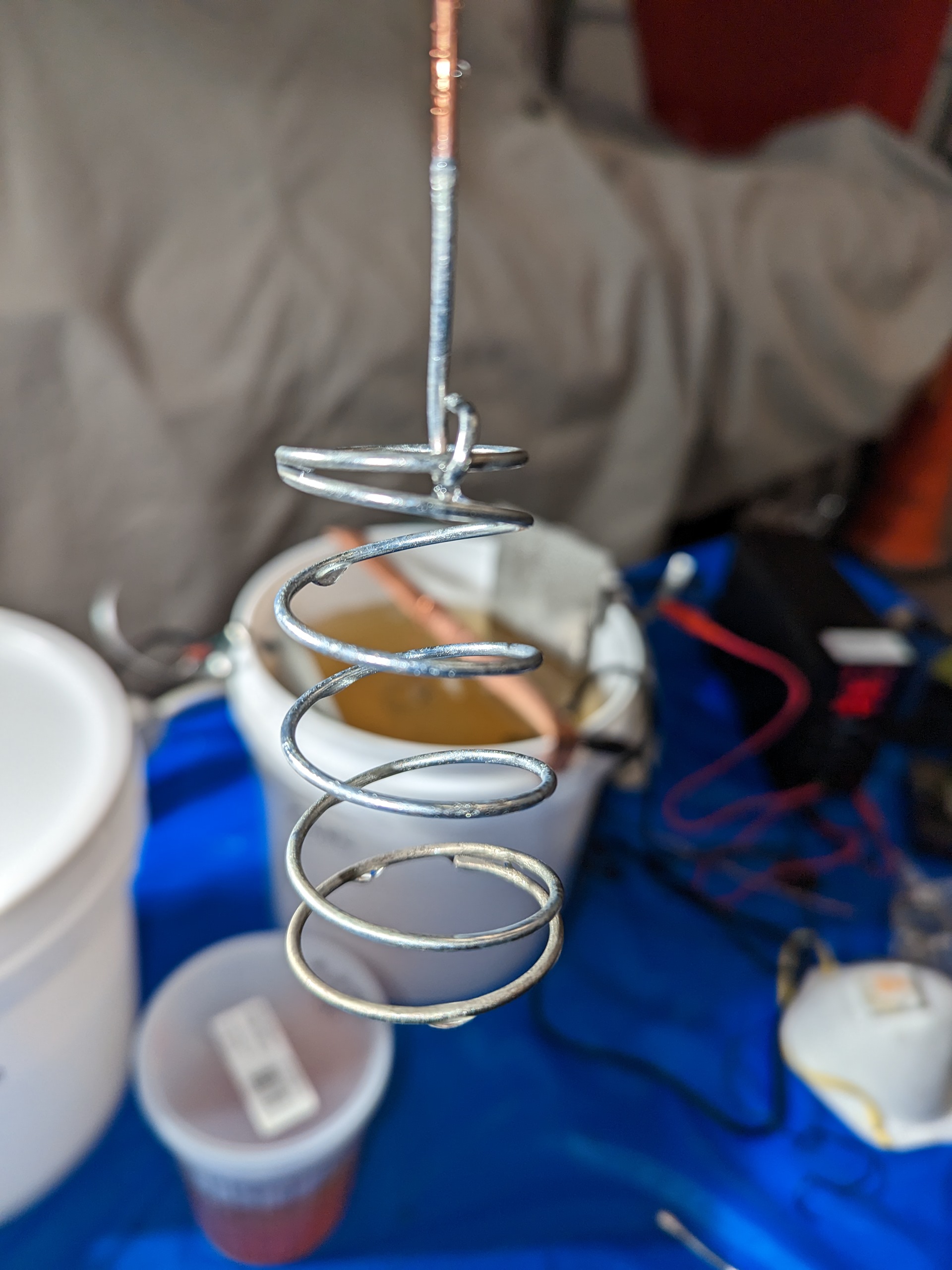

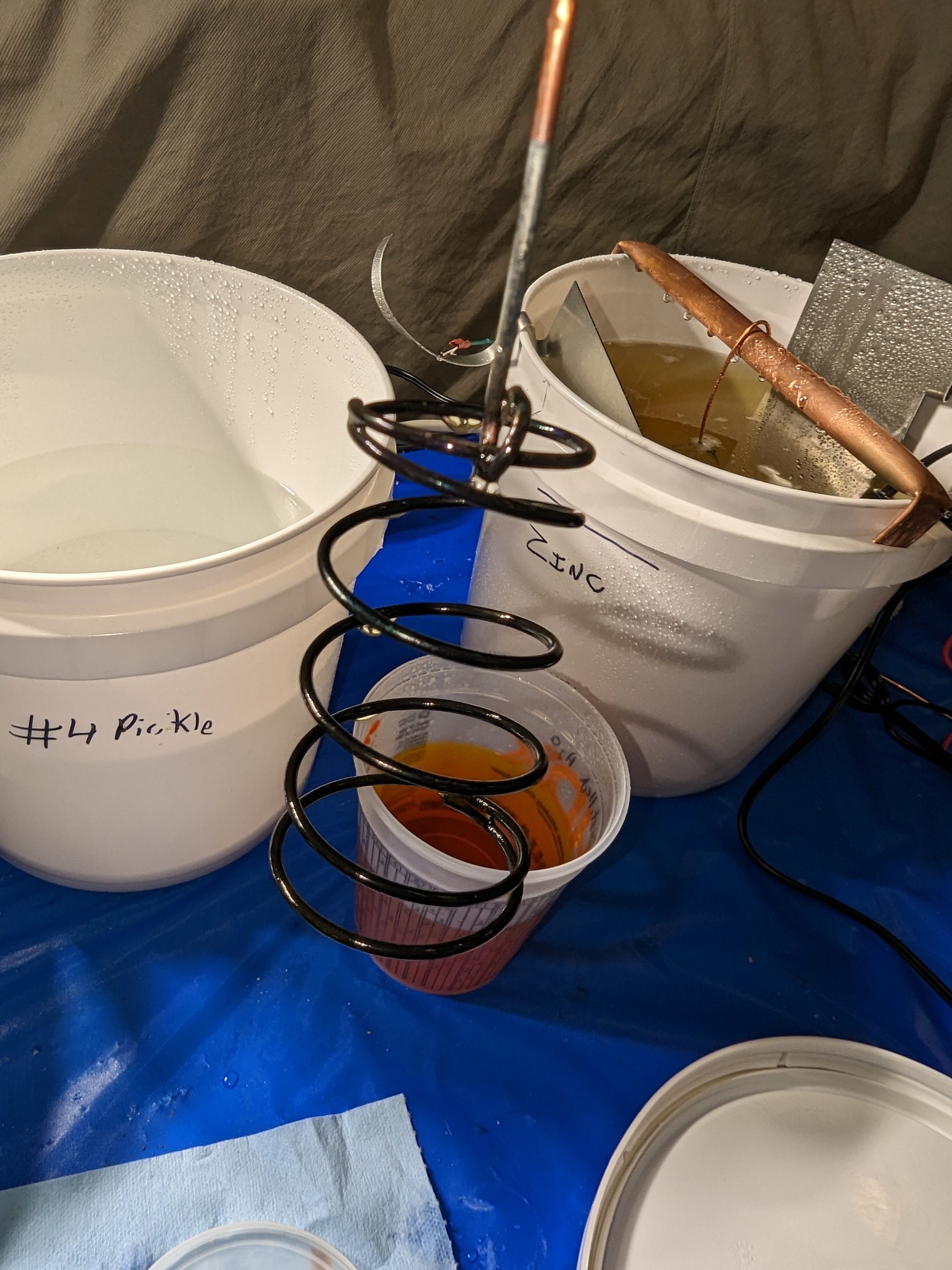

I keep my fasteners looking stock through zinc and black chromate application. If I'm going for a Cadmium look, I can fake that with the zinc minus brightener. Pictures of my clutch pedal return spring. I was doing black oxide but that'll corrode eventually.
