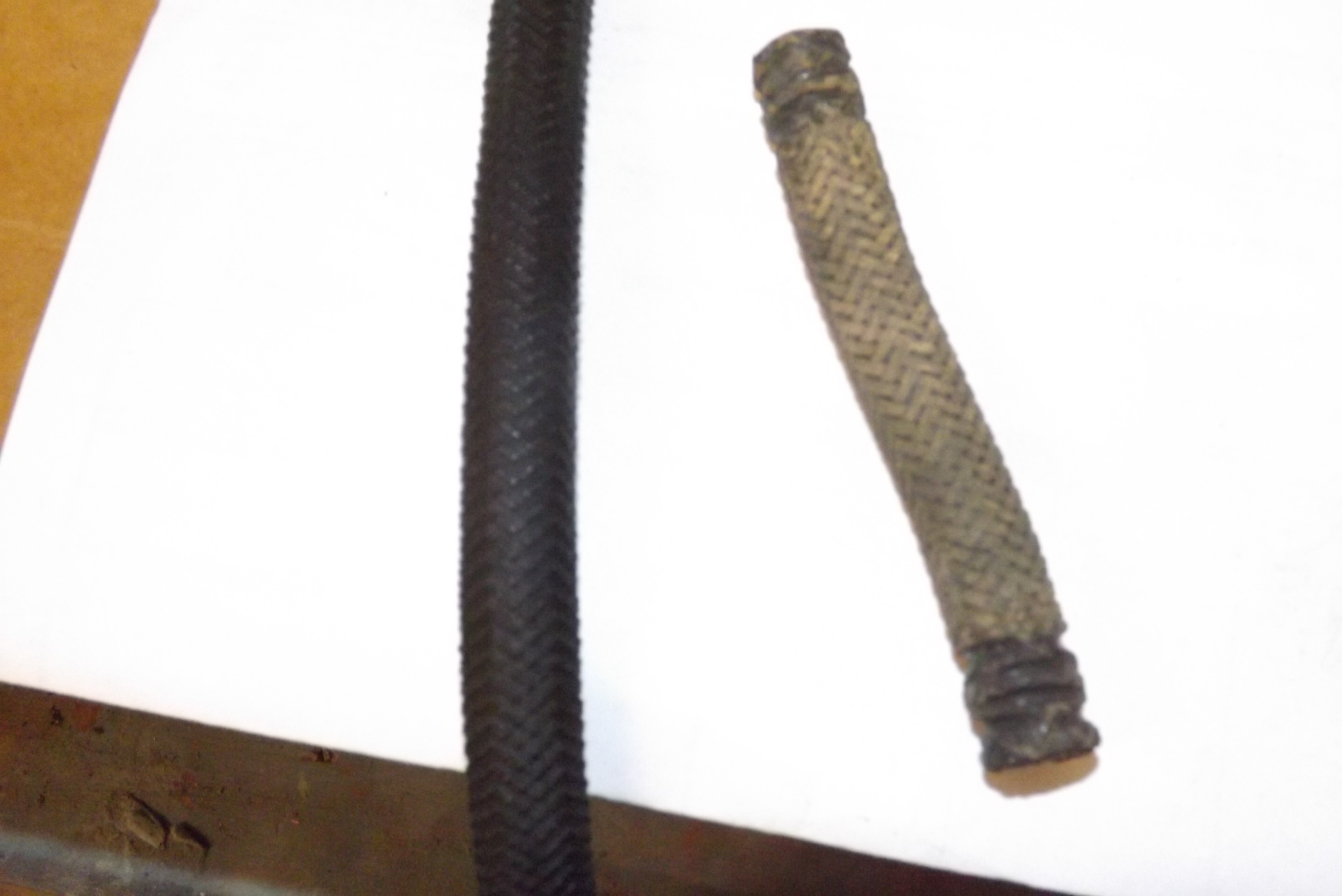

it's Burtonbikebits.net It's sold as "herringbone oil pipe". 5/16" id is PS161 (specify length) and 1/2" id is PS189 (specify length) if you type herringbone oil pipe into their search bar it'll come up with the page.. I found it with a Google search... this is the fuel line. the second image is a piece of original fuel line next to the new stuff.

I have bought that from Burton in the past, for one of my bikes. Expensive, but if you really must have it...........................
