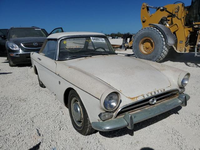

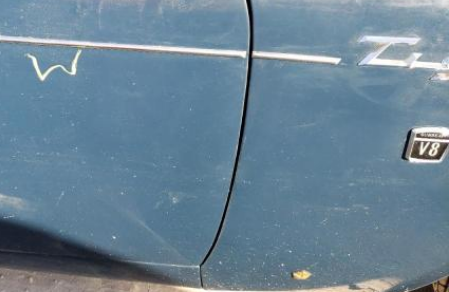

Anyone know these cars. Don't know if this is one of those times when an insurance company used Copart to establish a buy back value for the insured.
The grey car looks like it was neglected prior to the high waters. Our member Brian W. was suggesting cars to me. Although I have experience with flooded cars and think the cars are easily brought back, but not by me. Possibly someone who's a Copart member can publish the VIN numbers.

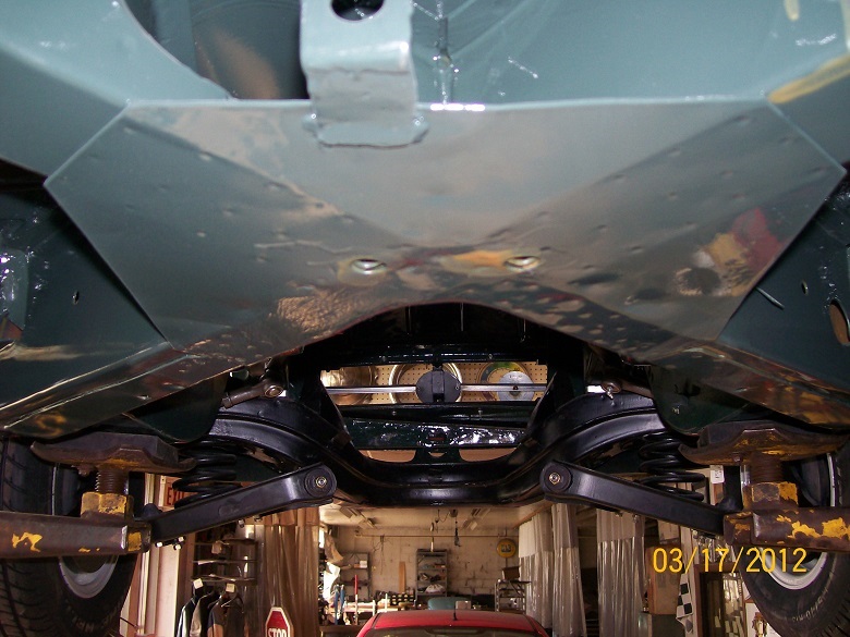

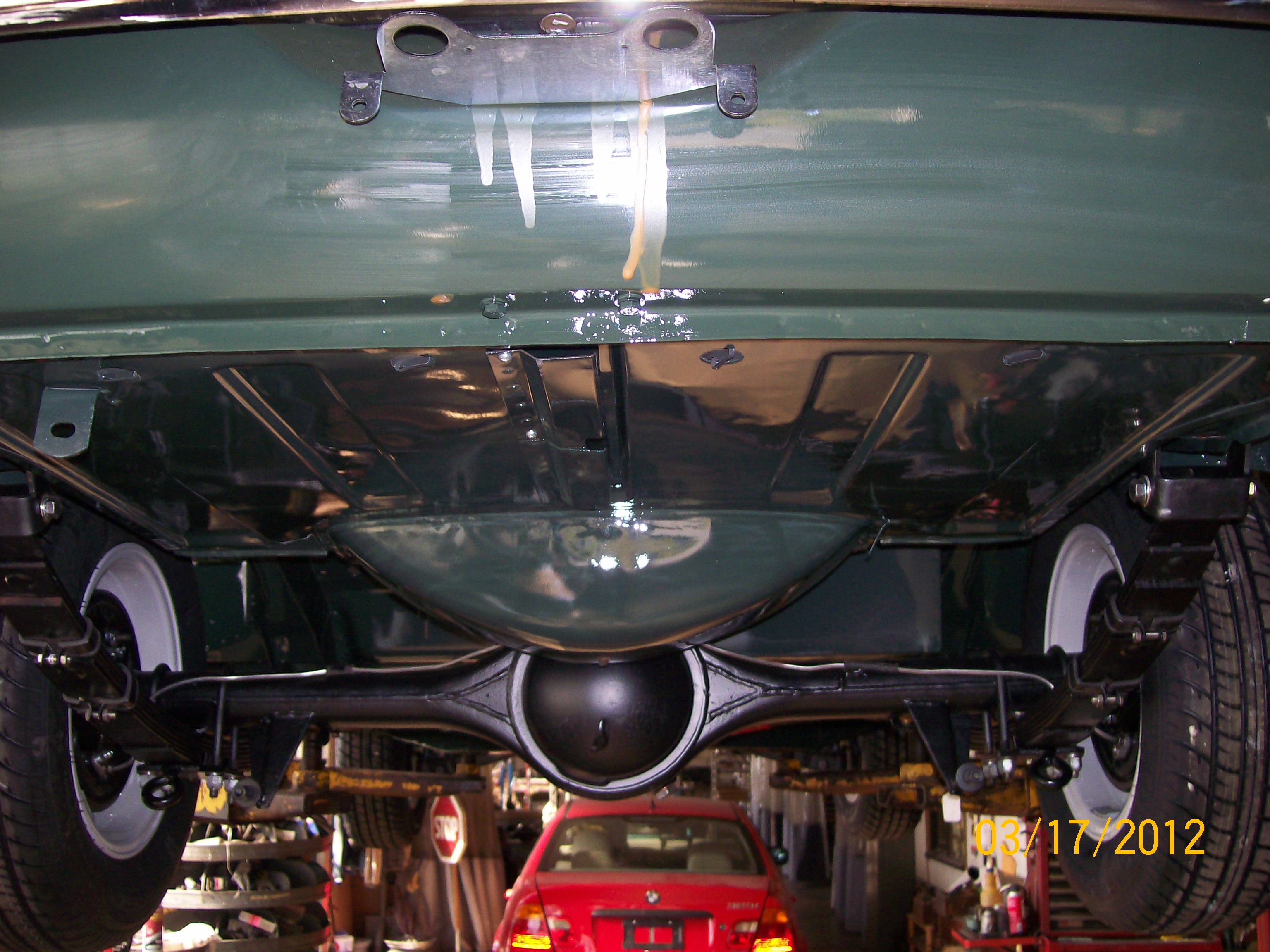

Flood waters can be a problem with an unrestored car such as the ones at Copart. This photo shows the residue on one of my cars that Doug restored that had to be cleaned off after paint and being treated. This is from the inside of body panels and the X frame having been treated. The body was originally dipped and epoxy coated prior to body work and paint. I think he used a 3M product on this car. We're not rookies to cars setting thru a flood so we carry a stated insurance value that would cover flood repairs or anything short of being run over by a D11 dozer.
