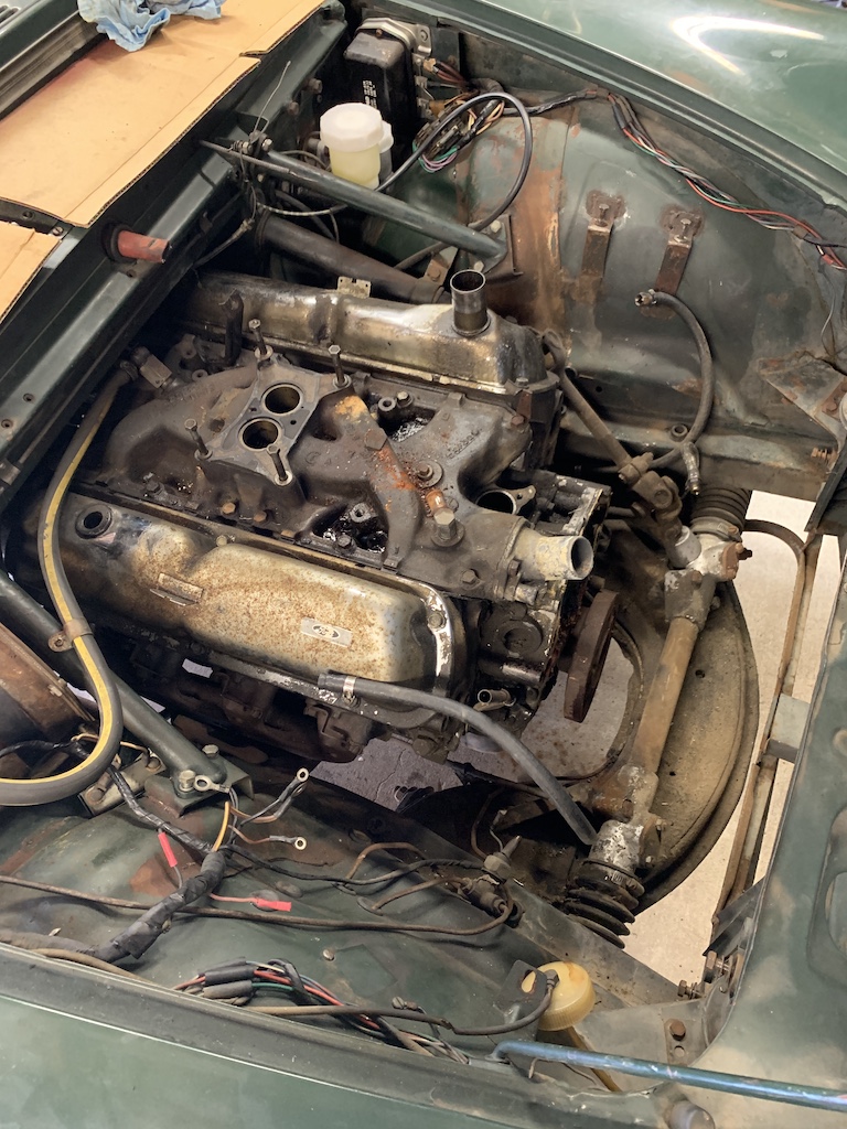

Well, it looks like the engine is going to have to come out! :(. I've soaked the cylinders for a few weeks with SeaFoam, Mystery Oil, etc. I've heard diesel might work if I just fill the crankcase and top end. A long bar isn't budging the crank, just felt like crank bolt tightened up a hair, and don't want to risk more damage, or snapping bolt. So, psyching myself up to get it out and tear it down, deciding about the out the top or bottom routine. Hopefully the main parts are good enough to reuse, valve job, hone and rings, and bearings will do. I'm going to try to resist overbuilding a slug 260, just get it back to running reliably. But who knows what it looks like inside. I've rebuilt several SBF's, so familiar ground. Maybe in a few years after driving a 2 barrel stocker I'll decide to build a different motor, paint, etc., we'll see.

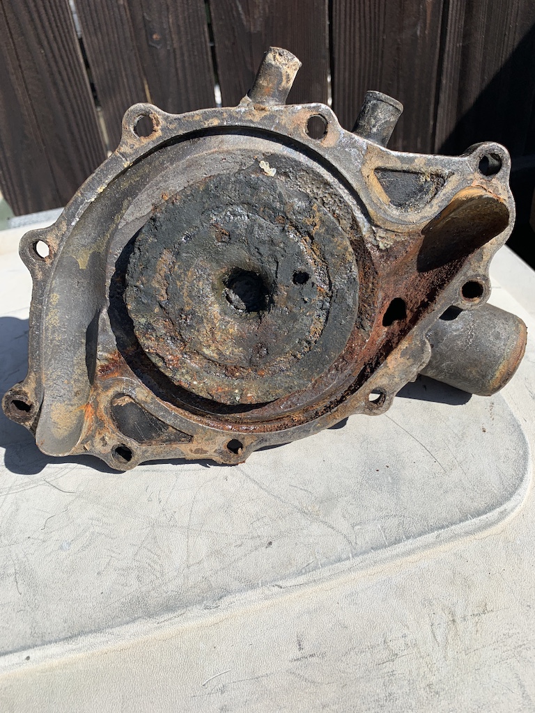

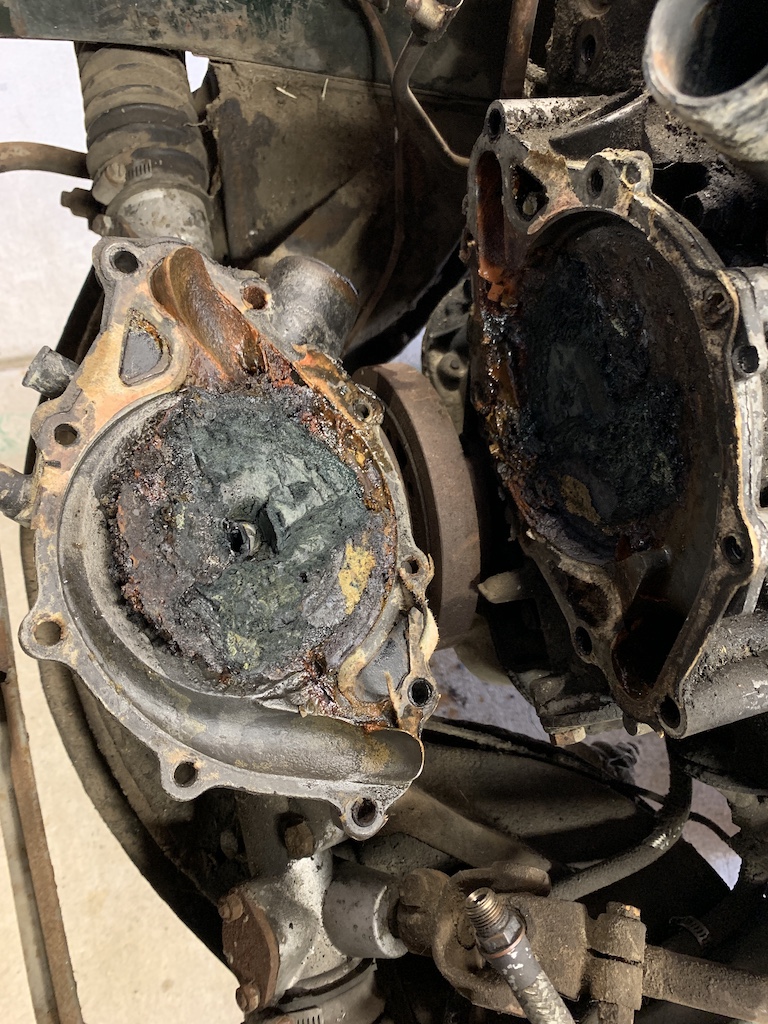

If the water pump looks this bad, pretty sure the block is similar, and block should be boiled out anyway to avoid future cooling problems. Oil seals are probably shot, especially that rear rope seal.
It looks like the original 64 water pump, hopefully I can get it rebuilt.

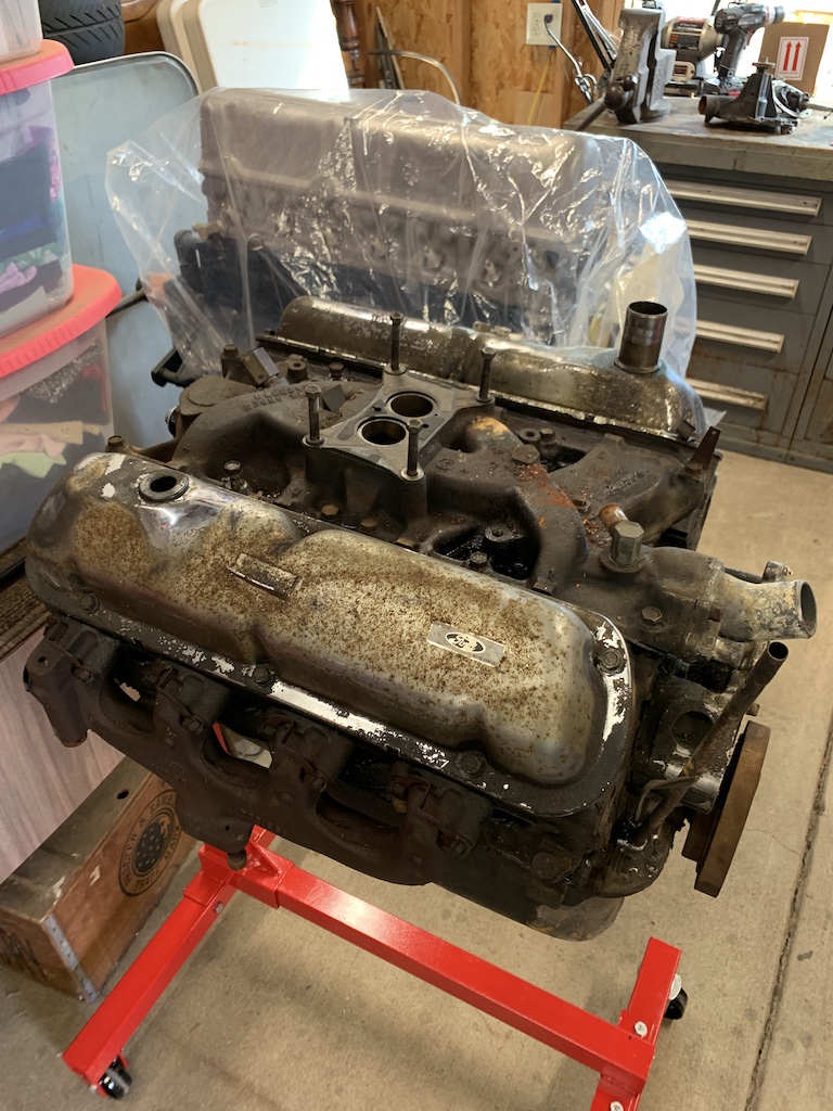

Engine Out

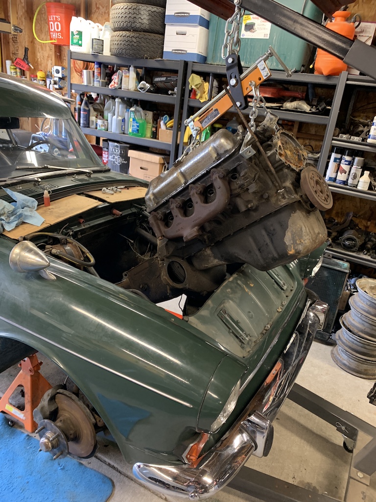

Today I pulled the engine out the top. Came close to hitting the front body panel, but didn't. Using cheap Harbor Freight stuff does give me the willies sometimes. I did get the engine to turn over from the crank bolt, but decided to pull it anyway. Clutch looked pretty worn too. The original HEH-E trans still there, I'll pull the cover and check the forks and sliders, can't imagine this slug motor hurting this brute Toploader.
The water pump had some corrosion in the housing where I think should be just a 1/4" hole. I asked DeadNutsOn and he said it was not repairable in his opinion. So, found one on ePay, same number and dates, and rebuilt with HiPo impeller.
Tomorrow the teardown begins and probably take the heads to a shop. I'm hoping I can get by with a valve job, honing cylinders, rings, bearings, and timing chain, but who knows what lurks inside this thing.

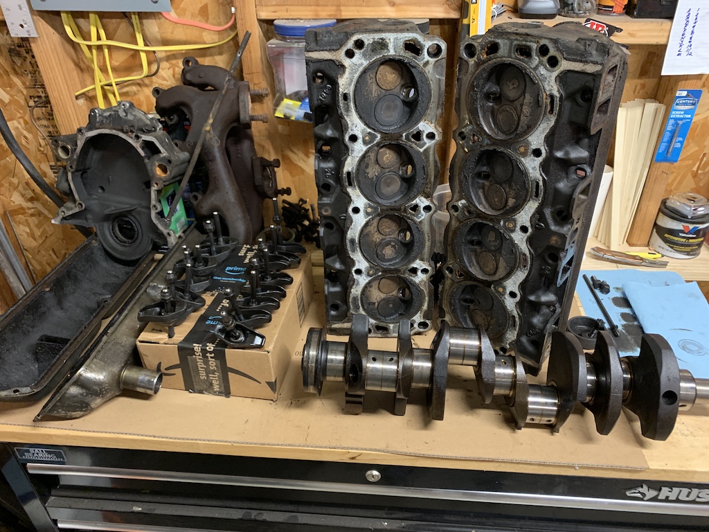

KenF
396

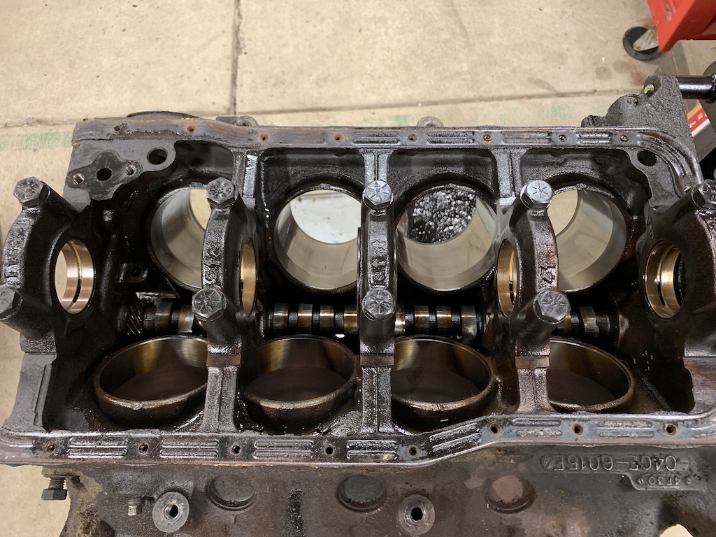

Engine looked pretty good on the inside. Bores looked good, slight ridge, I'll get them measured today. Pistons should be fine. Bearings okay, no scores, and crank might need just a polish. Not much sludge in the pan either. Water jackets are full of crud, probably end up boiling, freeze plugs, cam bearings, etc.
Head and valves look okay. We'll see how the valve guides are. Dropping it off at the machine shop later, hopefully minimal work needed.

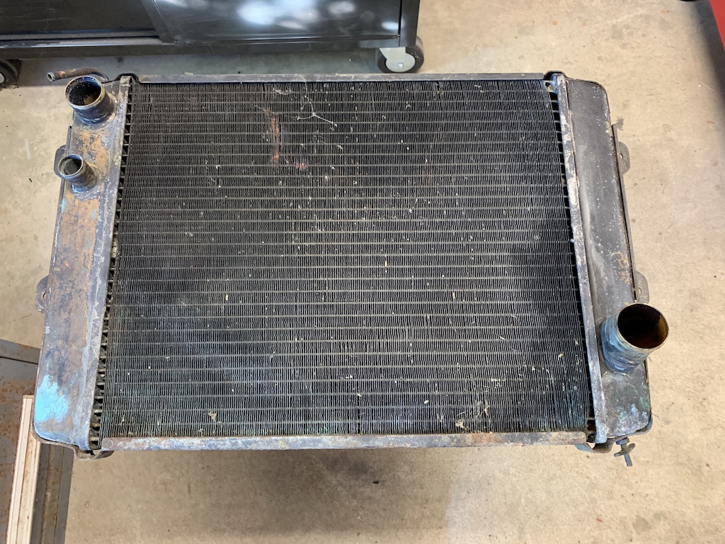

In that "leave it stock" spirit...Is this an original radiator? Pretty heavy, 3 core, about 2" thick. Looks in decent shape, wanting to use it, hopefully by rodding it out.
Going to take this and the heater core to radiator shop that are now cleaning out my fuel tanks, while the engine is in the machine shop.
Looks stock
Be sure to check your fan shroud fitment. My project has some funky 3 row core radiator with stock looking tanks, but when I tried to fit the fan shroud, there were issues. That part is still down the road for me so I haven't addressed it yet, so I can't elaborate more. I'd hate to see you spend's some bucks on a radiator that might not fit right.
