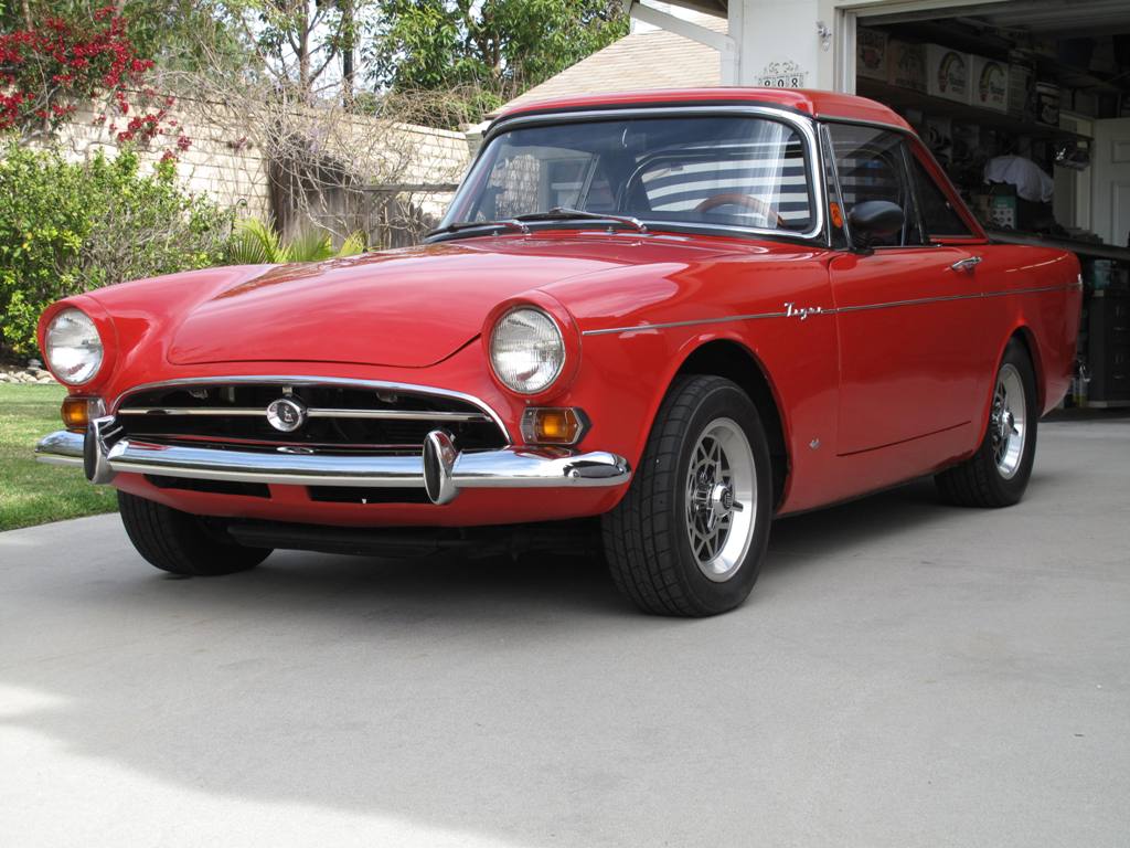

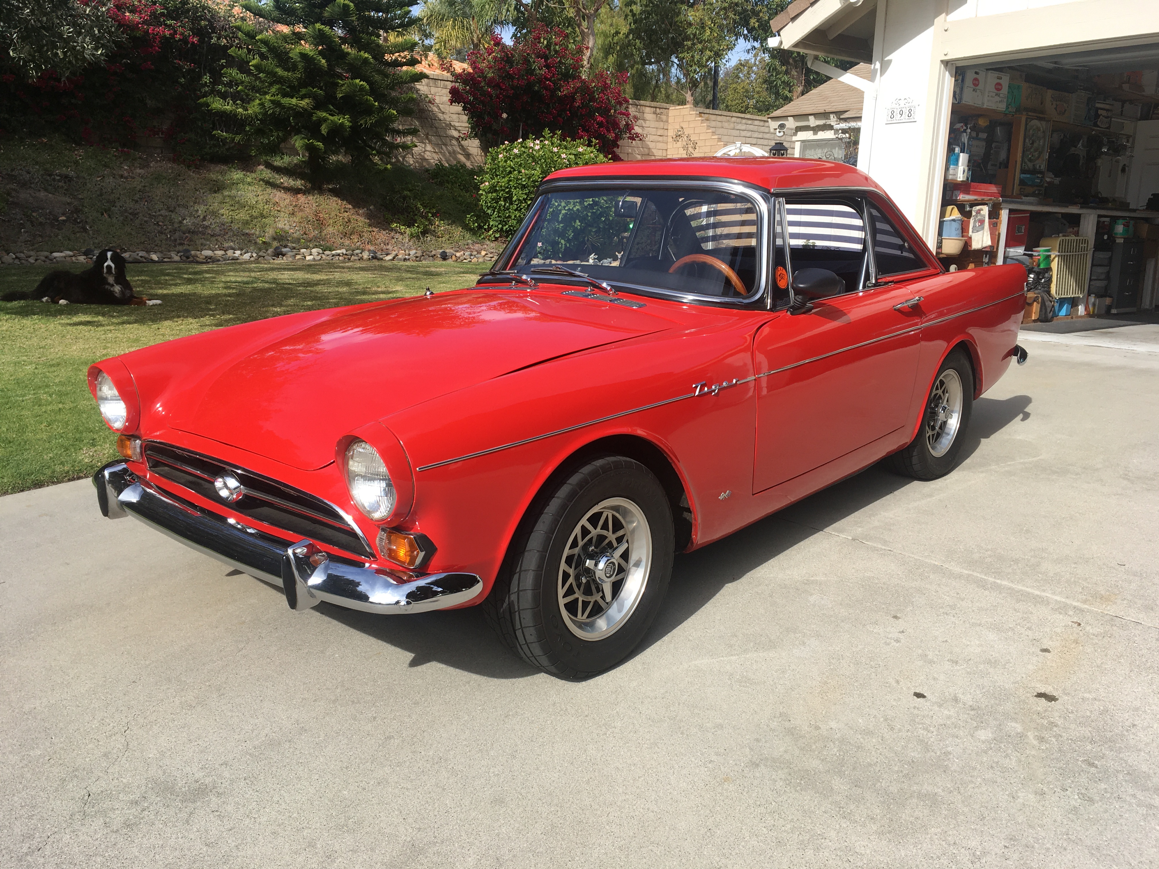

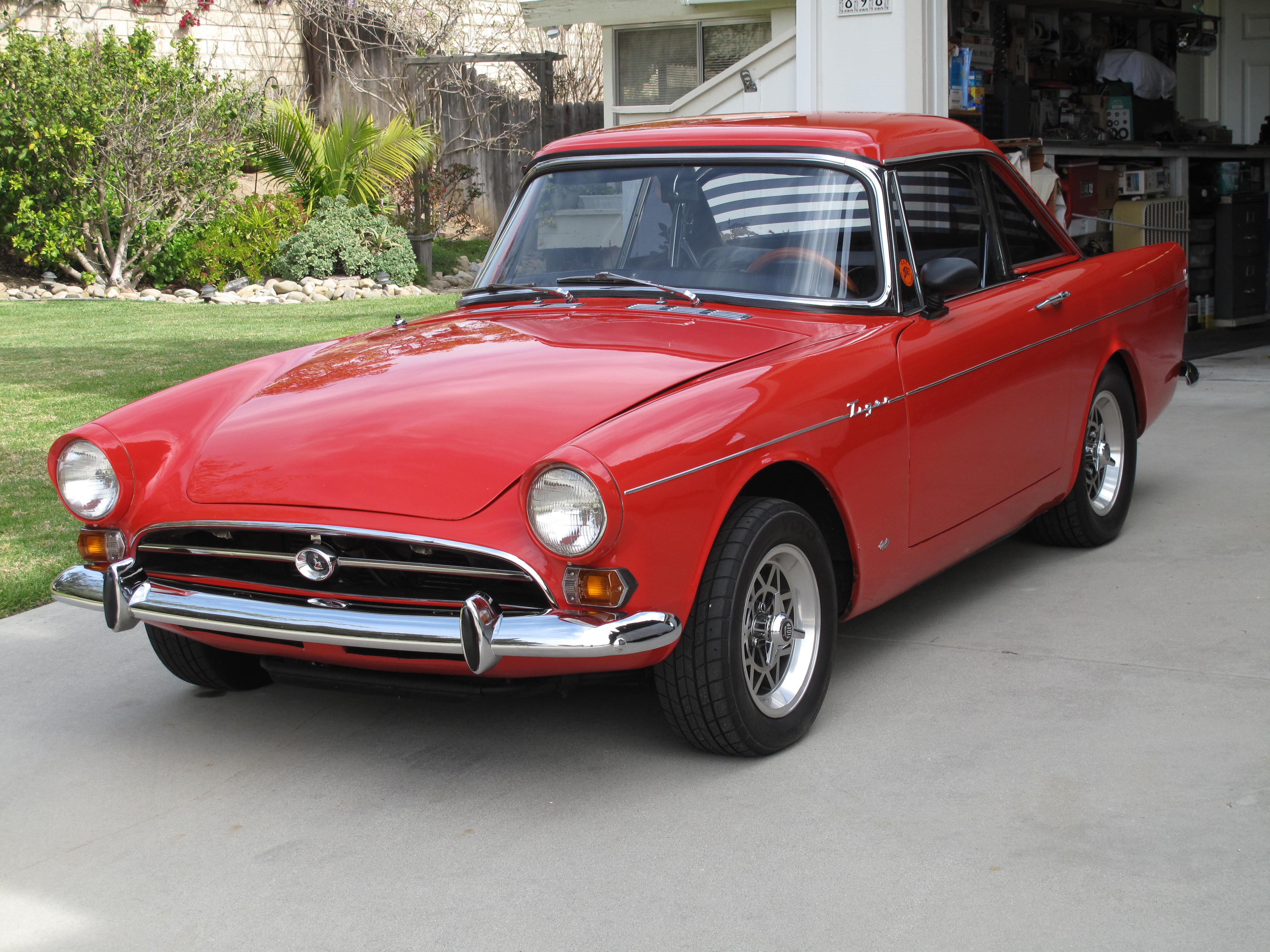

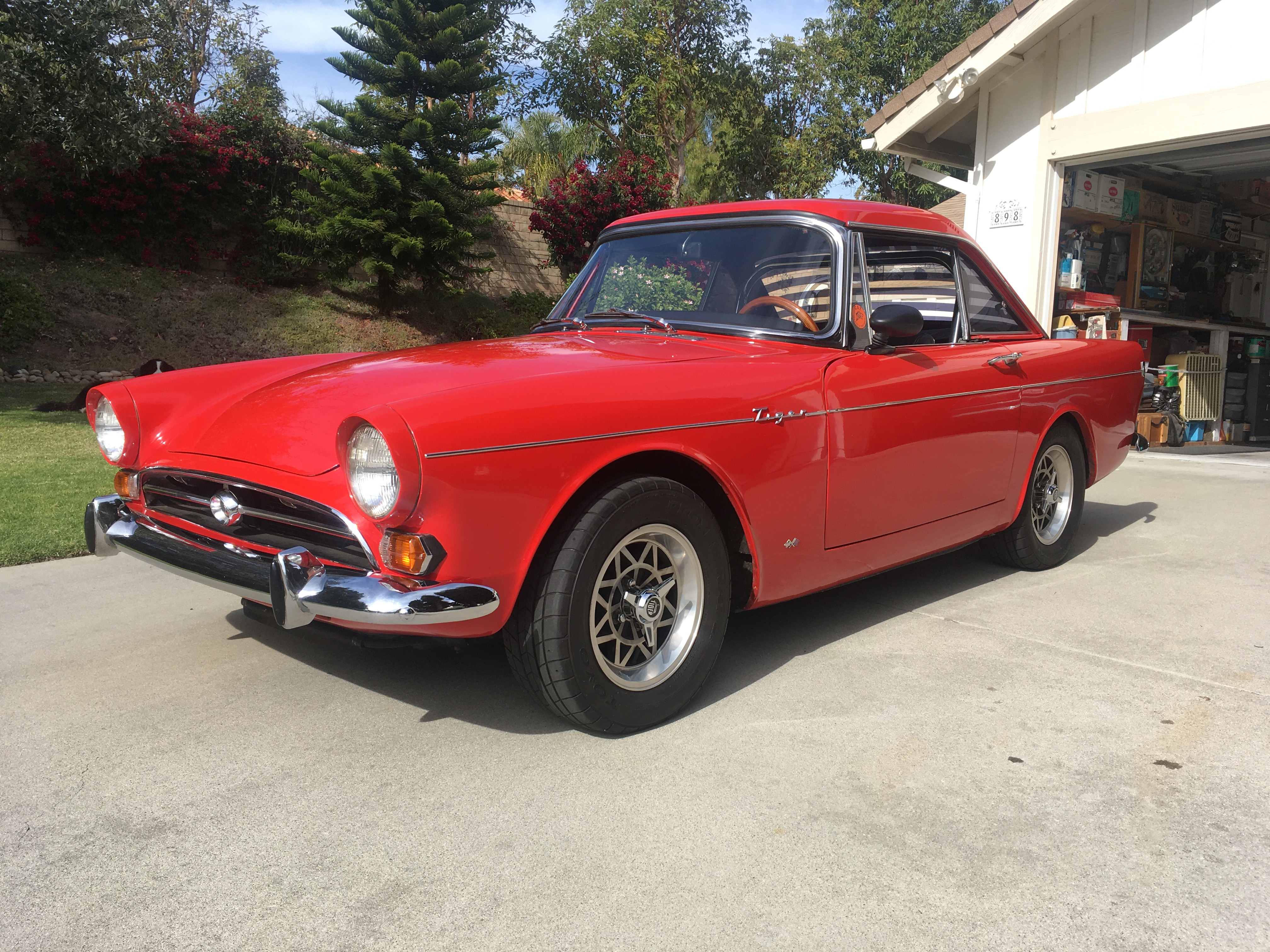

50 years ago, I had Konis on my first Tiger. My current Tiger has had KYB's for 35 years. I thought the KYB's were doing a good job, but I remember how much I liked Konis, so I bit the bullet and got a set from Rick and installed them yesterday. Wow! What a difference! I know you can't compare 35 year old gas shocks with brand new Konis, but now I remember why I liked the Konis so much the first time around. Smoothed out the bumps, but more than that, no more body lean on cornering. An added bonus, the Konis (front) were about an inch shorter than the KYB's on full extension. Lowered my ride height in the front by an inch!

Before and after pics:

Pics 1 & 3 are before the Konis; pics 2 & 4 are after installing Konis. Had been considering cutting the spring isolators, possibly cutting a coil off the springs...got the same result with new shocks!

Can you explain why the shock absorbers changed the ride height?
I am am having a difficult time understanding how the shock absorbers affect ride height when the spring is fixed between the upper upper fixed body and the lower A arm.
Maybe you pervious shocks were gas charged and offered some spring affect?

I was talking to Rick at SS and he offered an explanation similar to yours. Rick sells both brands of shocks so I was wondering if he had heard of this happening before. If you think about it, the fact that the KYB's were an inch longer makes it impossible for the KONIS to rebound as far as the KYB'S. Another observation, the shock body and rod thickness of the KONIS are heftier than the KYB'S. You are correct about the fixed distance of the spring, but if the spring does not extend the last inch of travel due to the shorter KONIS then you have a lower ride height. The KONIS are made for the Tiger, so I can't be the only one to have experienced this...or, maybe I am. I'm not complaining, and neither are the KONIS. They are not clunking or making any funny noises on rebound after hitting all sorts of bumps. Still waiting for the experts to chime in.
What experts :)
Is there a part number on the Koni boxes?
I don't think that the Konis are made for the Tiger but several car models. Just cause it fits doesn't mean it's the same fixed length as what was stock, that would be a good measurement to find.
