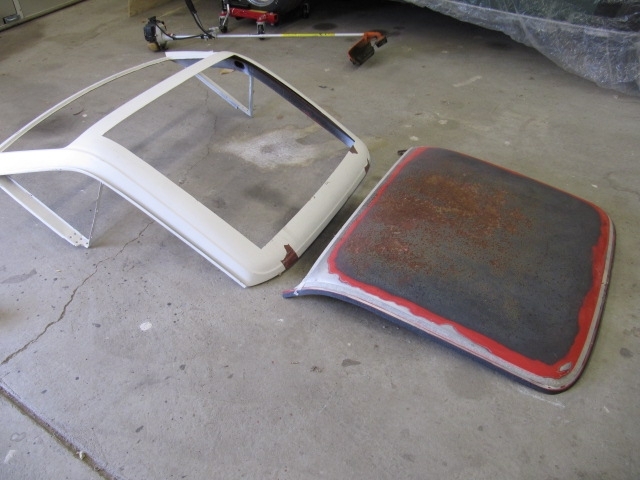

I'd like a top that has a bastard 80s sun roof in it for a project No I don't want to cut off the bottom
Kinda what I bought some years back can't remember what I pd I think $125?? but less than $200 for sure. Have roof on now and in primer all the parts and hardware just needs paint and assembly. Bought on ebay maybe seller is on here and can remind me. I don't think shipping was offered so I was the only bidder
I was sent a picture of an AF car with a Webasto roof. That's the ticket for a rag top guy like me. Had a rag roof since 1977.

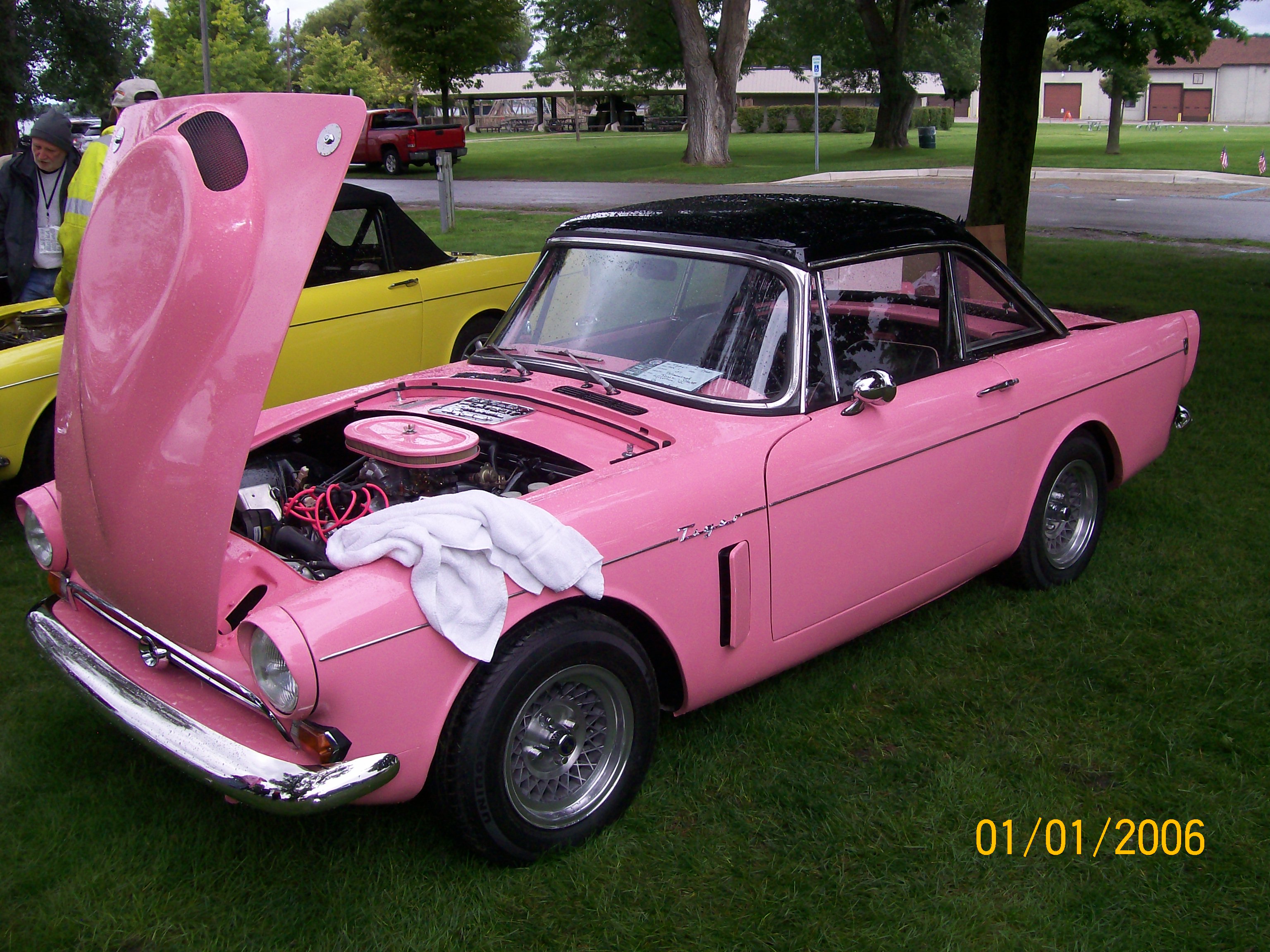

John retained the black top when he painted his car a different color.
Too bad can't get the ledger page holders to respond. My survey of one car is not too convincing, plus about 10 or 12 pages in my collection. I've found black under all that I have taken apart. White is very UK proper high visibility and much cooler than black especially with the useless jute stock padding.
