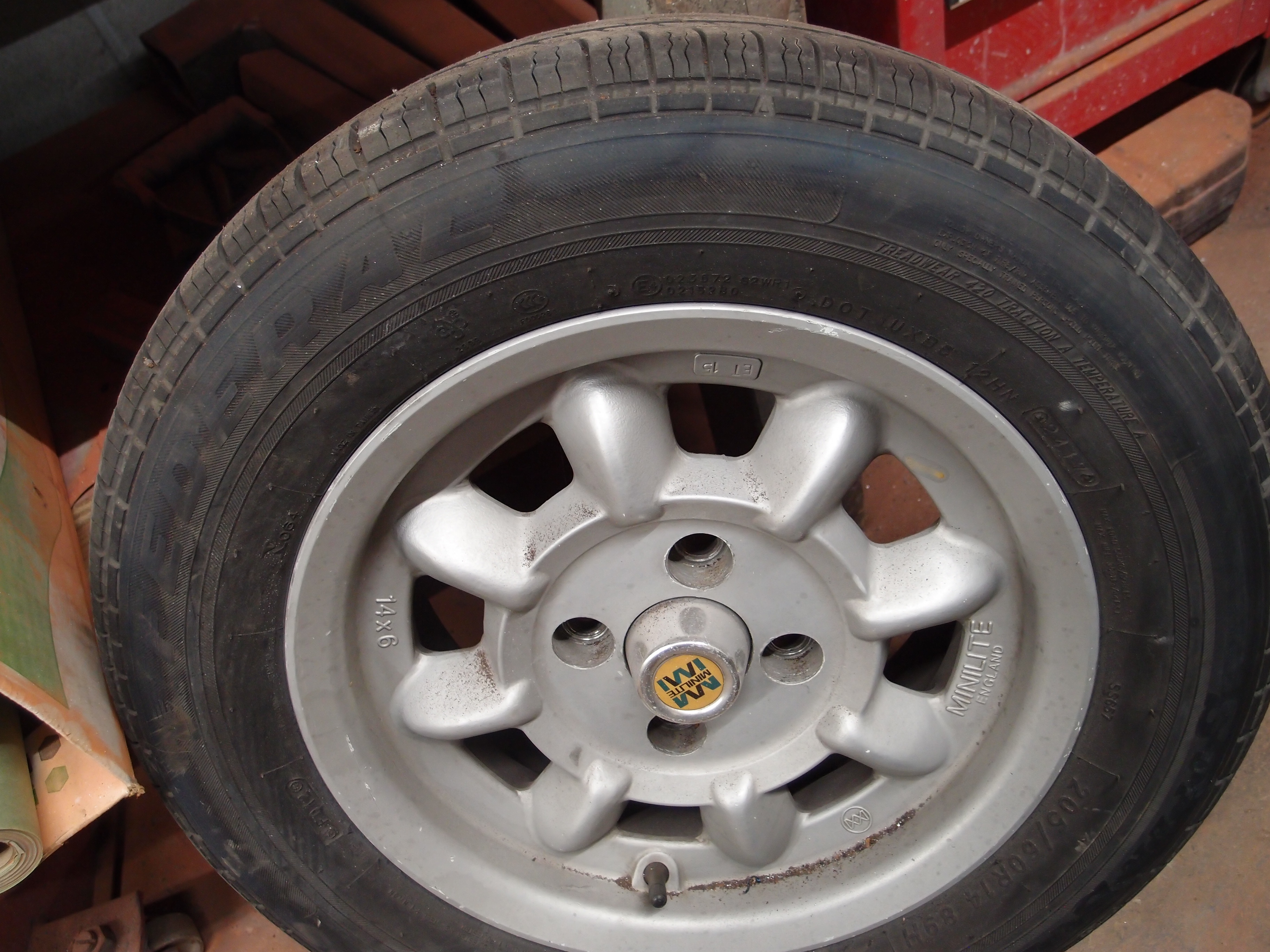

I have a set of genuine 90's vintage Minilites wheels fitted to my Mk2. These wheels use a sleeve type lug nut which does NOT have a taper at the end of the nut. The diameter of the shank is .735", length is .750. Thread is obviously 7/16-20. The socket size for the lug nut is 7/8AF. MiniliteUK is unable to supply lug nuts. The US distributor is just worthless. I have not been able to find any lug nuts anywhere in the US of A and I would like to be able to drive my car sometime in the future! Anybody out there have a source... I only need 8, but would buy 16 if I have to!

I had a set of Minilites that had the same issue, needed a sleeve style lugnut. Used a washer that fit over the lug and washer sized to the counterbore on the Minilite. Made the mistake of putting them on the Tiger with different lug nuts made it about 2 miles and noticed the wheel shake. Lost 2 lugs and almost the wheel! The sized washer worked.
