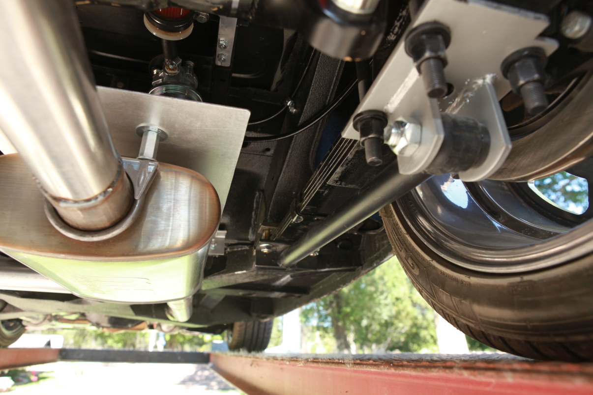

Here's some pics of heat shields between gas line and exhaust and muffler and fuel pump on MK1.
