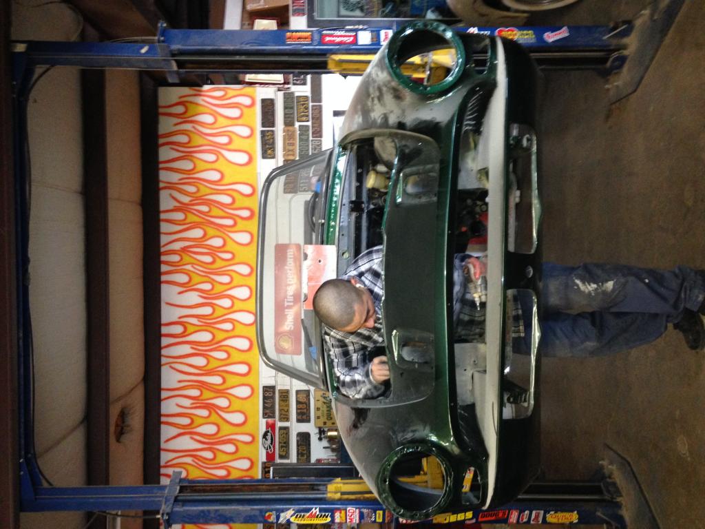

I've been down with a bad back for a few weeks now but, my guys are making progress. Mostly in primer now. Doing the valance now and then the windshield will come off and prepped before final paint. Gaps all look good. (the hood is just sitting on it now). Also a pic of the dash and the shifter. The shop that the PO used did a nice job(IMHO) of extending the trans tunnel for the T5. Gonna need some extra carpet for that.

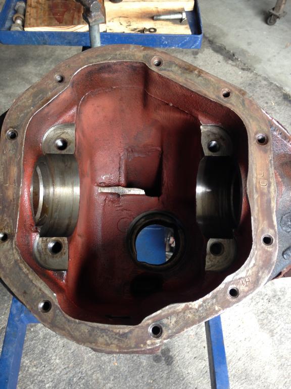

Now for the differential

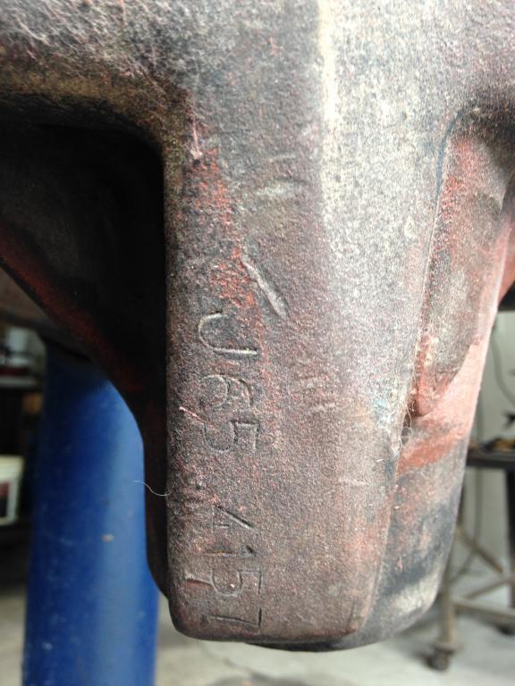

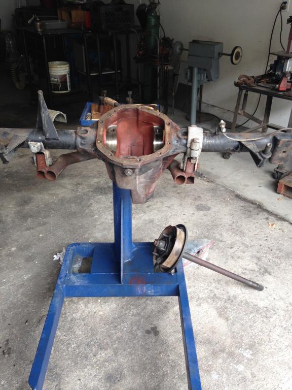

Going to re-fit the rear with a posi unit. Here are some pics of the rear end all cleaned up. Orange coating inside. Red oxide outside (what's left of it). Found those numbers too! I don't think it has ever been serviced.

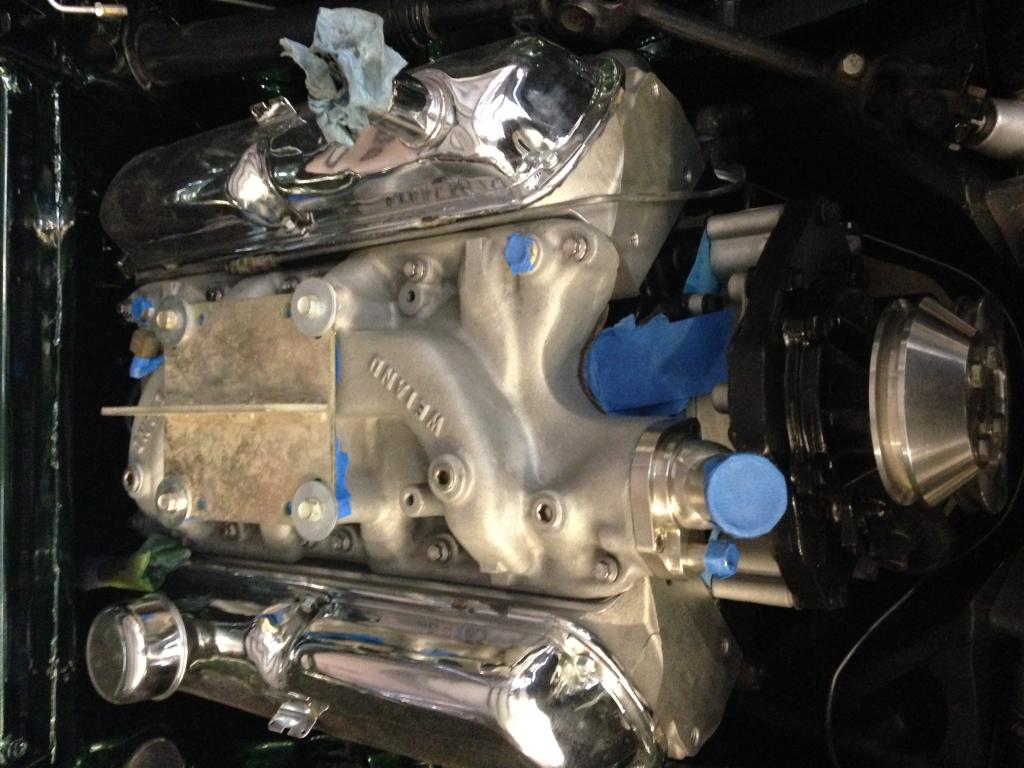

Funny how things evolve. The rebuild rear end and posi are in and painted.

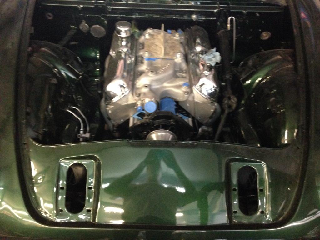

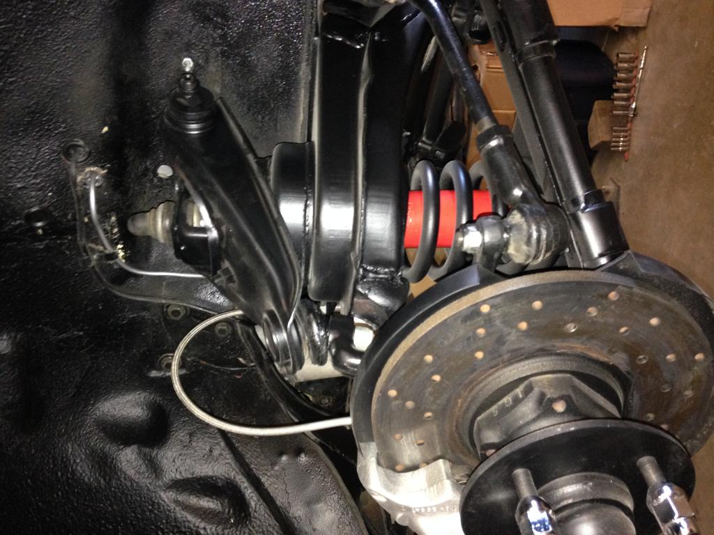

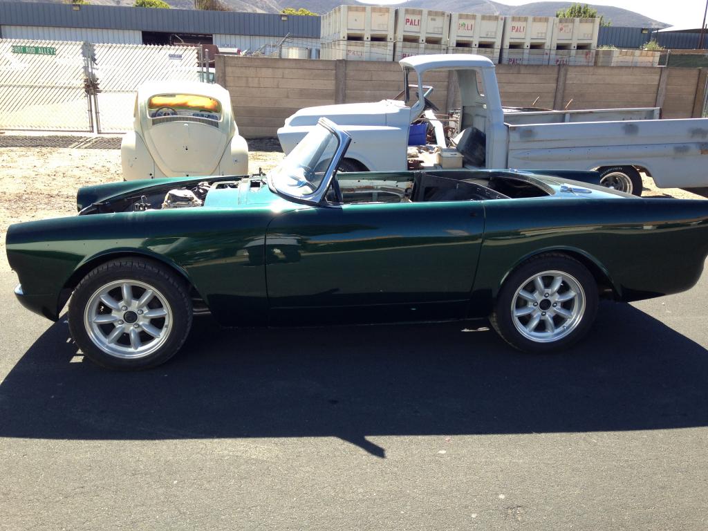

Engine: The engine in this car when I bought it, as I have previously stated, was a Boss 302 with heavily worked 289 heads and a Rhodes cam and lifter set up which I was dubious about. It was built back in the late 80s by a hot rod shop. I did get it started and it was very lumpy. I worried about all the seals etc. after a 25+ year snooze and I kept thinking about the possibility of having to re-do it after getting it all back together. Plus, I wanted to paint the engine compartment. So, pulled the engine and replaced it with a new 347 stroker with aluminum heads. It already had the T5 so I replaced the ring and pinion set with 3:31 gears. (also running 15 inch wheels) It's back on the ground now and ready for rewiring and dash refurb. Did some clean up on the front cross member, brakes, rack, etc. and re-painted the parts. More to come...
