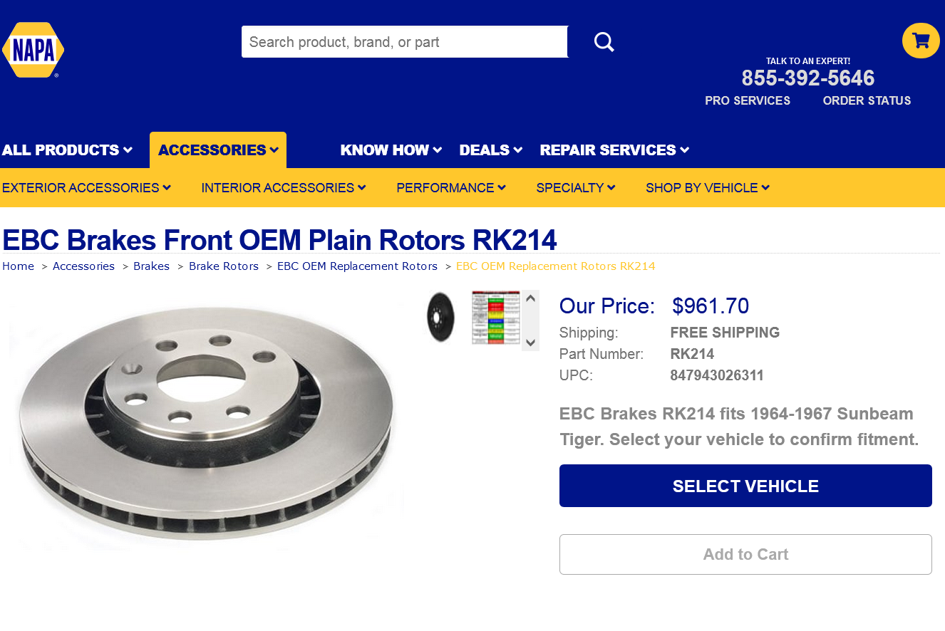

A quick web check, ....Oh MY.....$$$$
Don't worry about the incorrect picture, they will Fit Just fine....
...or your MONEY back......????
The GOOD news, Free shipping!
BUT, remember, THAT price is EACH! .....maybe??
https://www.napaonline.com/accessories/ebc-oem-replacement-brake-rotors/1338fac1
Screenshot 2023-03-21 at 08-46-10 RK214 EBC Front OEM Plain Rotors - Fits 1963-1968 Sunbeam Al...png

The Napa price is insane, why I bought them out of the UK. EBC in the UK also has the incorrect image, but I can confirm that they are the correct part.

The Good news, Summit also sells that part number (RK214), but they list it as a PAIR of rotors...for the same price.
...as if it matters, ETA 4-11-23.
