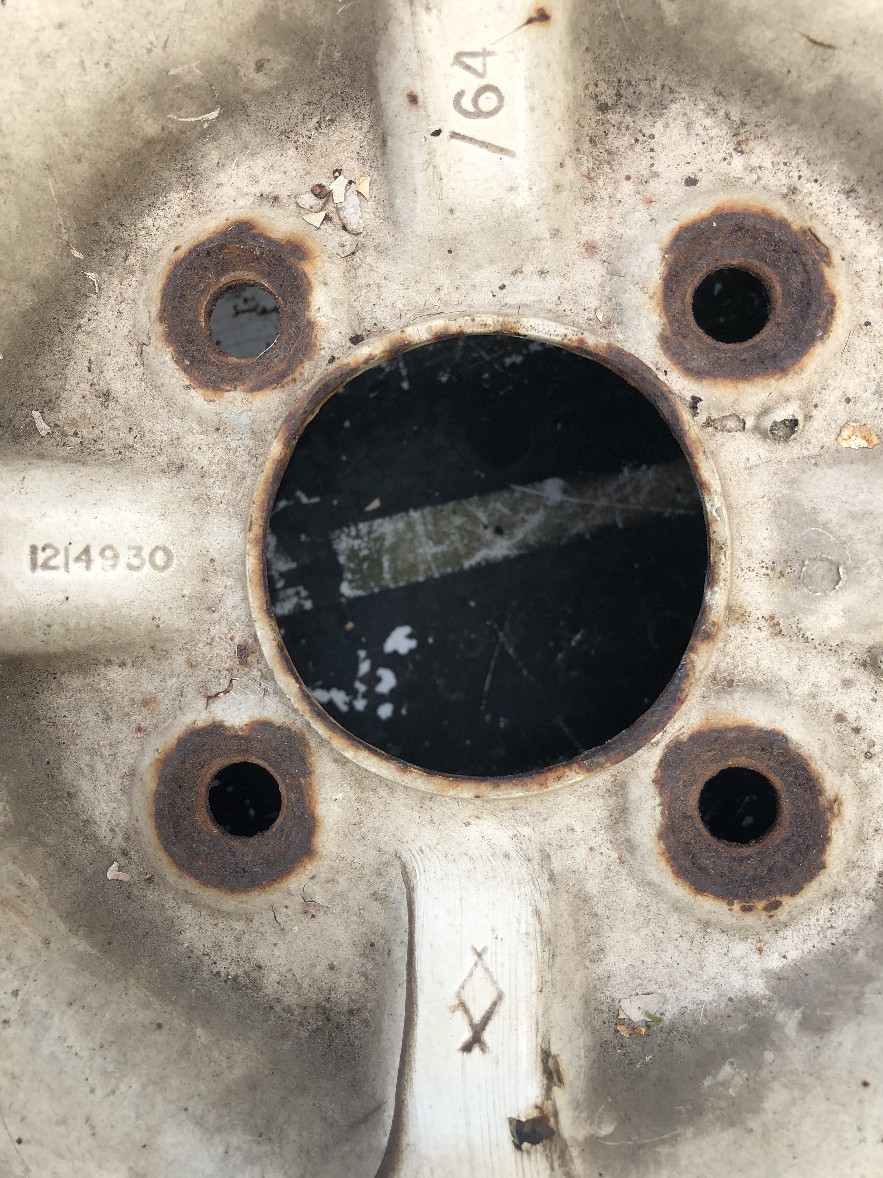

I have a Tiger that was manufactured in Dec 1964 and is using the original 13 inch wheels but have 2 sets of 4 because one set had winter tires on The 2 pictures I have attached show the date stamp of 64 and the dark green one of 65 my question is would the date stamp of 65 be used on a later date than 64 Tiger or not used on a Tiger at all ? Thanks
Both look to be the reinforced center boss wheels. Put the 64s on the car as they are the dirty snow white color. It doesn't make sense that the wheels to be white and visible through the cross hatch trim rings you have. But white was stock. Look forward to seeing your album.
