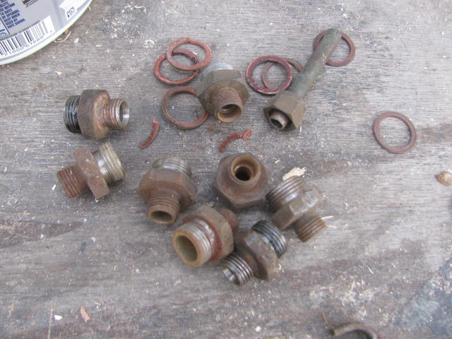

Does anyone know what size and type hose barbs will fit a stock S.U. fuel pump? The ones that I've found do not seem to seal properly. Will this fuel pump supply a 600 cfm 4 barrel or should I invest in a Holley 97 GPH RED Electric Fuel Pump?

Caution: I have talked to Rick at S.S. about his SU fuel line fittings. They are correct, BUT, the machine work is not finished! Must drill a 1/4" completely thru the fitting and then step-drill a 5/16" recess 1/4" deep to receive the fuel line and Farrel. The compression nuts are Brit Straight Pipe.
Better to grab Bryan's originals.

here are the fittings
