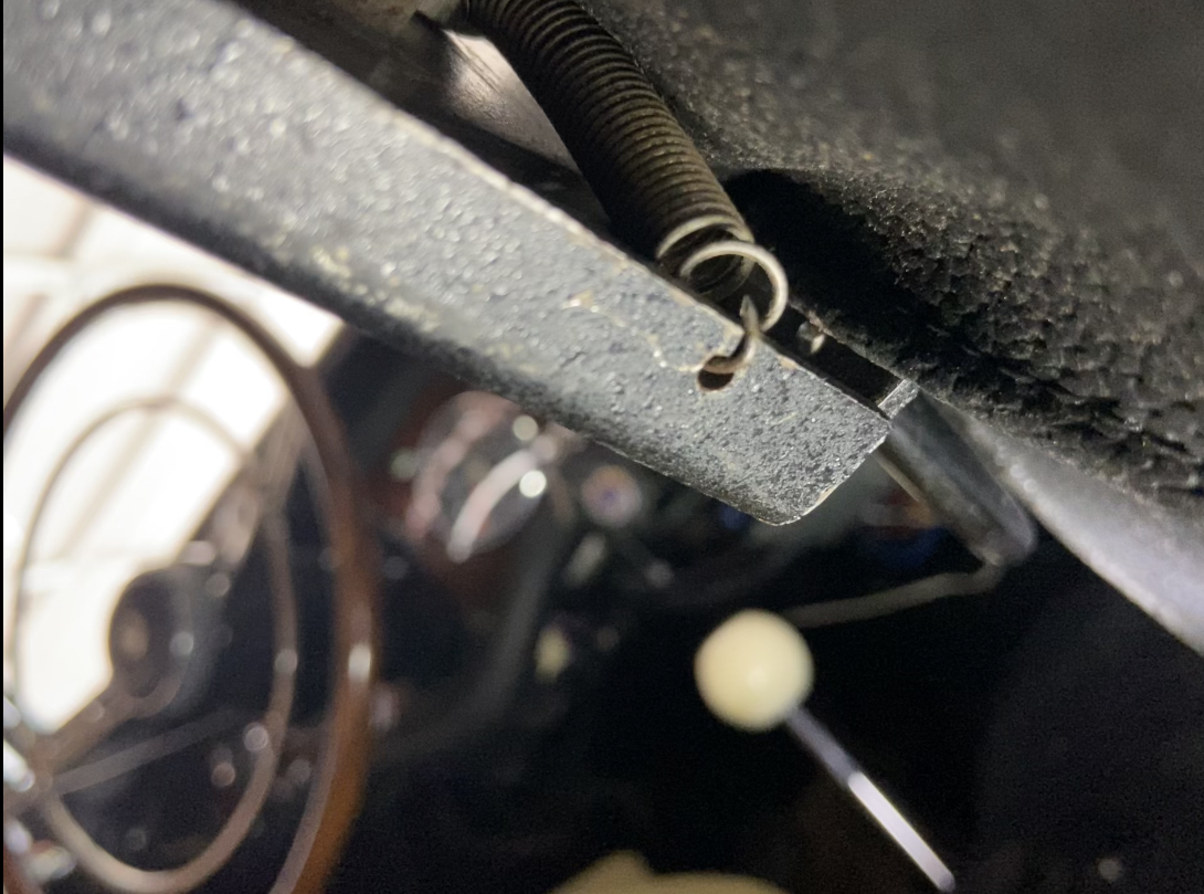

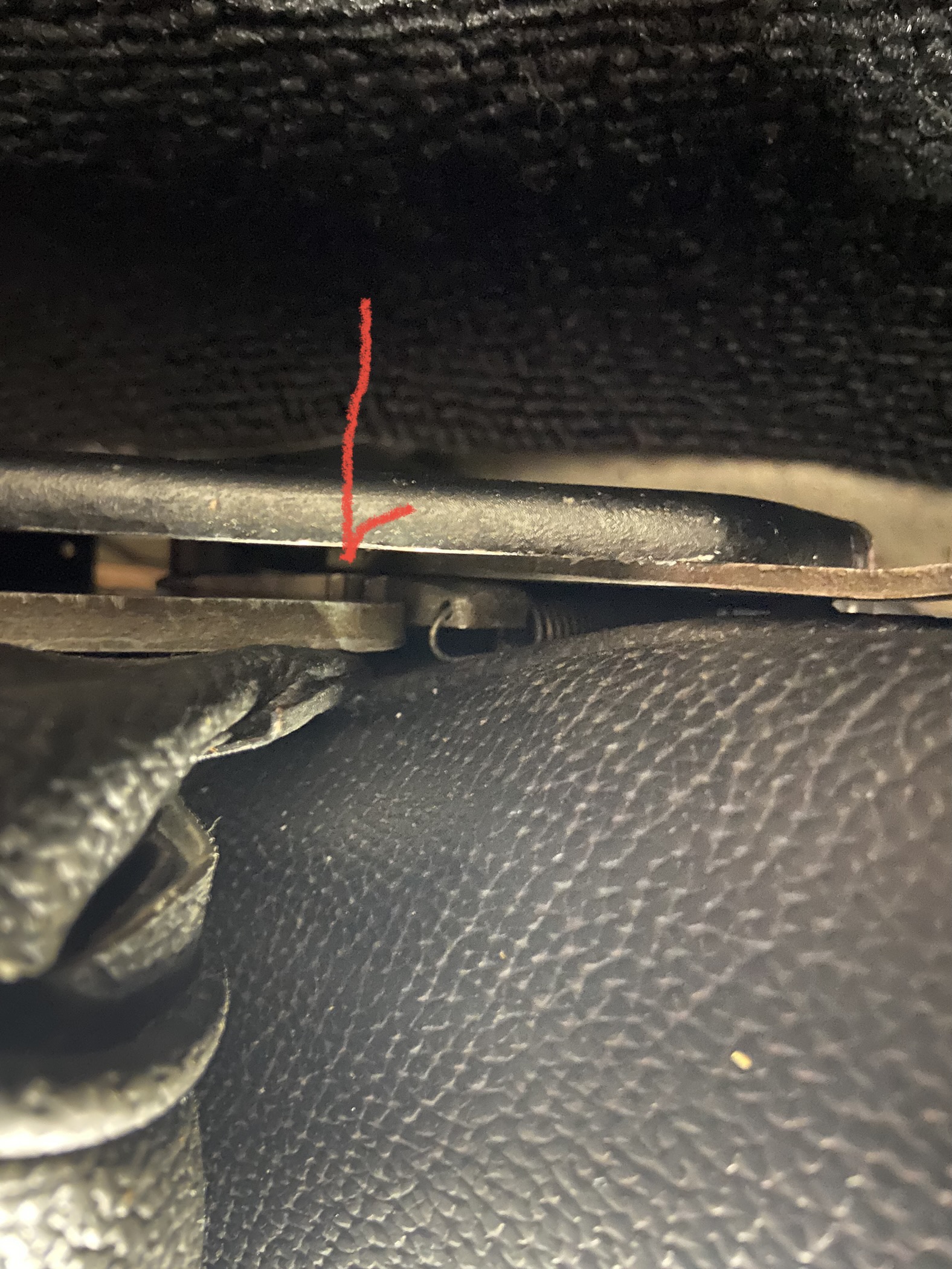

Here are the pictures of the seat back lock mechanism. The gears don't seem to fit as well as I thought but they do overlap by at least 50%. The second photo shows the spring that I think is the problem. I'm going try to pull some of the coils down to give it more tension. If that doesn't work it's back to the folded up army blanket stuffed behind it to keep it upright.

they should be flush. I'll bet when you take it apart you will find some pretty severe wear. I have the gear, pawl and spring if you end up needing them.

Here are the pictures of the seat back lock mechanism. The gears don't seem to fit as well as I thought but they do overlap by at least 50%. The second photo shows the spring that I think is the problem. I'm going try to pull some of the coils down to give it more tension. If that doesn't work it's back to the folded up army blanket stuffed behind it to keep it upright.View attachment 17966View attachment 17967
Yup; that is a common misalignment fer sure. And you can bet the teeth edges have suffered. The upright portion of the lower seat frame has shifted which leads me to apply my long-distance diagnostic crowbar. They are a marginal frame construction and will tweak back easier than they should.
