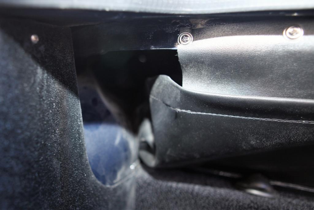

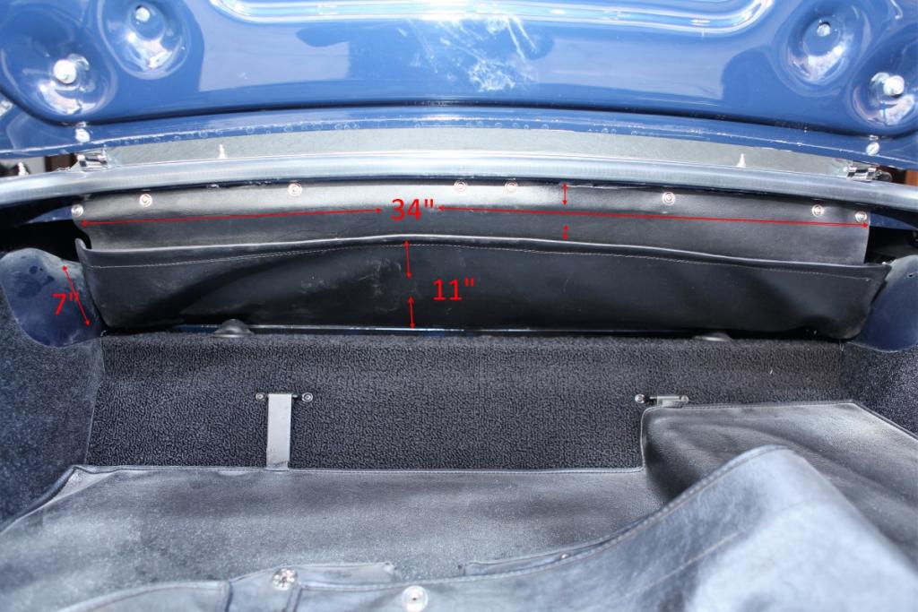

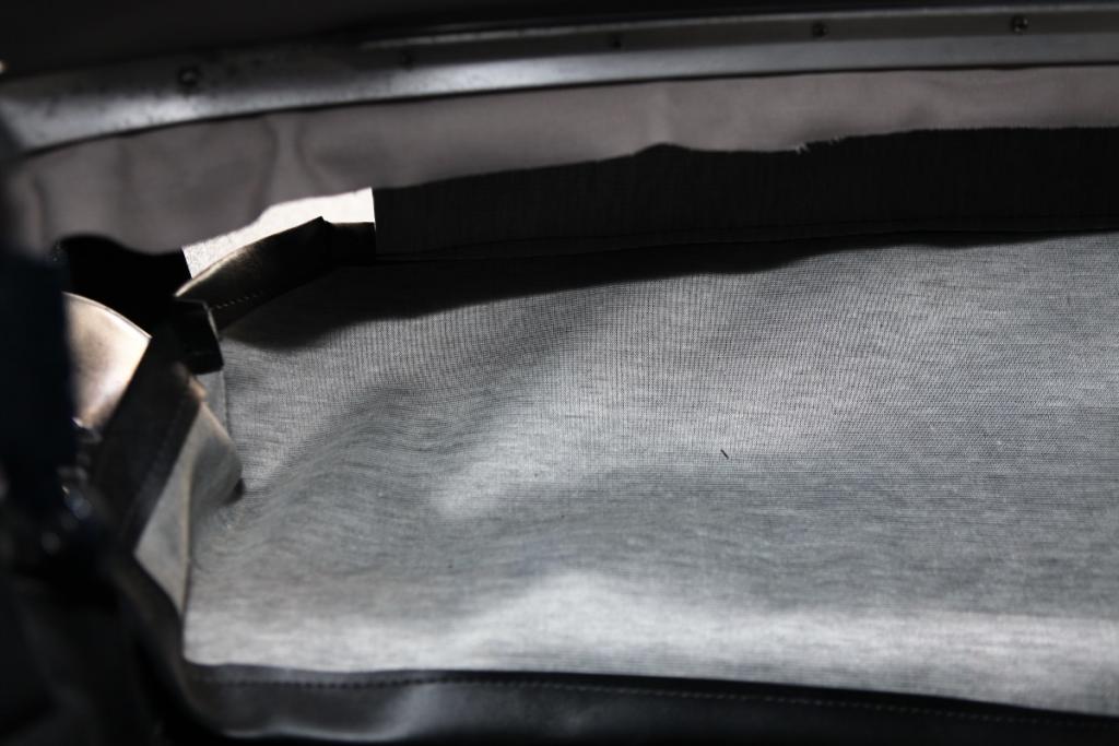

CLIFF_MK1
212
Here are pictures and measurements of my top container (bag, drape). These measurements are approximations since it's hard to get an accurate measurement when it's installed. The 7" is of the material that loops back and fastens on to the body. This is an after market bag installed with screws rather than rivets. I think this bag is too small since it's really difficult to get the top and all the hardware fastened down in a MK1. Hope this helps, Cliff

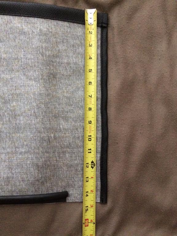

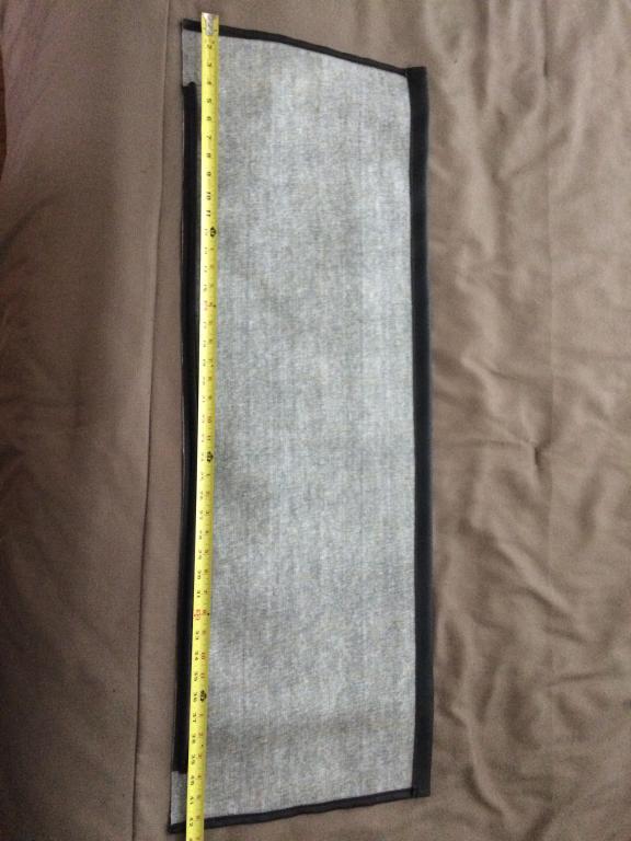

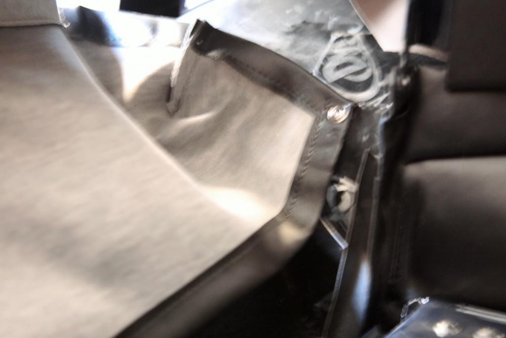

Jon B
93

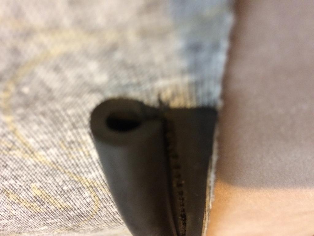

I just measured a reproduction I got from Sunbeam Specialties. It's for a Mark 1A and pebble-grain. It's 15&3/4" top to bottom with the top 1&1/4" folded over to make the sleeve for the metal strip to slide into, and 43&1/2" wide with 1/2" on each side folded over and stitched. The rubber molding at the bottom is 36" wide and not quite centered; it looks a bit like a split hose with an approximately 1/2" flap coming off of it for its entire length. I tried to get a decent photo of it.
-Jon
