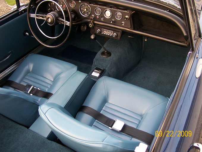

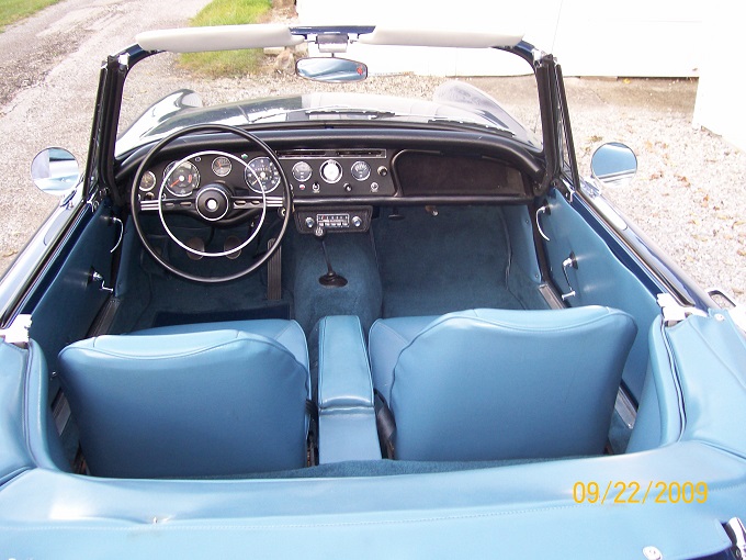

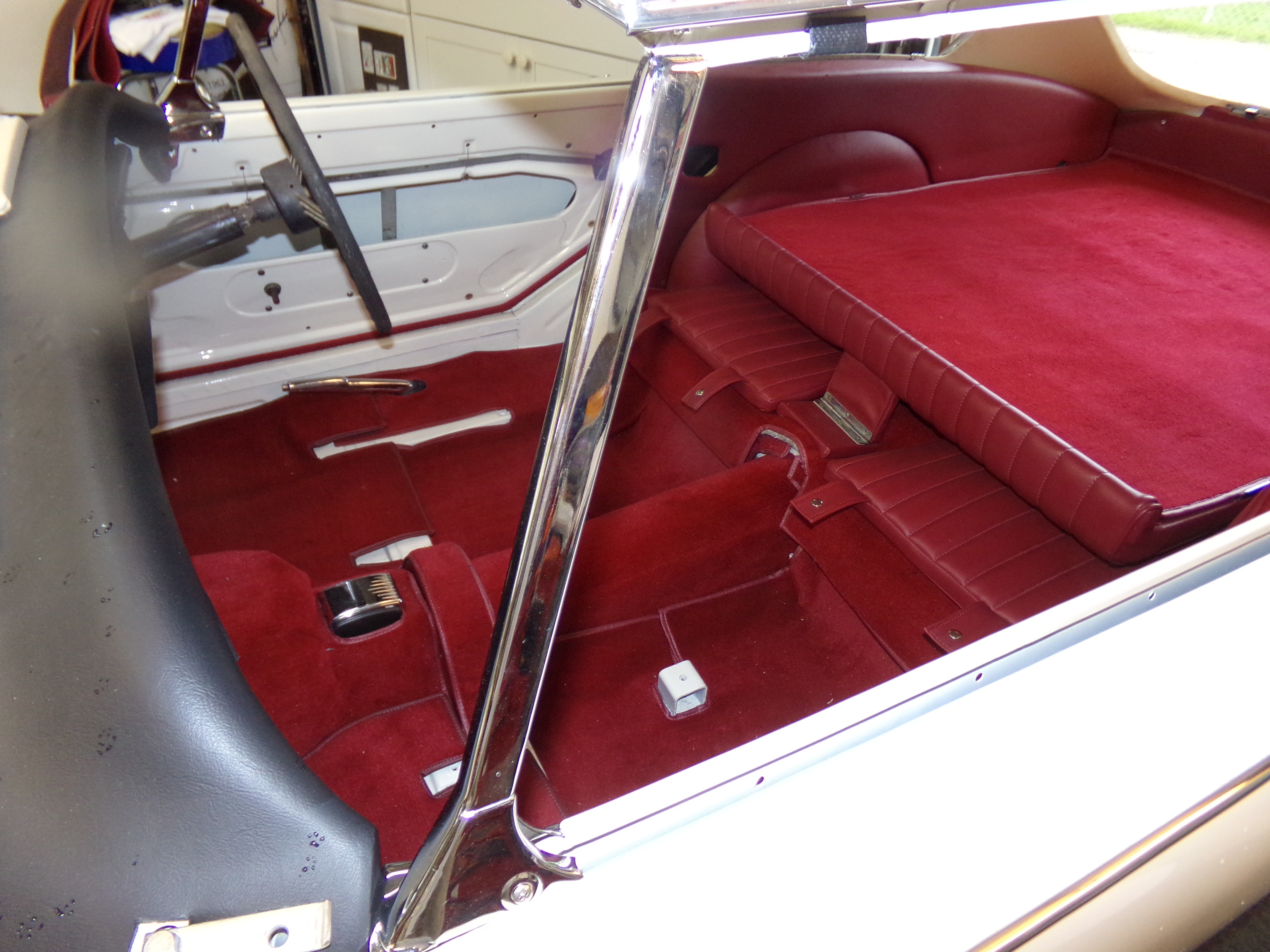

A complete blue Martha interior that also has a top boot cover made using the same seat / panel material. Carpets are wool. The red carpets in one of our other cars has Martha's nylon carpets. My green car and the red Harrington both have Martha's black nylon carpet. Excellent work and have held up great over the years.
