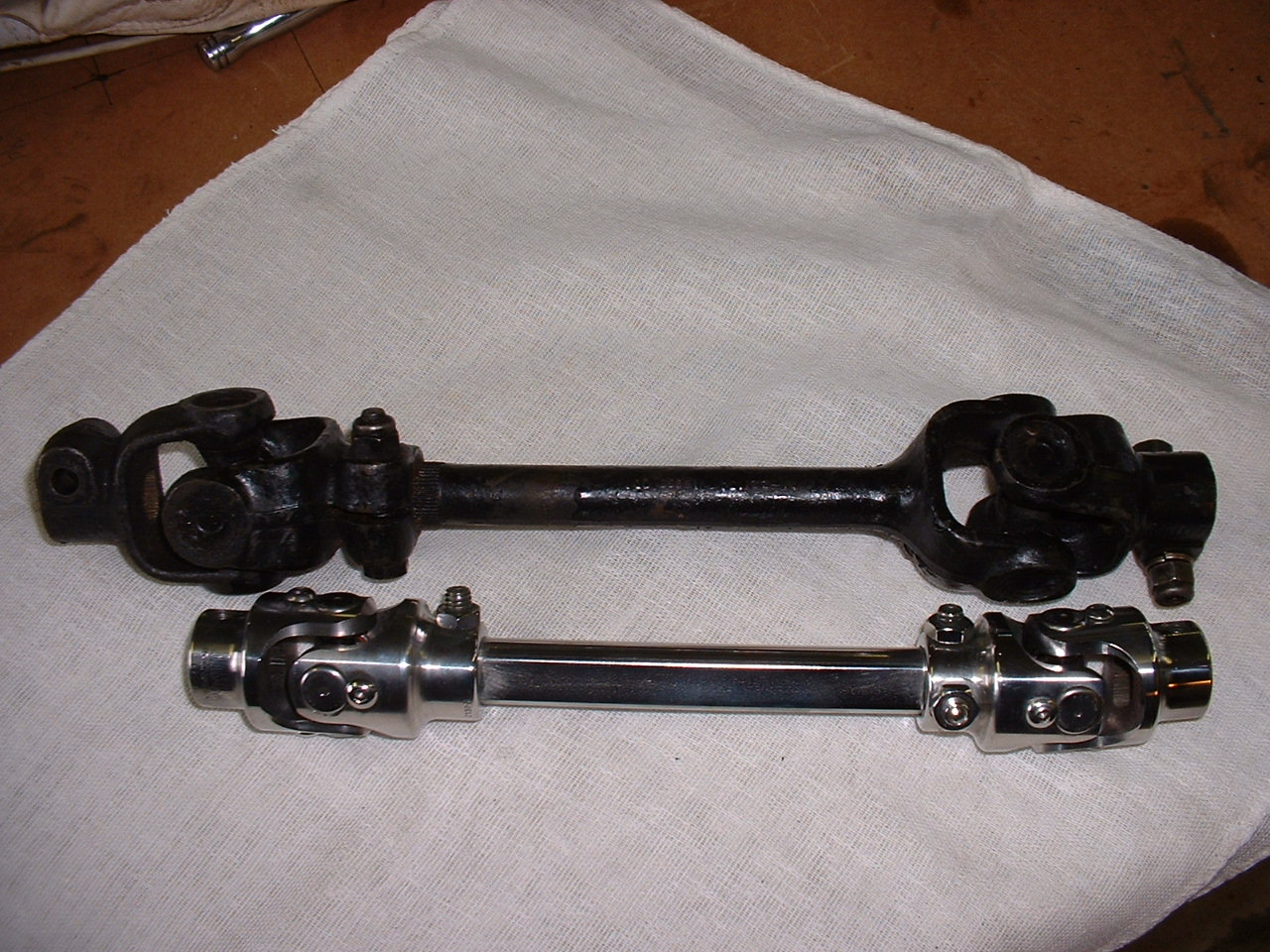

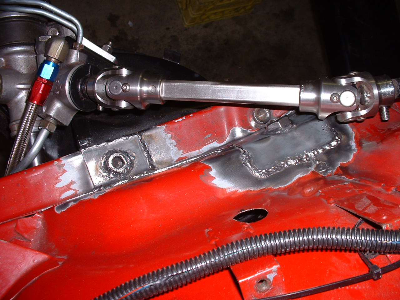

I got mine from Flaming River when I swapped in the Mazda power rack... the original 'dogbone' was too long
All stainless with a double 'D' shaft
I think the column spline was 3/4"-48 x double 'D' IIRC and the lower was maybe 5/8"-36 ... whatever the size, it was the same size/spline as the stock rack... http://www.flamingriver.com/index.php/products/c0005/s0011 they also offer joints that can be welded to a round shaft on one end and spline on the other end... http://www.flamingriver.com/index.php/products/c0005/s0003
