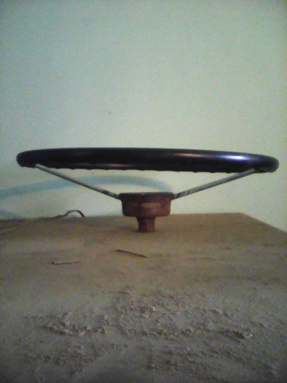

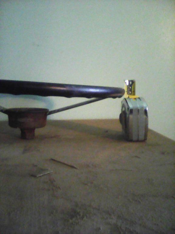

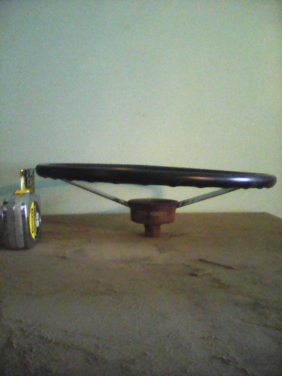

Is this Hub bent? Or did they make them this way?
65sunbeam
399
Is the splined center square (at 90 degrees) to the metal hub? Does the metal hub show signs of being bent towards the spline?
67 Tiger
298
Yes the splined nut looks square to the hub. No the hub does not look bent. The spokes look like they might have been rebrazed, out of square. SO I GUESS THIS WHEEL IS JUNK!!!!!
1,243
Can It Be Fixed?
Yes, the wheel does look crooked and not square. If the spokes appear to have be rebrazed such that the wheel is not square, can you break them loose and rebraze them again while making the wheel square? Seems better than throwing the whole wheel away. (I am assuming that the brazing was done at the hub end of the spokes and NOT at the wooden/plastic wheel end of the spokes. The hub will be covered up by the plastic around the hub itself.)
Wonder why a P.O. did this to the wheel?
Good luck with the wheel if you do decide to do something with it!
67 Tiger
298
The color of the Braze/weld looks like brazing, BUT it looks welded, and grinds like a weld. The repair was done in the inside of the hub. I have TOO much money invested to just give up now. The REPAIR piece I bought from Eric is just to FREAKING BITCHEN to not use. I need a better cutting bit for the Dermal. I have a mig, and a torch, so I can braze or weld. The Seller of the wheel is just a thieving rip-off, HE had to know what a piece of crap he was selling. KARMA WILL BLOW UP HIS CAR.... I HOPE. That's what I get for trying to put an ALPINE steering wheel on a TIGER!!!!!

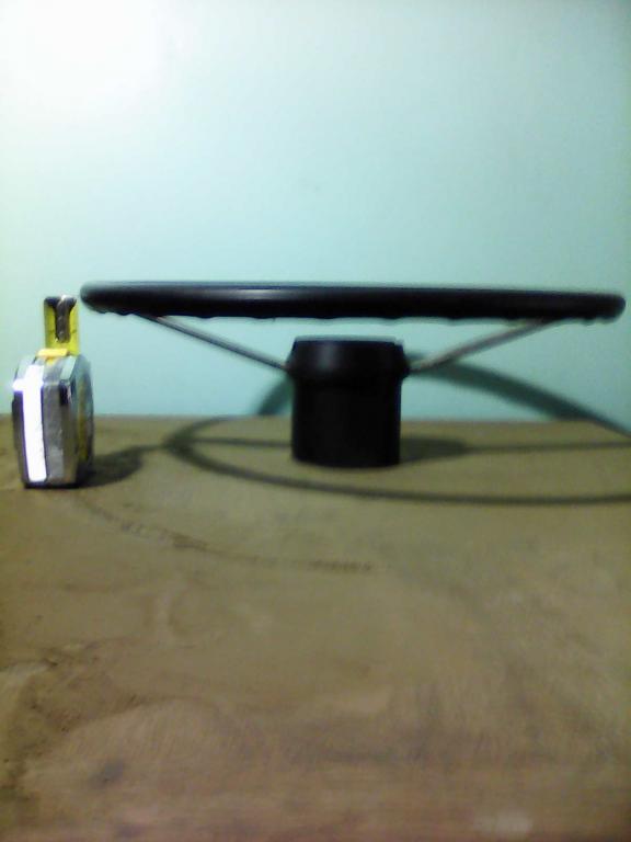

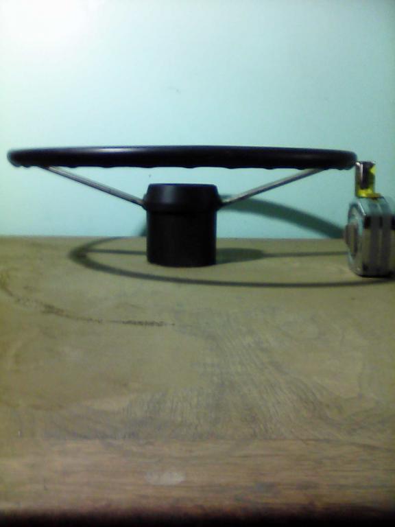

Just to make sure, are the bottom 2 photos the BEFORE photos and the top 2 photos the AFTER photos? Looks like a great improvement! Congratulations on a good job.
67 Tiger
298
YES. I have added before and after to the photos so there will be no confusion.
Thank You, Its still not perfect a little off top to bottom. BUT my Tiger is not a "Restored" car, a little messed up goes well with the rest of the car.
Forrest39
406
I think I have the same kind of car! That was a good one...
And nice job on the wheel too!
-Kevin
