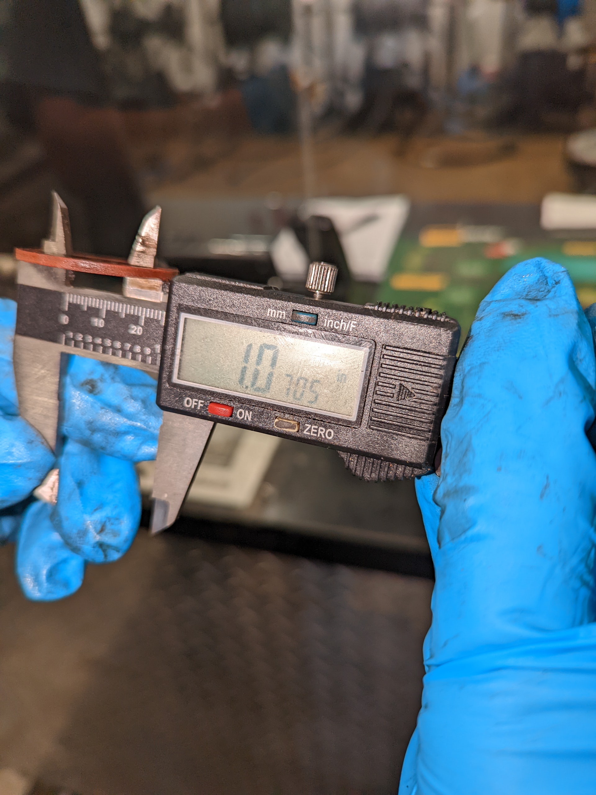

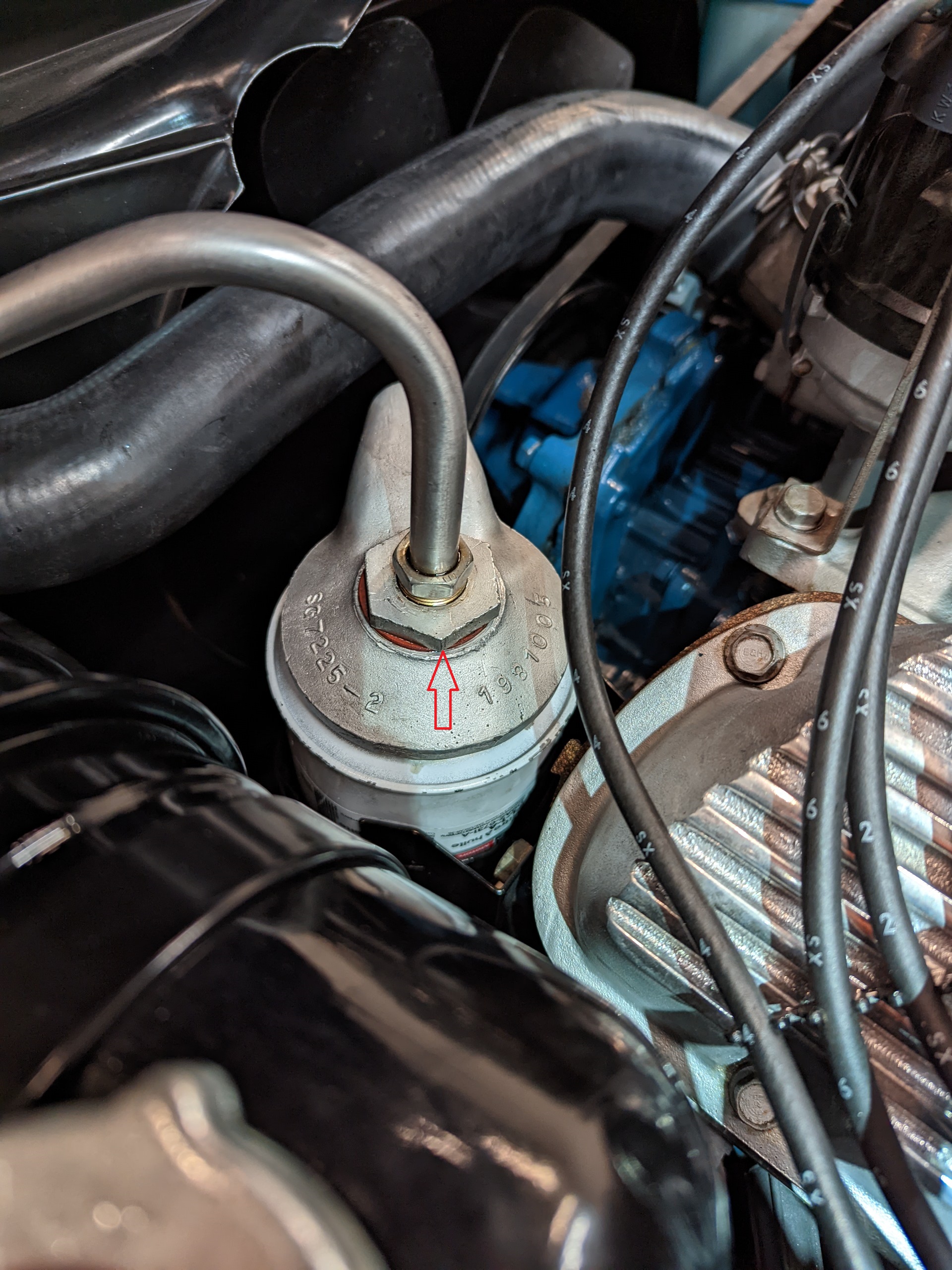

So, I am changing my oil and filter for the first time and have a leak. I removed the gasket and replaced it with a new one from SS. My observation is the replacement gasket is a bit larger ID. 1" vs 1 1/8 ID. so is a bit off-center and isn't snug on the adapter. Have seen that the replacement gaskets have been used with great success so I suspect that it is user error by the FNG. I felt like the fitting was snug enough without crushing the oil filter gasket.
What has your experience and solution been? Should I put the original gasket back on? remote filter.jpggasket id.jpg

Earl's supply has a nylon washer than fits under the adapter nuts that works much better than the fibre washer currently available from sunbeam specialties. I have found that most leaks at this point are burrs on the face of the adapter nut on the washer side from using the wrong tools to remove the nuts. The adapter nuts are 13/16 Whitworth... not SAE or Metric. I usually take a flat file to the surface to make sure that it is flat. The nylon washers are considerably thicker so they can compress to take up any irregularity. I don't get leaks at this point when using the nylon washer.
I don't have a part number, but the washers are sold by dimension so it shouldn't be hard to get what you need. BTW, I'm the guy who makes the hoses and I live in Washington, not Oregon!
