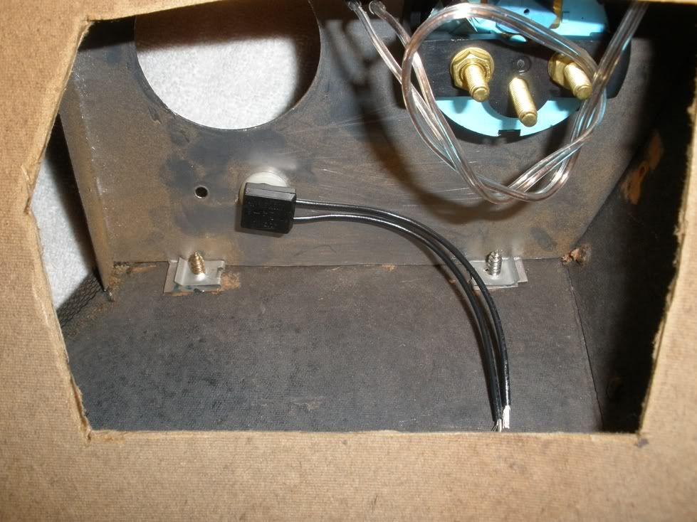

Panel is finished, need to paint with black wrinkle paint.
Used BMW 8mm screws and captive fasteners. I knew those things would come in handy some day. I cut the back in order to have access to the back of the panel when it is installed.

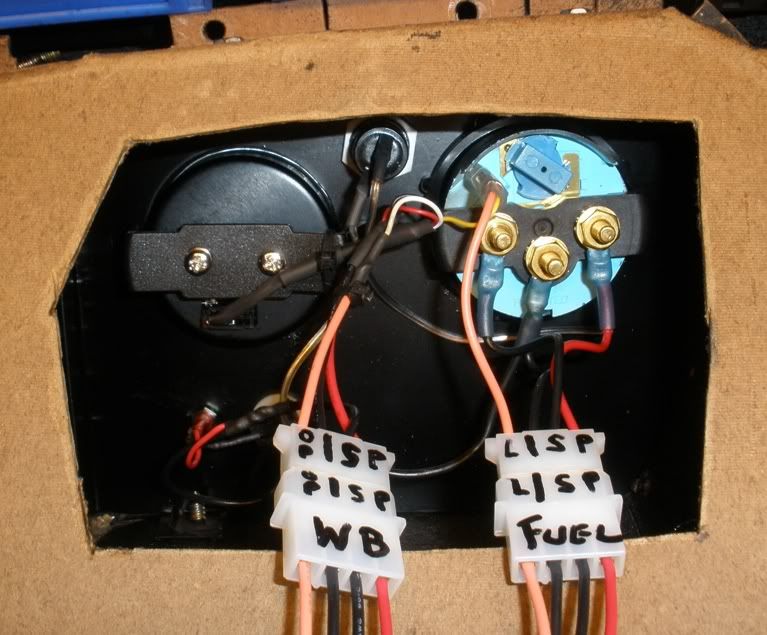

All wired up
Only wanted two connections to the wire harness in the car.
Bond that is..........James Bond Glove Box.
Left room at the center bottom for one more gauge.... possibly oil temp.

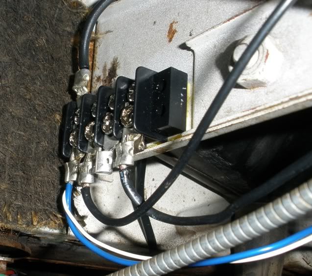

The WB O2 electronics need a really good ground and all grounds must be to the same location but not stacked due to any change in resistance due to corrosion can change the voltage. This is spelled out several times in the install manual. So my fix was to use a wire bridge and ground it to the engine block which is the best ground possible in a car. Here is what I did -
Large wire on top is to the engine block (or will be once its back), wires on bottom are from the WB controller and gauge. Also used it for some other grounds to clean up the harness. It is attached with Velcro.
