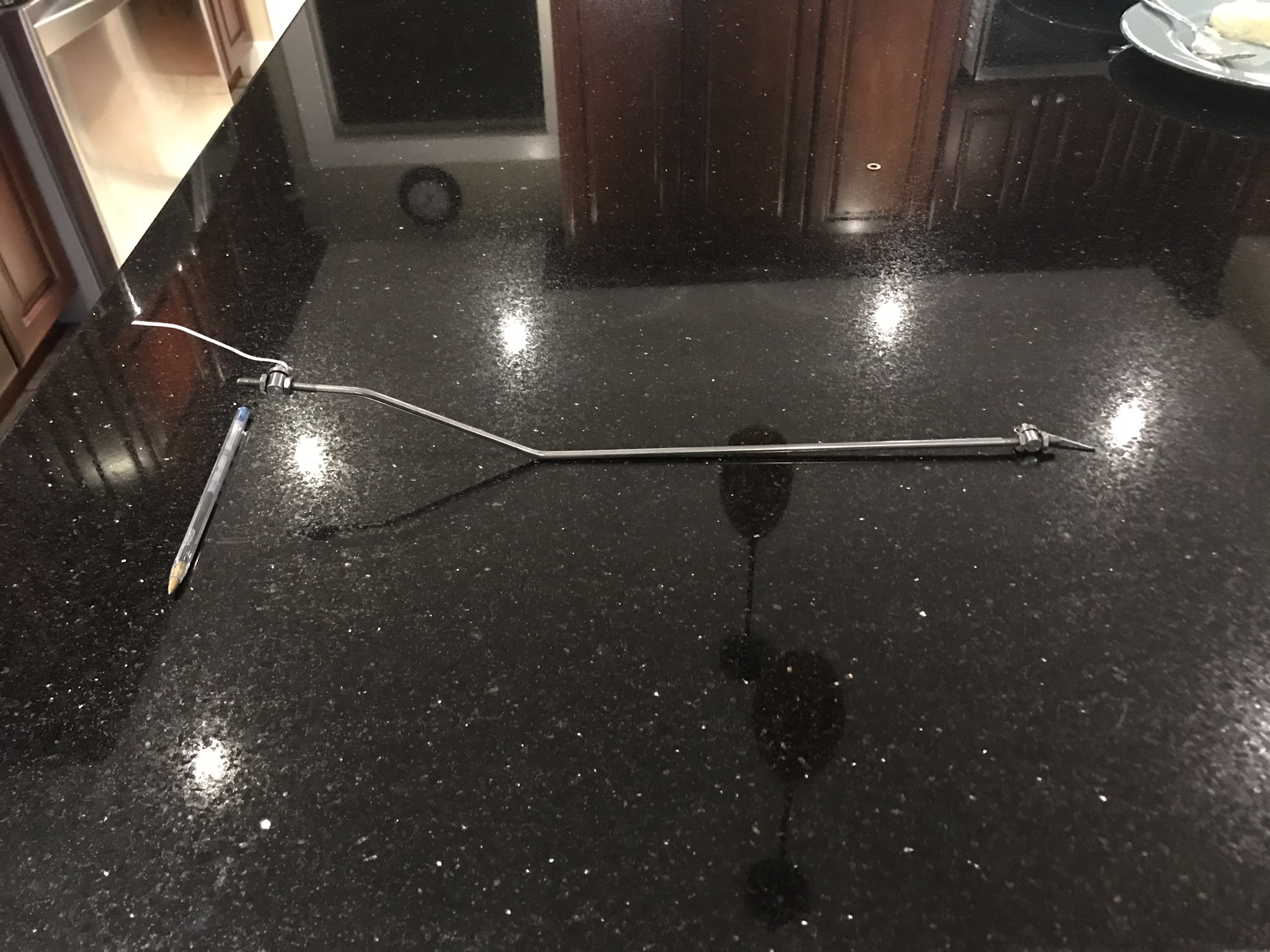

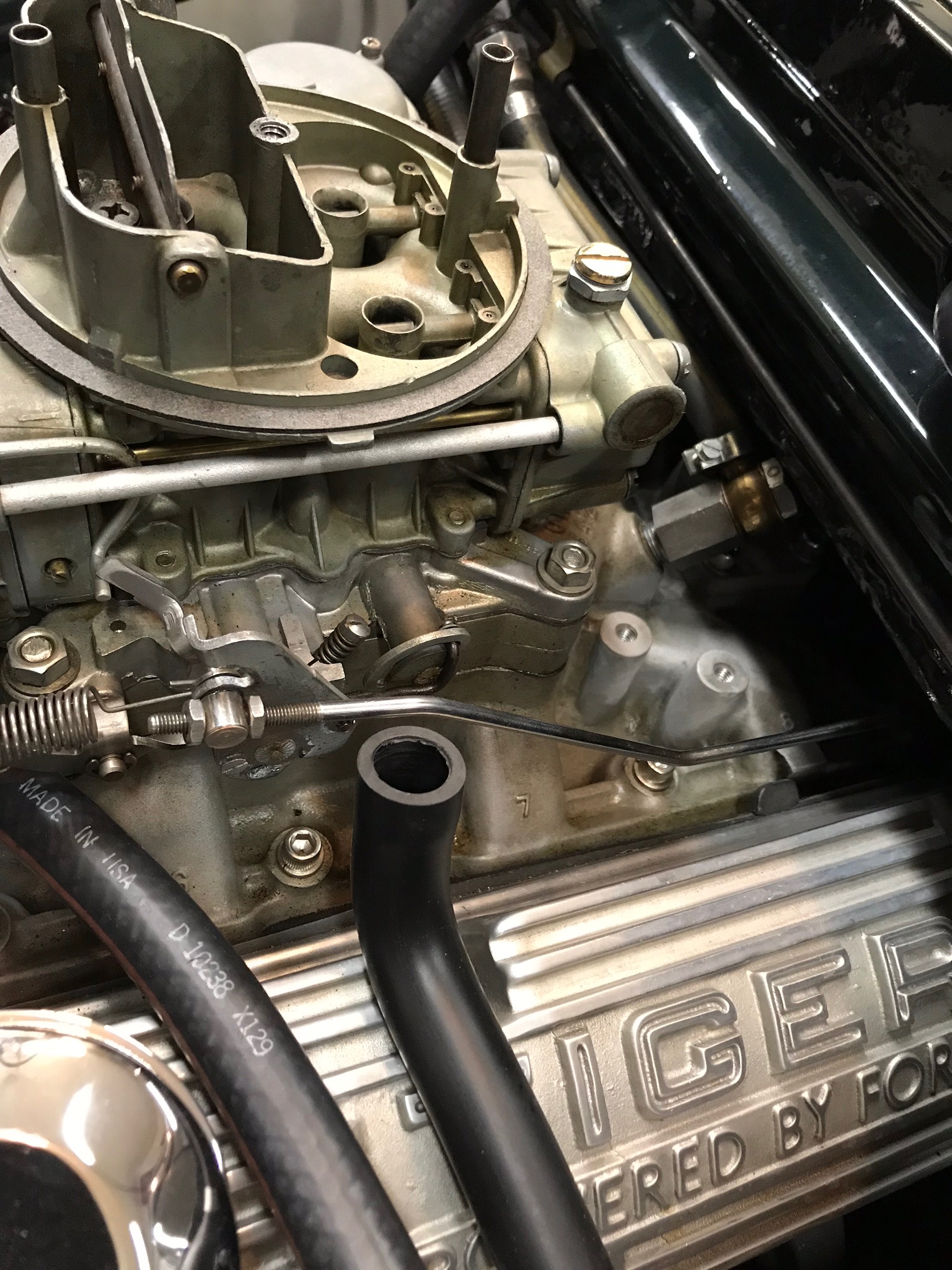

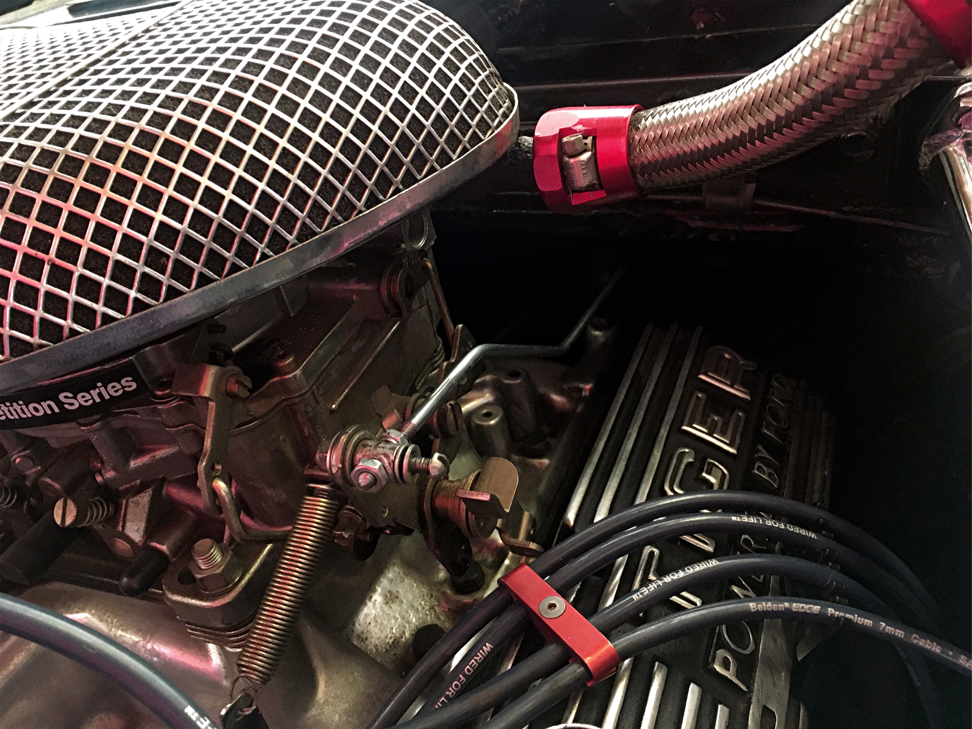

Assuming you have the cable set-up...I had a coat hanger for years, but recently made a solid rod throttle assembly.

I’ve used this 3/16” stainless rod for the past 30 years. Flawless in operation and nothing modified on the pedal or carburetor side.
Most of the aftermarket stuff I see is for floor mounted pedal. I can't picture the stock Alpine one bit recall it's a non cable rod operated one. The later Fords like the Maverick and Falcons had a cable and pedal set up.
mr55s
333
There are two threaded parts at each end, on one side they are turned down to go through the hole on the pedal bracket and drilled with a cotter pin to keep it in place, on the carb side the same but instead of a cotter pin the throttle return spring is used.
Theorangetiger
336
Looks good, thanks. I think I'll go in this direction and figure I'll start with all-thread to get the bends and legnth right and then duplicate in stainless rod and thread the ends.

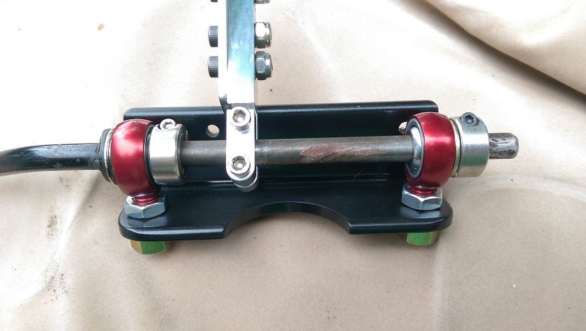

My problem is the throttle pedal assembly.....the gt sparklplugs solution looks awesome but I don't have
the setup to make it myself......anybody find a resource that will make it?
Hoghead
584

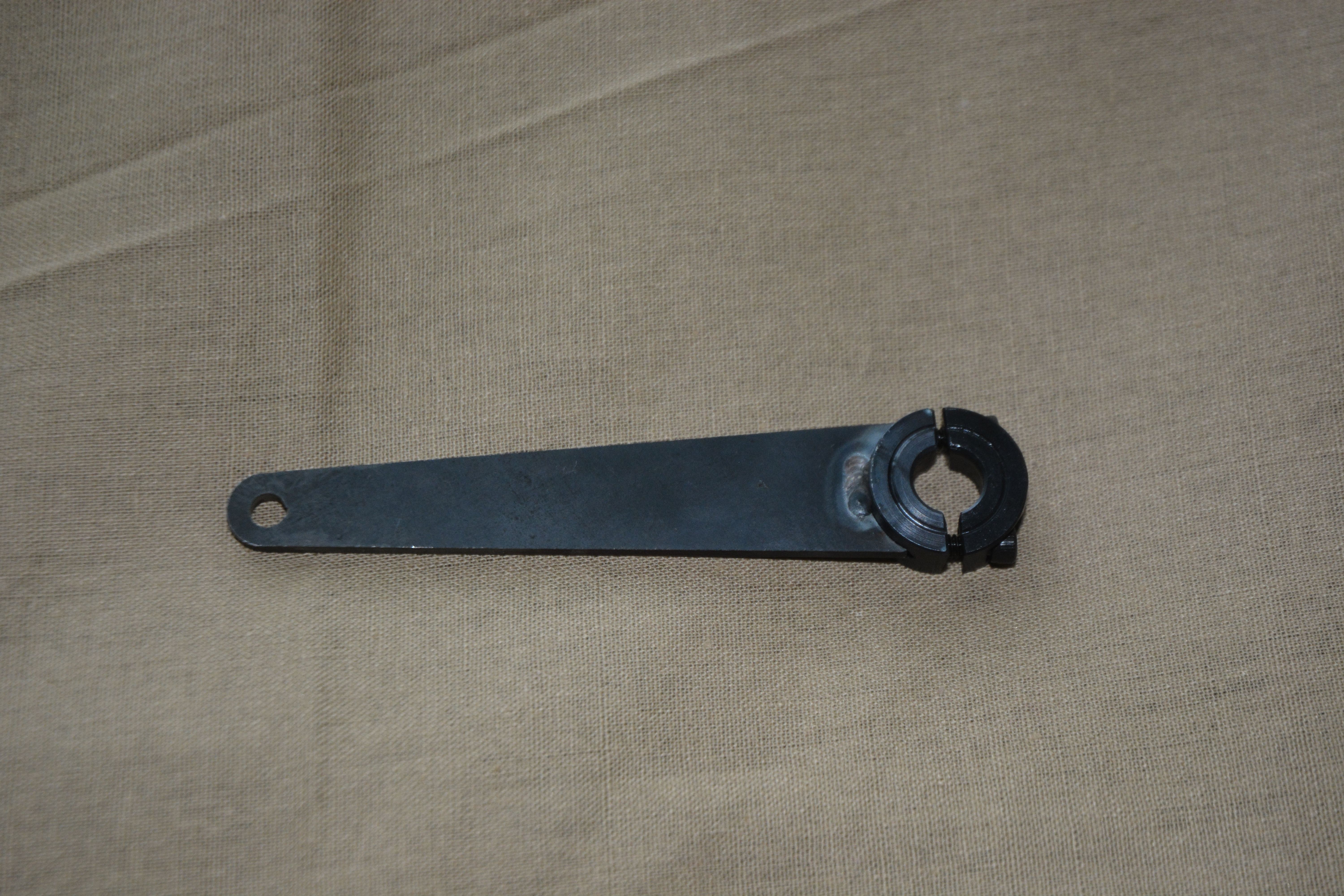

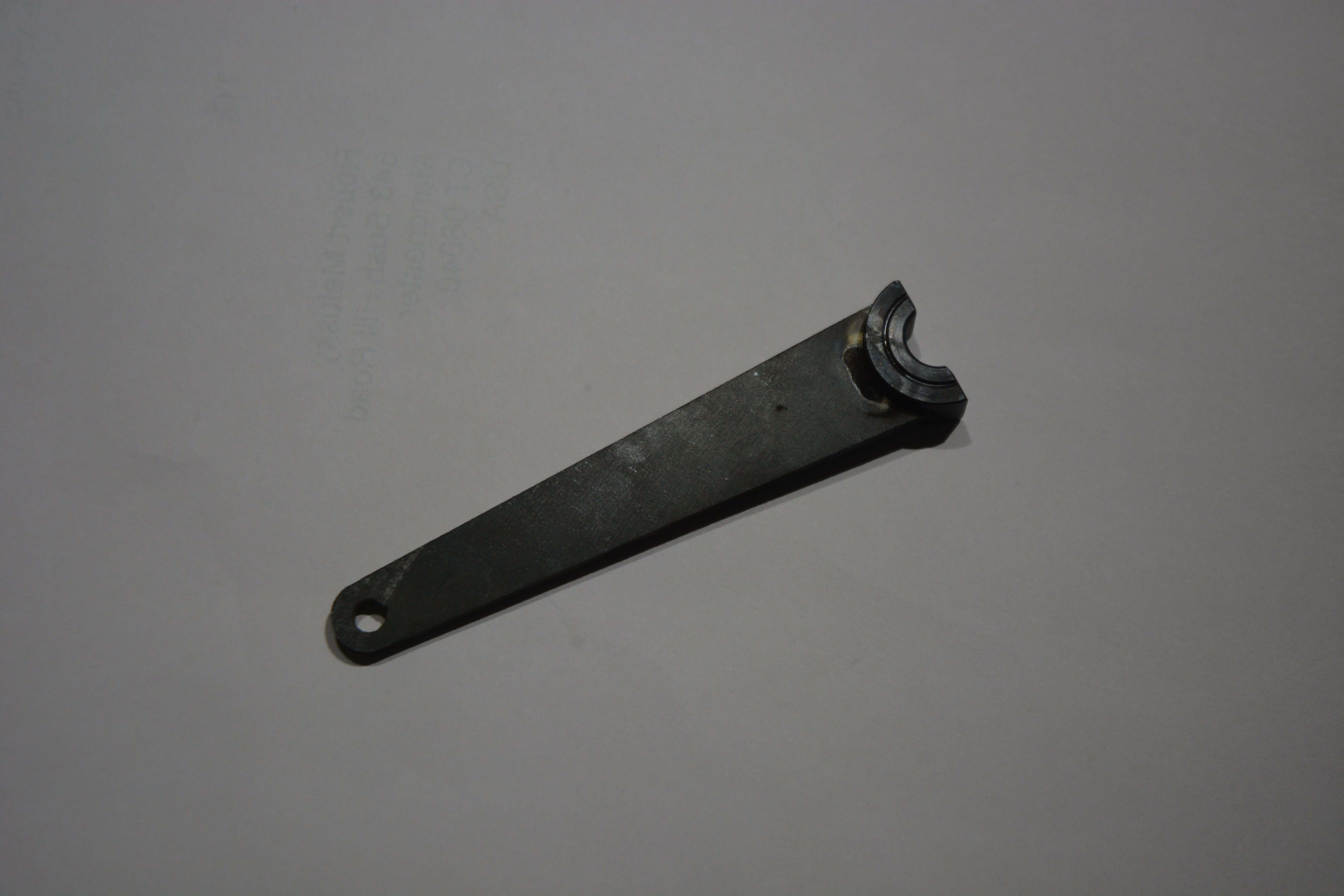

I modified Sandy's design to simplify the throttle arm. I used the same off the shelf stop clamp to hold a water jet cut arm - pics attached
I made a couple of extras, and would be happy to send to you at cost, but they are at my home in Canada and I am stuck in Thailand.
I could easily make more and post them, but here is the drawing to make your own - check that the OD of the clamp is the same as the one I bought
It is easy to make this as Sandy posted the drawings with part numbers. My arm makes it easier............
