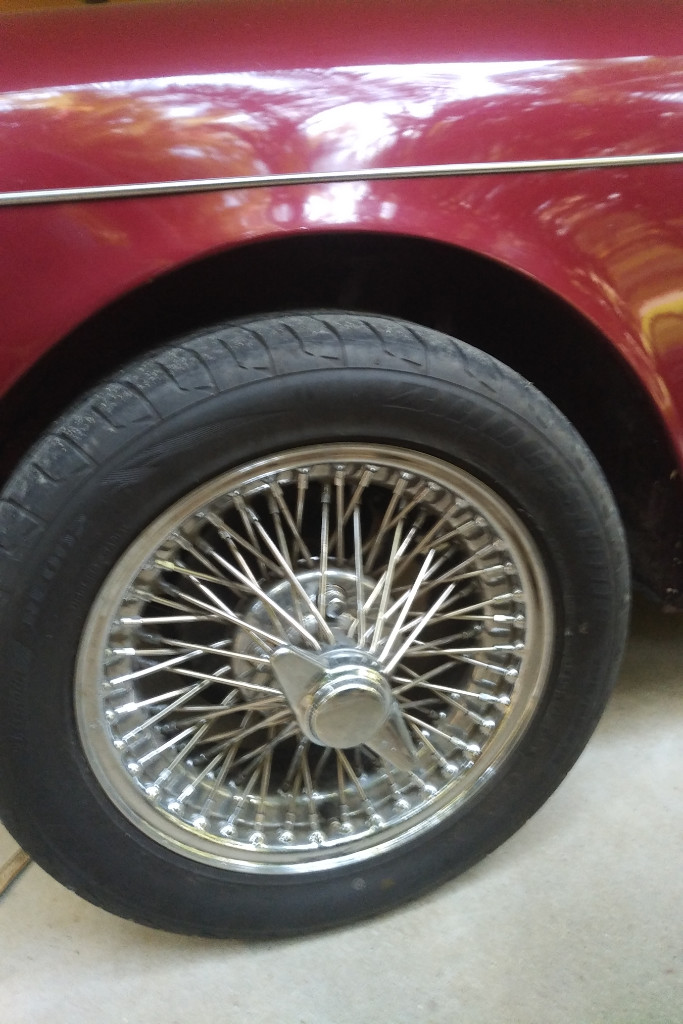

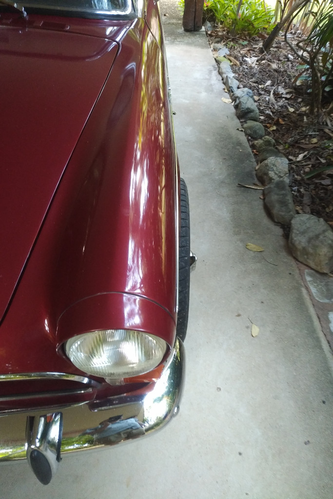

Stock hub, with wheel bolted onto it -- I figured the manufacturer-spec'd backspace would still dictate how much a 6" wheel sticks out (having said that, the total width of the wheel is 7", but again, I'd think the extra inch there is pretty standard difference between internal 6" measurement and the outer edge of the wheel!)
But yes, the wheel itself does stick out too far (about half an inch), and I figured getting a narrower tire like a 175 would at least reduce some of the extra bulge of the tire beyond the wheel (outer edge of tire is more like 1-1/2" beyond lip after measuring just now). TBH though I have no idea why given the specs (width and backspace) the wheel can be so prominent when I haven't heard others having the same problem.
How much negative camber can (?should -- the -1/2 in the specs?) I have for performance (I'm fairly aggressive around corners, though this is strictly a street car) if I don't mess with canter/toe from stock?

They appear to be 72 spoke wires.. So should be somewhat bstronger than the usual sunbeam spec... You can run 1°neg camber without much trouble.. It will make low speed steering quite a bit heavier.. And id be more comfortable with neg camber on alloy wheels rather than wires... But it will tuck the tops in more.. You may want to look into the caster settings to help with self centering.. But beware the arae at the join on the fromt arch lip and valence from the outside wheel when turning... The tyre can catch the body there

Stainless 70-spoke. Dayton make strong wheels, so I'm not too concerned about the forces. Heavier steering tells me I'm onto the right idea then with the narrower (175mm) and slightly more rounded Dunlops to help counter that. Will try them with -1 camber and ~+4 caster. By my calculation, the combo of reduced tire width (by 20mm) and camber (600*sin(1) for a ~600mm tire height) will bring the top edge of the tire in by half that, or ~15mm, which looks like the best I can hope for.
