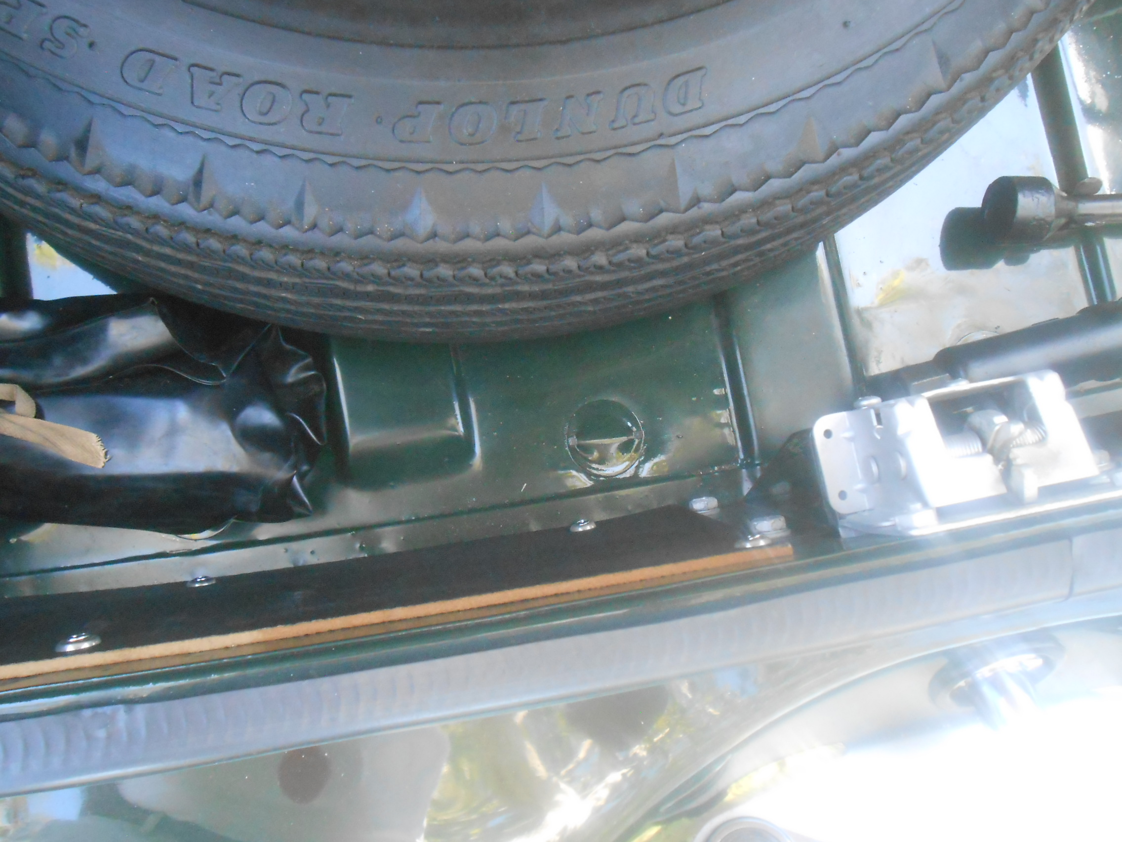

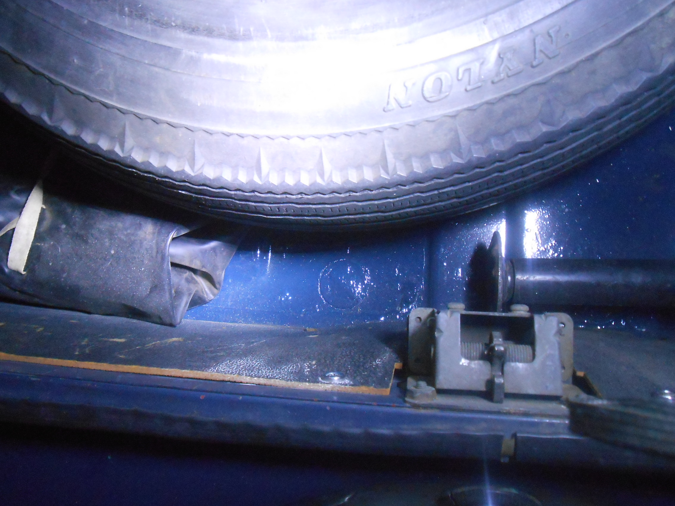

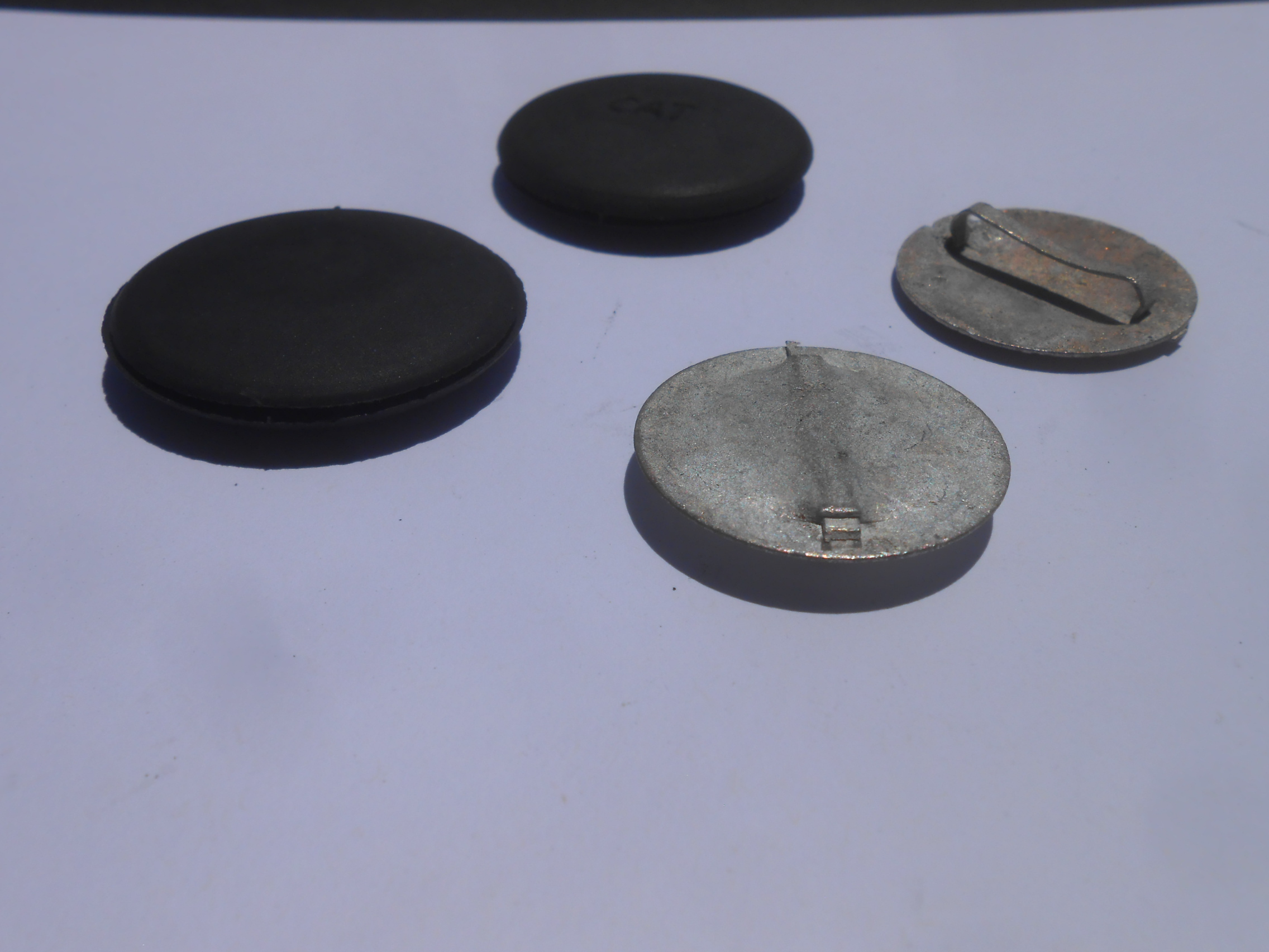

I am still in the process of restoring both my Mark 1 and Mark 1A Tigers (even though I think I just won Lord Rootes with the ’66). I now have some useless thoughts about trunk floor-hole plugs. I had wrongly thought that all round-cornered cars used rubber hole plugs. And remember, I was in charge of the CAT-hosted TU car shows for 20 years; and I went to that 2018 STOA car-show judges school where Norm M. explained to me what a trunk is supposed to look like, as we were going over what would become Ken M.’s extremely stock black vinyl dash, light blue Tiger. So, in my ’65 1300s serial number, which needed a new trunk floor and Alpine spare-tire well, etc., I installed the CAT rubber hole plugs. I have a connection to the CAT hole plugs, back in the late ‘90s when I was CAT president or something, I took the trunk floor-hole plug mold to Karr Rubber, here in El Segundo to have another batch of plugs made for the Club. This took months, and when I returned the mold to CAT Parts, all the other molds for rubber parts had gone missing. This was not the end of the world. By the ‘2000s, CAT rubber could not compete with the great stuff SS was selling. All except for the truck floor-hole plug rubber. CATs were closest to the original (and yes, you have to sand off the CAT logo). The question I’m asking is: when were the rubber-hole plugs discontinued, and replaced by the steel plugs? I was lucky enough to view Buck’s survivor ’65, 1500s serial number Tiger. This car is damn near untouched and has steel-hole plugs. I also looked at a round-cornered green Tiger at TU ’22 this past June, and it also had steel-hole plugs. I do believe very early Tigers used rubber hole plugs. I just don’t know when the change came. I do believe I got it wrong with my ’65. I should’ve installed steel plugs during the primer-sealant stage. Too late now. To add to everything else, I’m the guy selling steel hole plugs on ebay.

The spring steel plugs were the factory plugs, they were used in alpines and other rootes cars suck as mimx, superminx and scepters for plugging the mfg locating holes.
Rubber pligs were aftermarket stuff to my understanding.. Easy and cheap replacement tgat wont rust

I think the rubber and plastic plugs are for things like the vent pass through and plugging holes used in the alpine

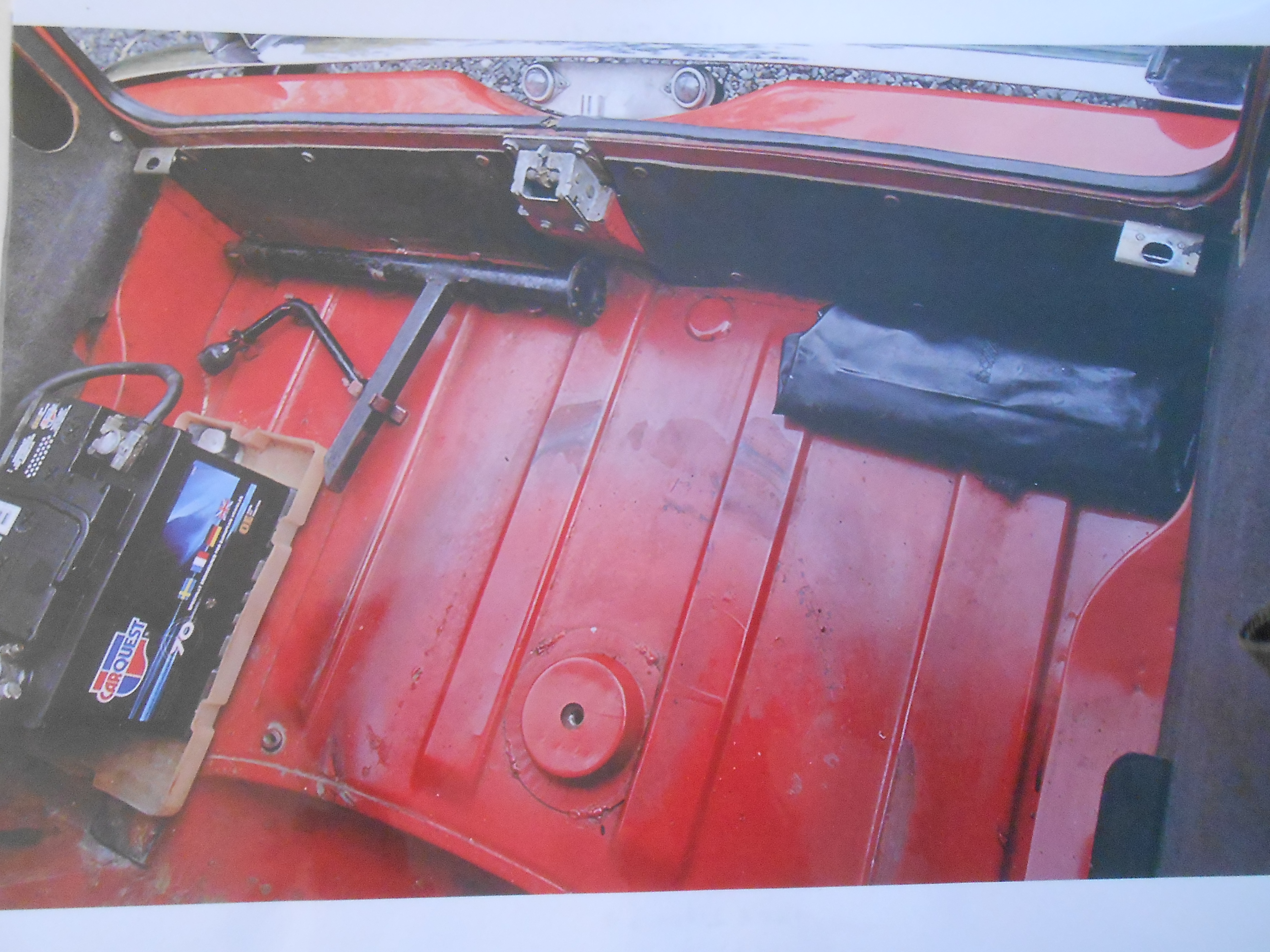

Im quite sure the large round holes in the back of the boot floor used the metal plugs always.
A quick check would be the period road test pics.
