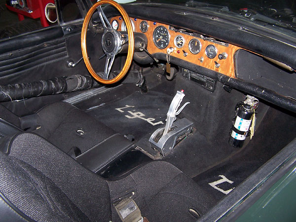

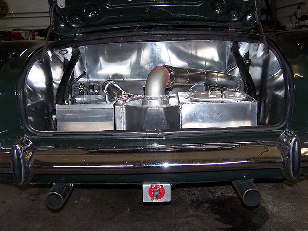

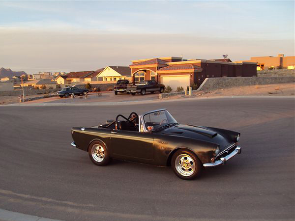

Updated piics of Jerrys Tiger
These are pics of Jerry's current setup
turbos, rocker covers, headers and the install.
