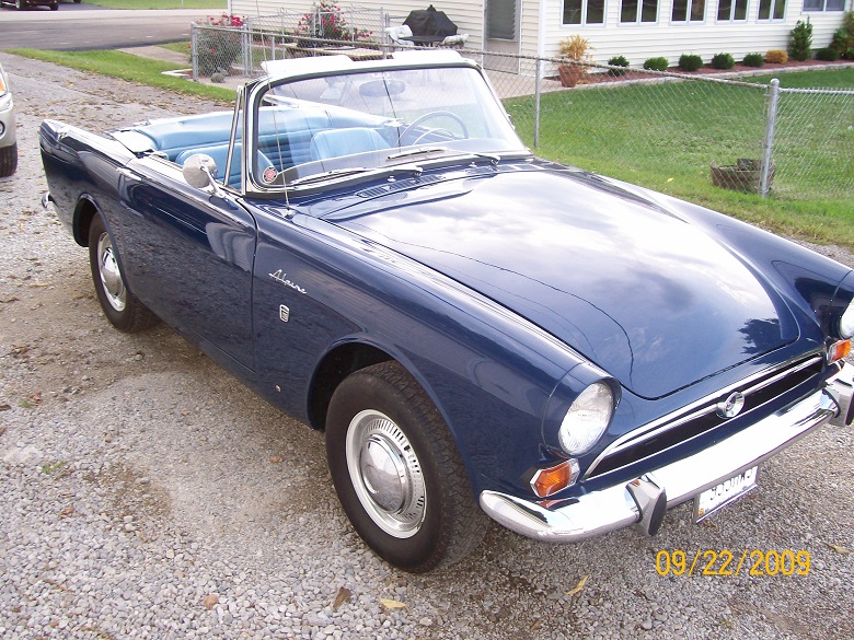

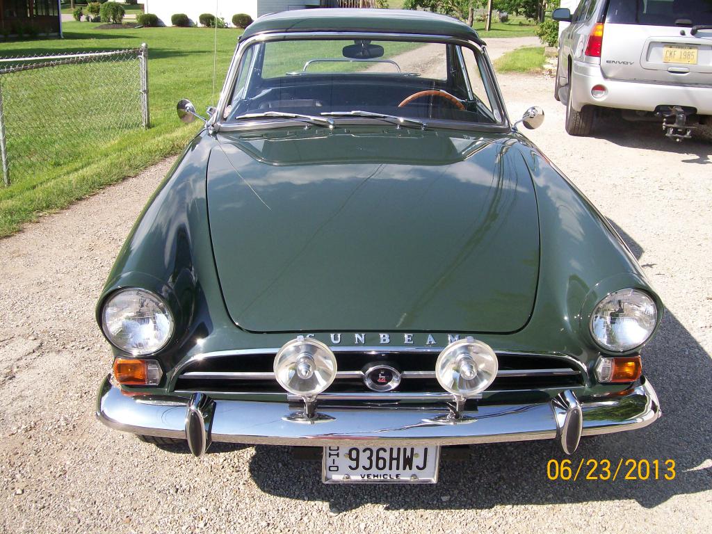

Doug Jennings installed one in the Blue car in 2009 and the green car in 2013. They fit at those times using SS rubber. That's the most recent we've done with no problems. I've heard that they have shipped a windshield for series 1 & 2 Alpines a couple times. There's no way they would fit a Tiger windshield frame.
