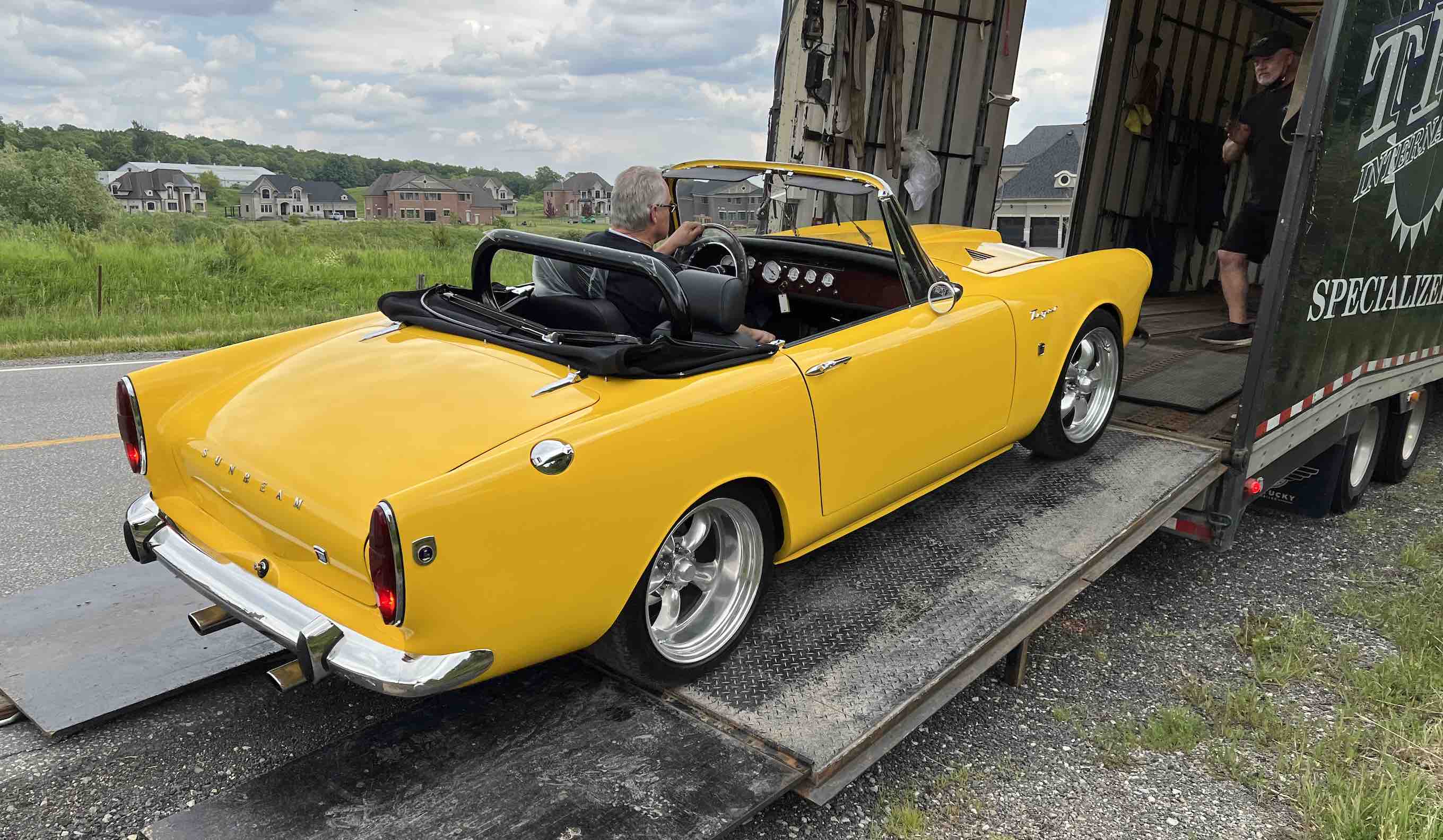

The car was delivered the other day. The restorer/builder did a fantastic job with it. The quality of the work is really impressive. I've only driven it up and down the driveway. I stalled it the first time; fairly hard clutch and I left the parking brake on. I think it is tradition from way back to do the first drive with the parking brake on, so that box checked. It is too loud for my liking, so I'll see about quieting it down a bit. Haven't had it up on the lift yet, but peeking underneath looks like adequate room for larger mufflers or resonators. It also is like new underneath. It has about 100 miles on it, so been through a number of owners, but not driven much.
Strange thing with registering it. I bought it as a 1965 (as advertised). If you see one of the posts above, it was originally a 1966 car in Ontario, then in BC. It went to the States and was registered there as a 1965 (the year it was built, not the year it was first on the road). When it came back to Canada (Manitoba) for some reason it stayed a 1965. At the license office the woman said "oh, this car is already in our system from when it was first registered here in 1966, so I'll use that information". I didn't think much of it until I looked at the ownership and saw it is now back to being a 1966.
A few little things need to be done to it before I get the Safety check and get it on the road. I think it is a beautiful car.
