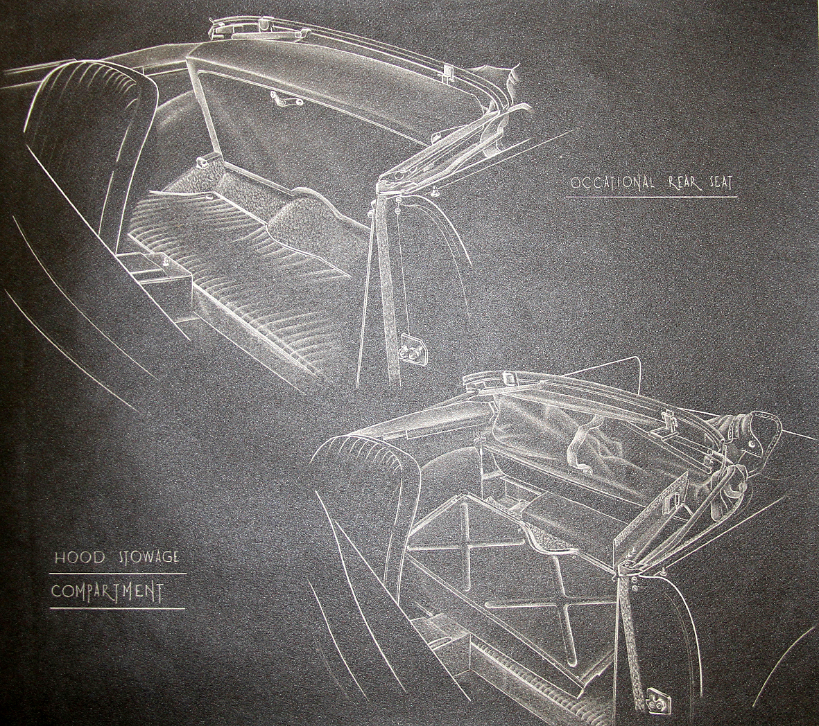

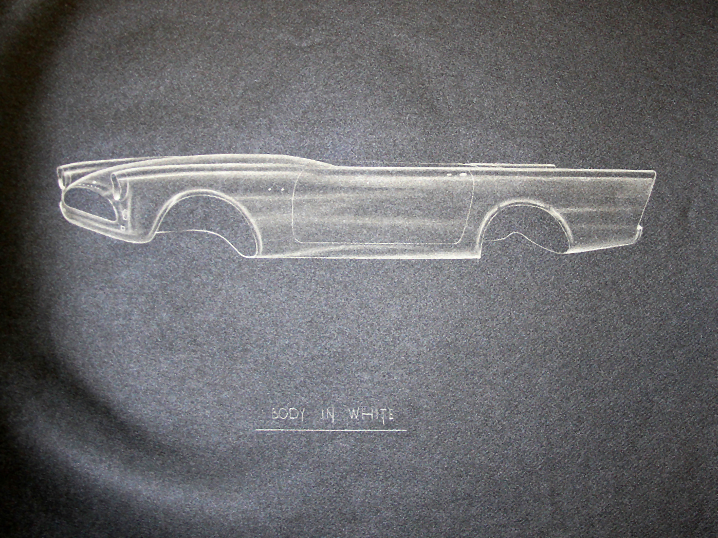

Pressed Steel built trimmed bodies for Tigs and Alps; some Alp pieces were left off by Pressed Steel on the JAL bodies going to Jensen. Jensen added the Tig specific body parts and made mods as required before installing the Engine, Trans and Suspension. Completed cars were inspected and transported to Ryton for pre-delivery prep and delivery to dealers or ports for export. Attached are two pages from the Pressed Steel proposal to Rootes for the Alpine that I photographed at the Rootes Archive.

Warren is right about the ledgers; occasionally they mention hardtops but maddeningly the color is only occasionally added as an afterthought apparently. There must have been discussion between Rootes and Pressed Steel about the Tiger body changes and they would have been documented on Pressed Steel drawings; They may exist but I have not seen them myself.
