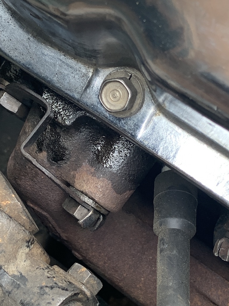

Just curious what others have found as their favorite tool to R&R the rear upper bolt on the left valve cover? You know, the fun one to remove. :mad:
Looks like there's a rubber plug on the firewall in the vicinity of the bolt, similar to the one for the rear spark plug. Didn't use it, don't like working under dashes either.
I found using a 7/16" drive socket with a 1/4" ratcheting wrench with electrical tape holding the bolt in the socket worked best for me. It's still a booger to get.
