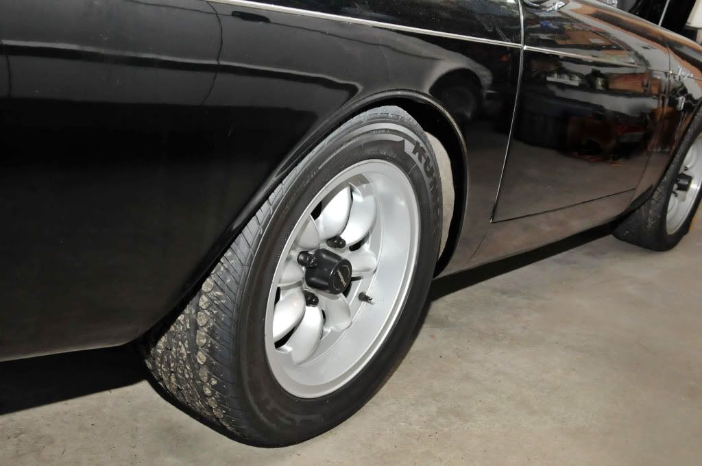

I'm running 225/50 R15 Kumho's on Panasport 7x15's. One leaf is removed from each spring and I installed 1.25" lowering blocks. No fender-rolling necessary since there is no rubbing, even with the blocks, unless I were to hit a massive pothole, which of course, I never would. :)
Sorry but I don't know the offsets. The rear "stance" would look better if it were wider but that would involve using spacers, longer wheel studs, and fender-rolling and I'm not inclined to "go there."

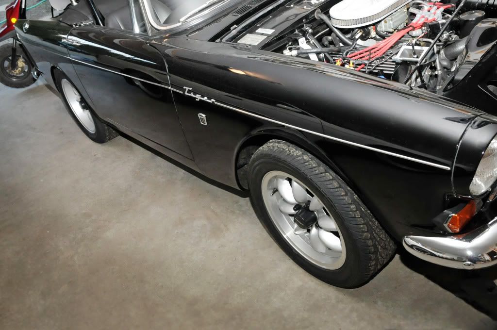

A couple of snaps. Hope this helps. Again, rear wheels are Panasport 15x7, older model, but I suspect the offset is 20mm, the same as in the attached application chart. I bought the wheels about 20 years ago, so they're not the current iteration. I'd prefer the look of a somewhat wider stance in the rear, but it's not worth the hassle to get there. The main thing is that this set-up works great for me.

This photo might give you a better idea of how the car sits, but I really need to do a full profile shot.
I, too, like the stance , but I don't remember doing anything to alter front ride height. Springs are either from CAT or Rick. There's about 2.25" between the bottom of the lip and the top of the tire. I'm almost certain we did not cut anything. Maybe it's sagging a bit in front due to the passage of time. (the car, not me) :)
