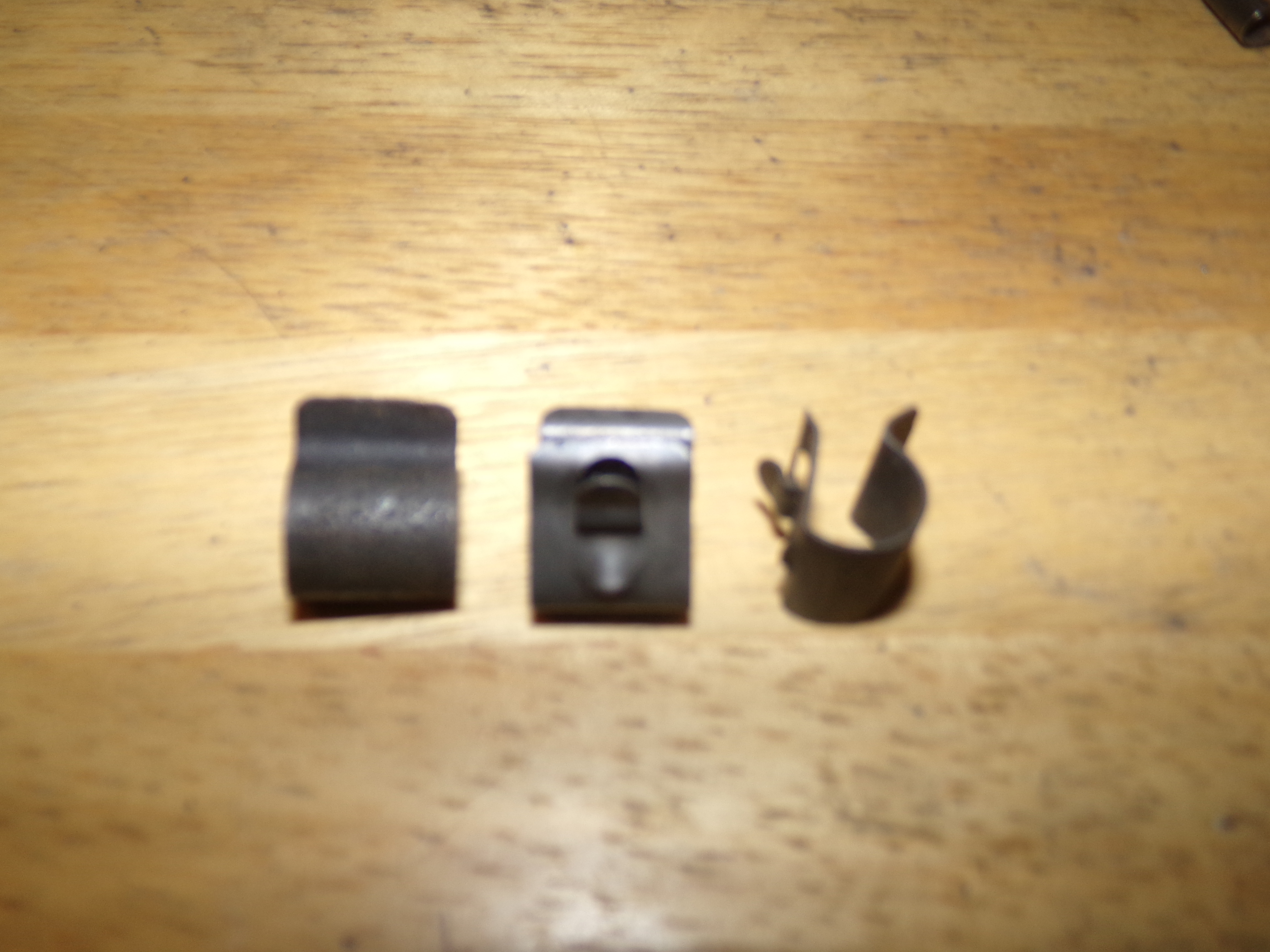

The first photo is of the clips used to hold the wiring harness to the inner fenders of the engine compartment. The small tab is inserted into the small round opening in the inner fender and pushed upwards to secure them. There were others that had a clip like a speed nut that were used in areas in the rear of the car where they could be pushed onto a flat surface such as the sheet metal of the opening where the fuel tank cross tubes are. Series 4 and earlier Alpines with a ballast resister had a wire that ran from the starter solenoid to the coil to supply full 12 volts to the coil for easier starting . They had a flat clip with rounded corners that pushed onto the front flange of the bulk head.

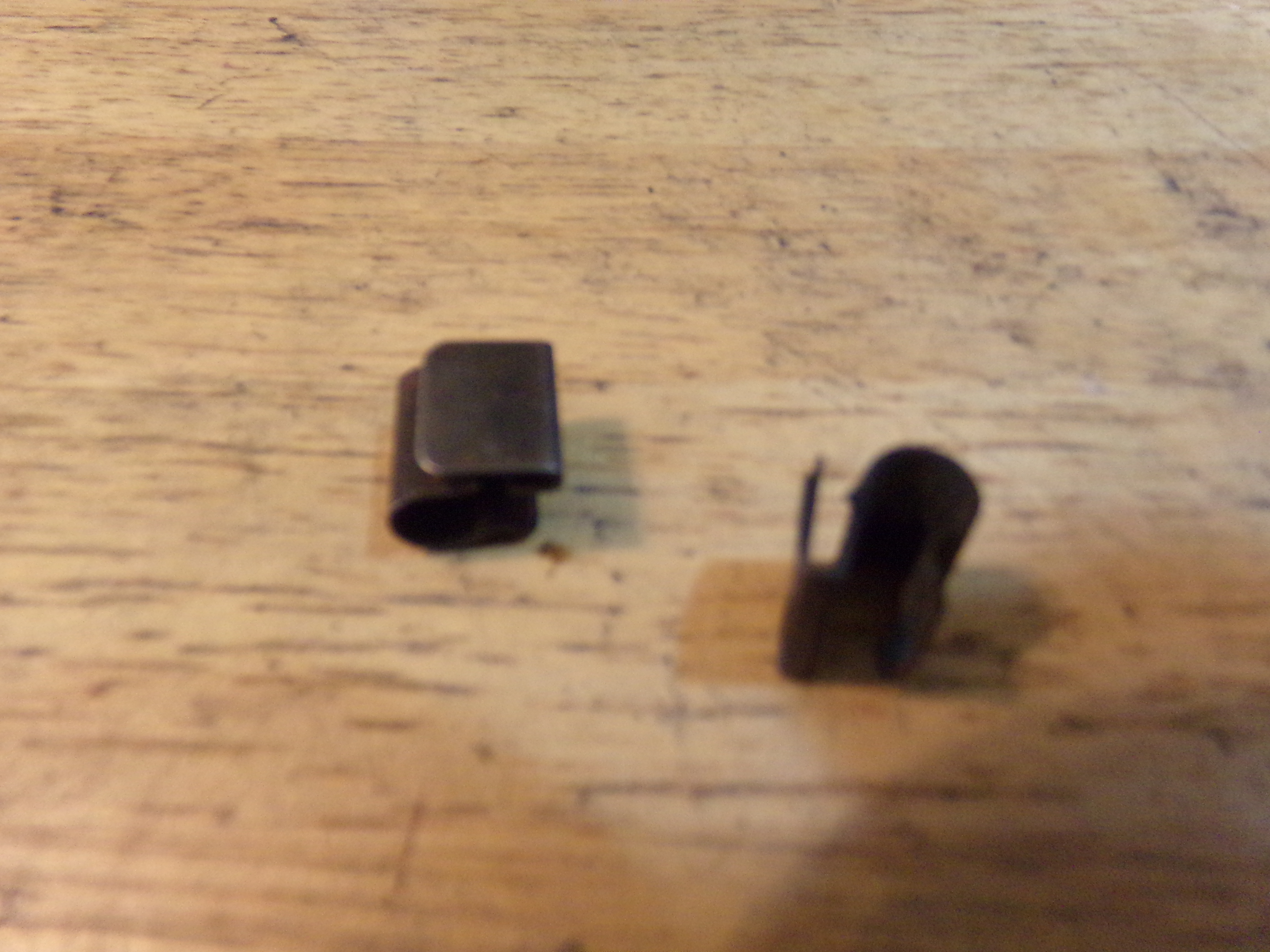

The smaller "push on" type clip was also used on the wiring for the horns and one for the w/s washer hose from the reservoir at the firewall...
