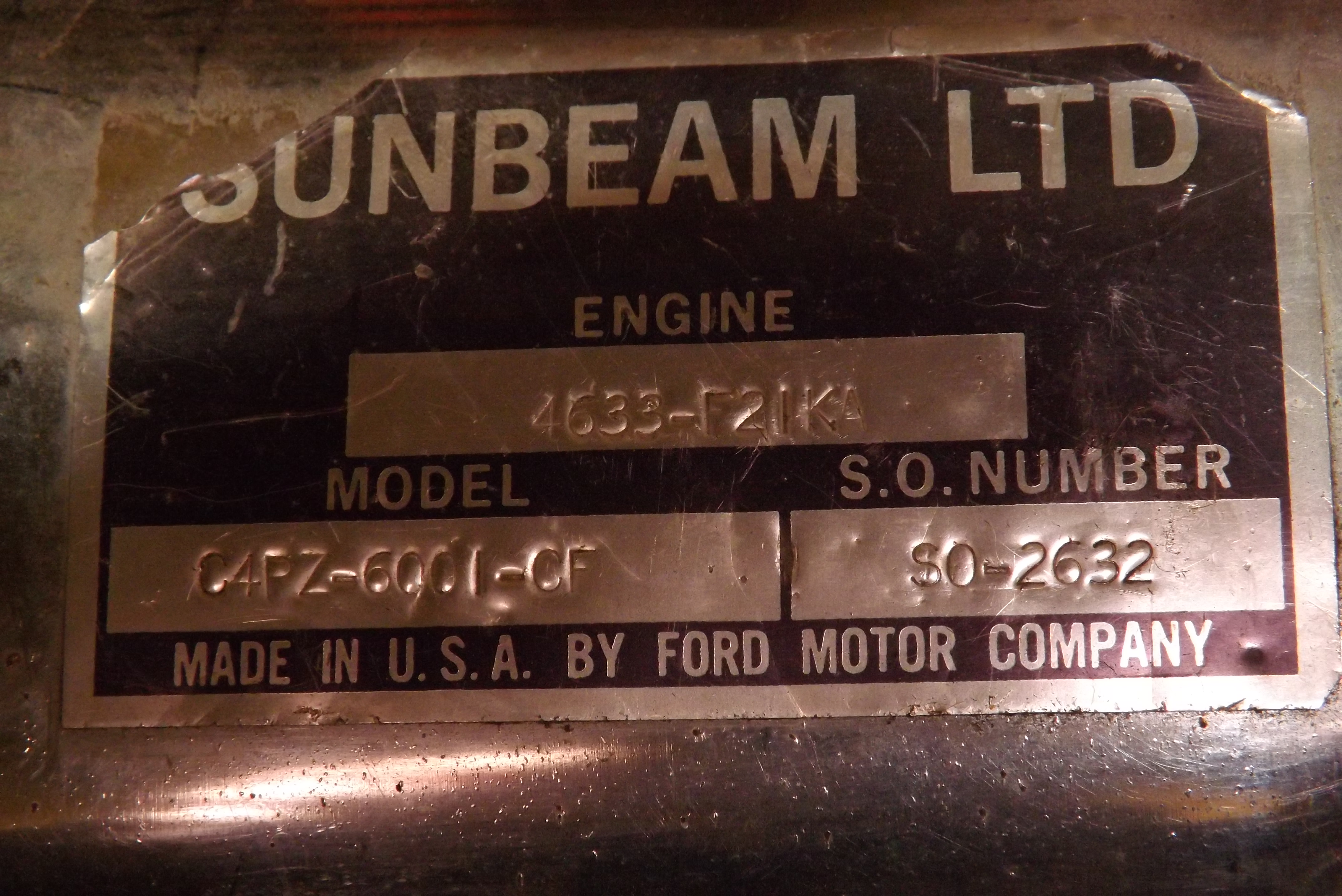

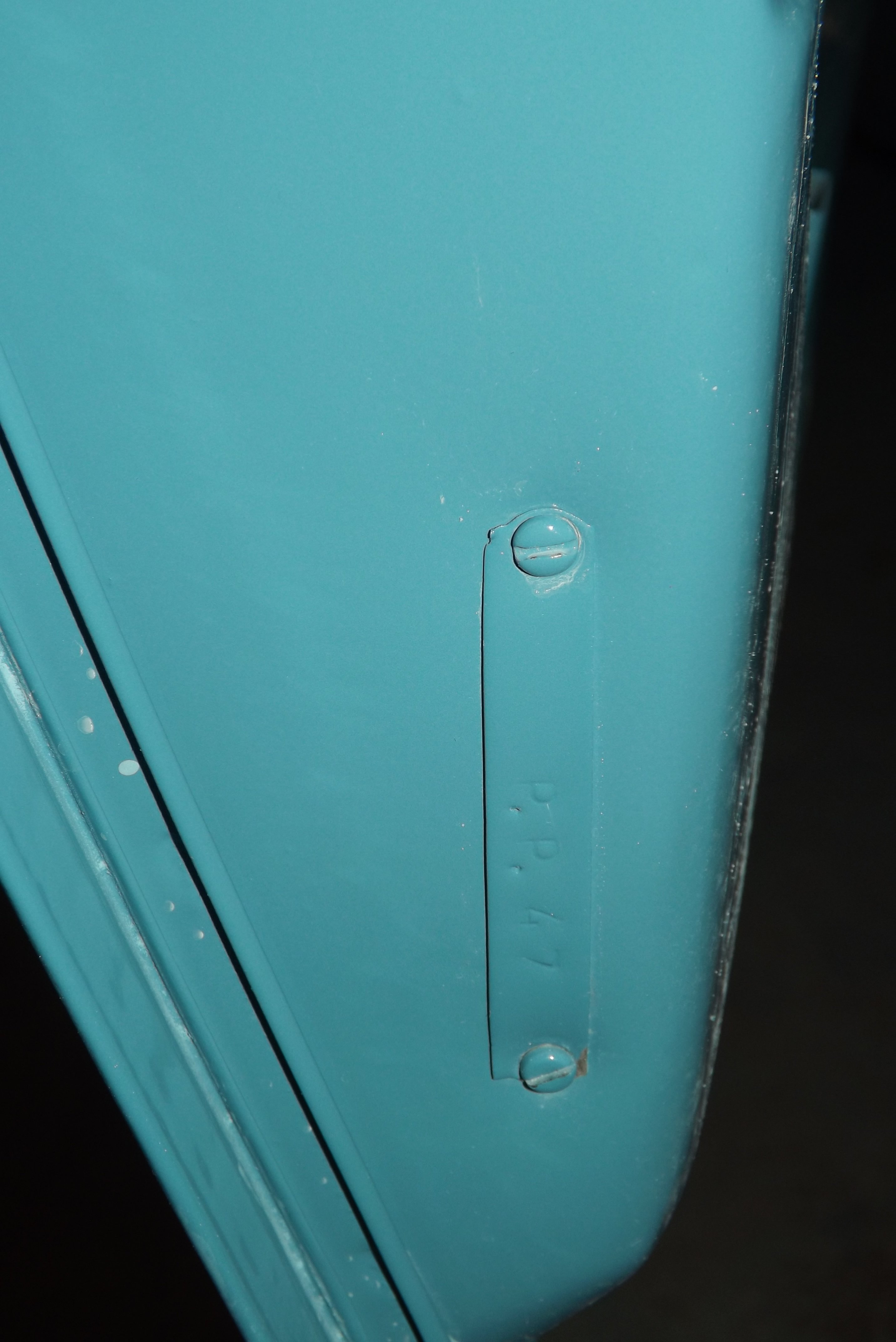

You'd think Tom Hall would have higher standards... on a different note... I had the PP MK1a inspected and Tac'd by Larry Atkisson (mentioned prominently in the BoN) I supplied copies of the ledger, pictures (attached) showing the original rivets in the chassis tag. The car had it's original rear axle, lock and keys and I had the original valve covers with the original sticker. The engine was replaced with a slightly later 260 and the gearbox was also later than what would have been installed in the car originally. There was no JAL tag and the car never had one as it was a prototype. It does have a tag on the LH door denoting it's status as a preproduction prototype.
The car rec'd it's Tac and then I got an angry phone call from Tom Hall stating that the certificate should have never been issued. I presume this was due to a lack of a JAL number, but now seeing how other cars have been tac'd with incorrect or missing elements, I'm not so sure. Anyway, the Tac stood. The car was obviously what it purported to be and the various elements of the car showed that. It was also a car well known to Norm Miller (still active at that time). You can see from the photo of the vin tag that there are bits of the original Mediterranean blue color visible, just another confirmation that this car was what it purported to be. the entire process showed me just how political the TAC process can be....
