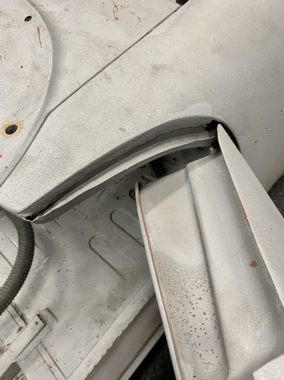

When you say underseal, do you mean the black caulk/seam sealer in the joints which I just spent a week with a heat gun and scraper removing?
If I understand correctly, the inside of the channel in the attached photo gets painted black.
Please confirm.
Thanks
You got it. wait for a picture as the paint job is kind of sloppy when down right and I think that it's more matte vs. gloss. There will also be a piece of trim in there too.
