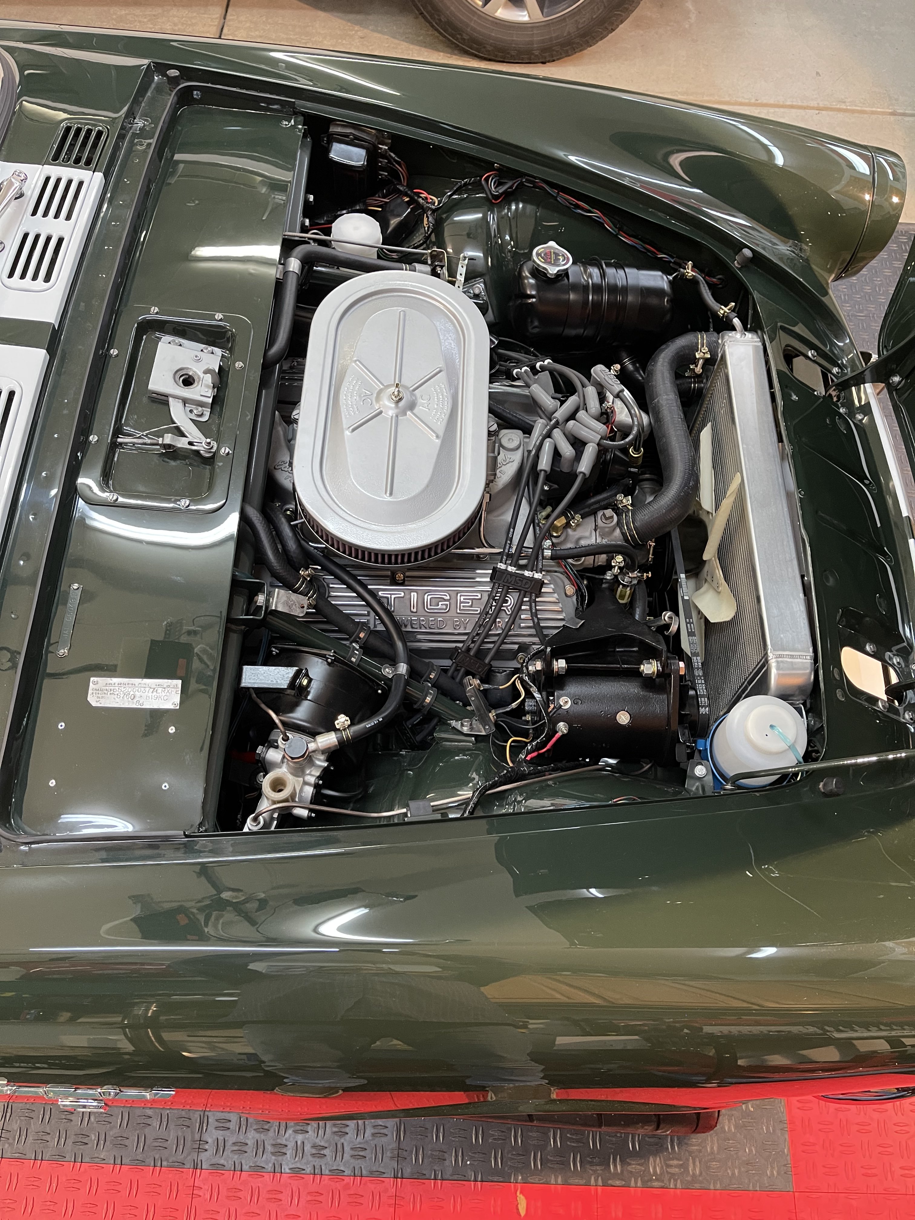

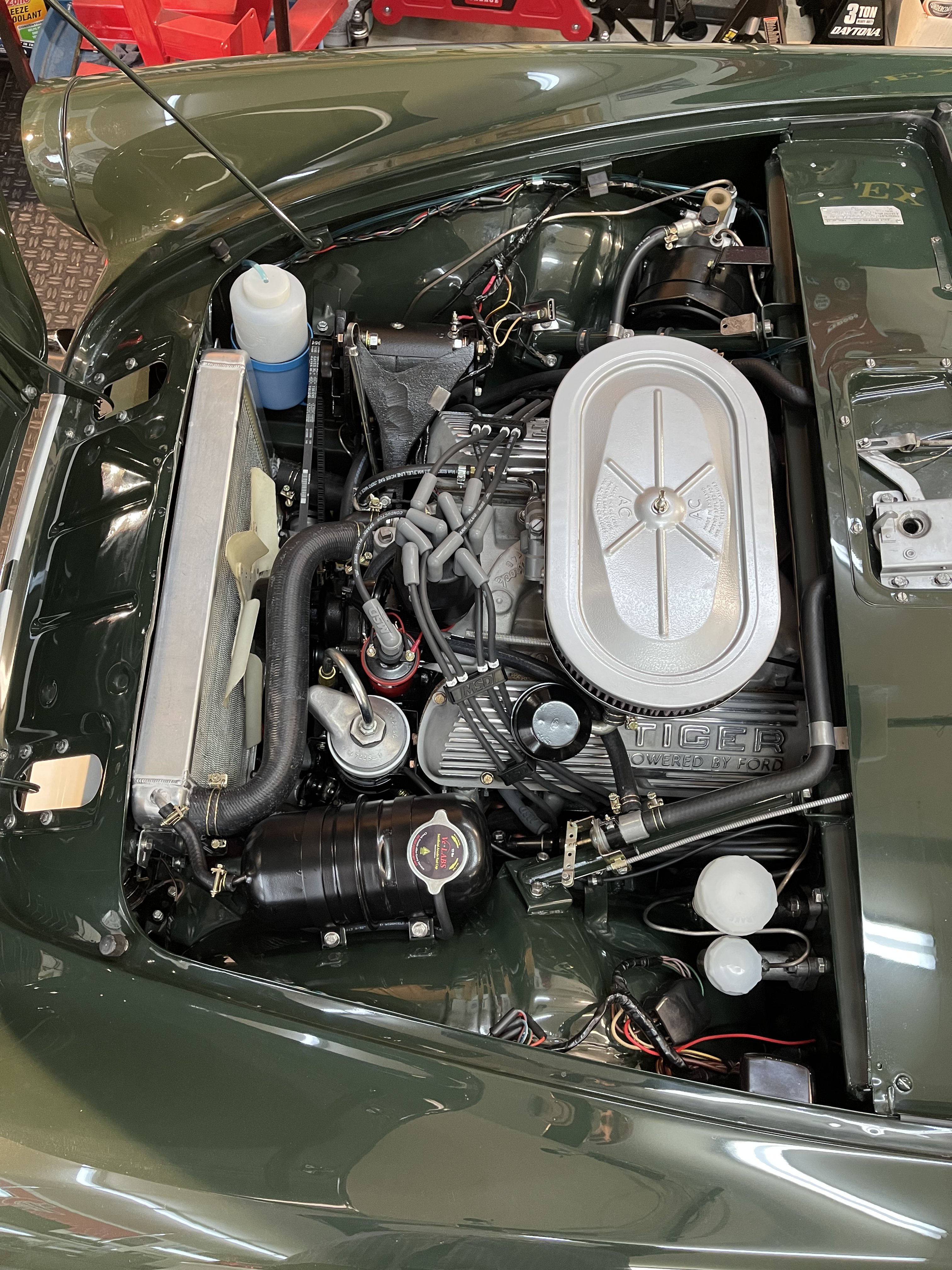

I'm in the last stages of a complete, rotisserie restoration. Not a bolt, nut or wire wasn't cleaned or looked over. I've followed some of the threads here regarding originality and following a very regimented procedure to stay true to the brand. I did not build a resto-mod in any way, however there are some personal, yet tasteful touches of my own. I didn't build it to garner 100 points in a Tiger originality contest. I built a bad ass 289 HiPo motor with headers, F4B manifold, Holly carb, MSD distributor, 8mil wires, Flowmasters and steel exhaust. I restored my own dash with burl veneer, put the steering wheel back together from around 6 pieces, and the clock is a Smiths quartz in the wrong hole, far left. The motor dynoed at 302hp and 326ft lbs of torque, rebuilt trans, rear end, front suspension, rack and pinion, aluminum radiator, everything has been massaged. Since I'm just a plumber and not tech savvy, my FB page has a lot of pictures of my year of therapy. Please feel free to peruse my page, its under Gregory Petersen and I'm a member of the FB Rootes Group page. Thank you for reading my post, I look forward to our future correspondence.

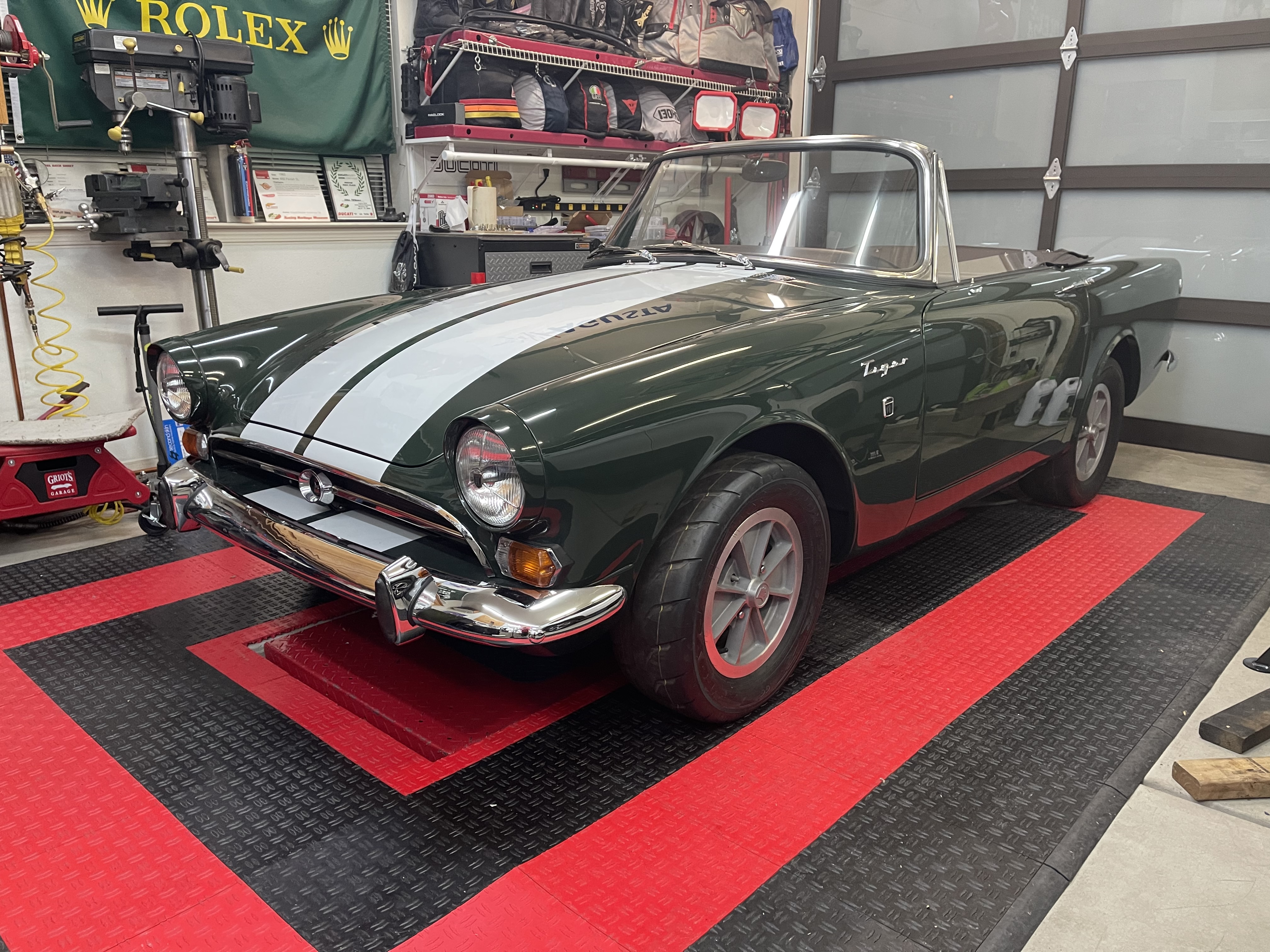

That looks like 100 points to me. I realize not everything is bone stock but it looks fantastic!

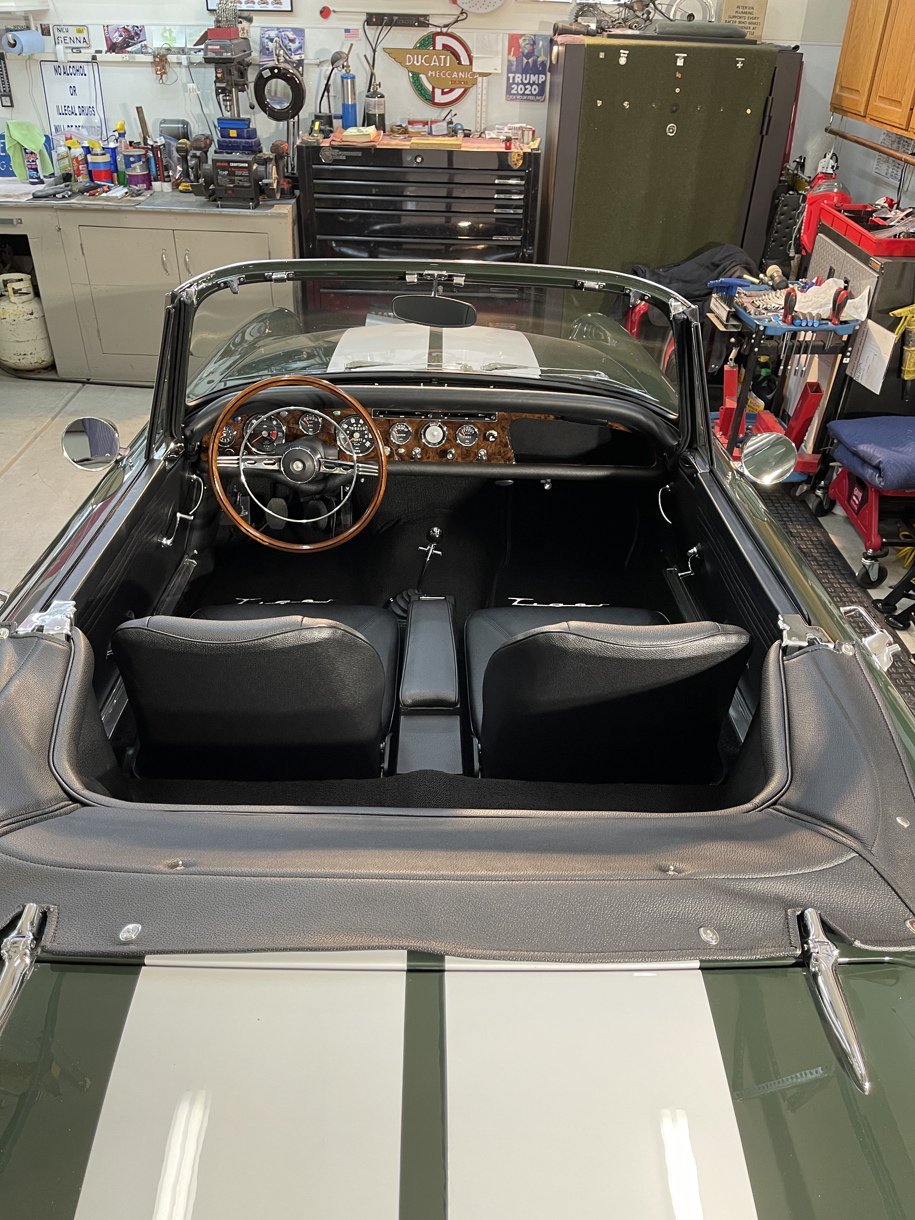

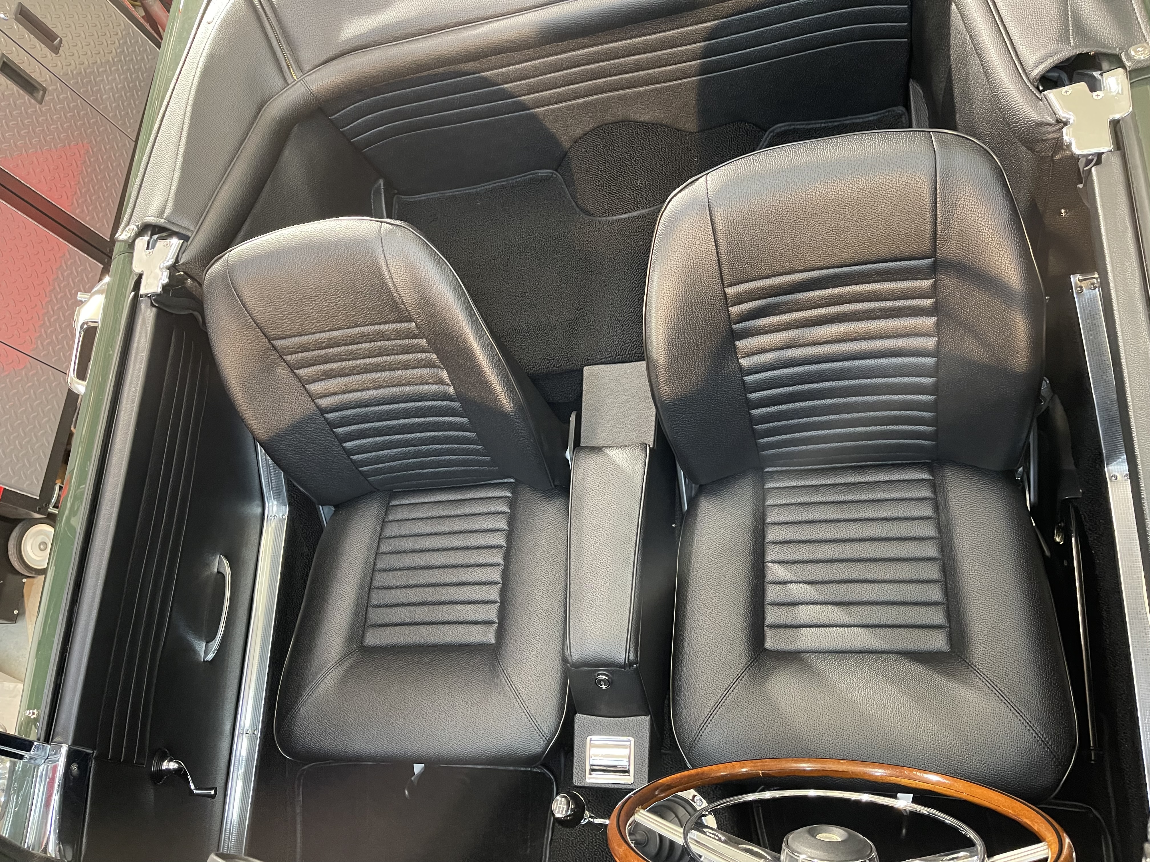

I figured out how to load pictures!
That is a beautiful and yet aggressive Tiger. Its how I might complete one (in my dreams with unlimited skill and or funds and fewer sentimental attachments than I had ). Just a great car. Congratulations! Love the green. Love the stripes, the .... sheesh nice. 👍🏻

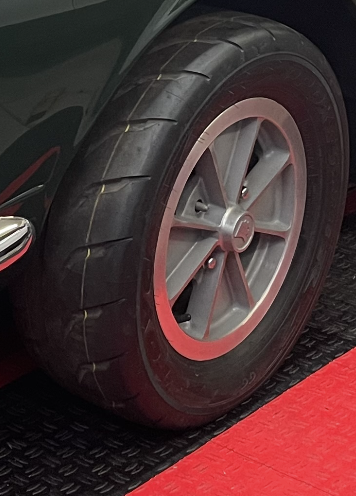

What is the Brand and size on those tires?
Toyo Proxes R888r.. very good track tyre. I ran them on my race Alpine. They are road legal.
A caution they pickup and throw anything on the road and will sandblast the trailing edge of your wheel arches

Thanks everyone for the nice feedback on my car! I left those lug nuts off because in case the alignment shop needed to pull the wheels off. Those are original LAT9 lug nuts that I had re-chromed and I'm sure impossible to find. They are on and torqued now.
I put 8 miles on it last Friday, open headers! As soon as the weather improves, I'll trailer into Reno for the exhaust. Amazing how much power this thing has, I never got out of second gear. I'll get started on the folding top pretty soon too, but I need a toasty garage for that.

With those tyres I strongly suggest you add some clear film on the trailing edges and inner hard lips before they get sandblasted by what those tyres throw
