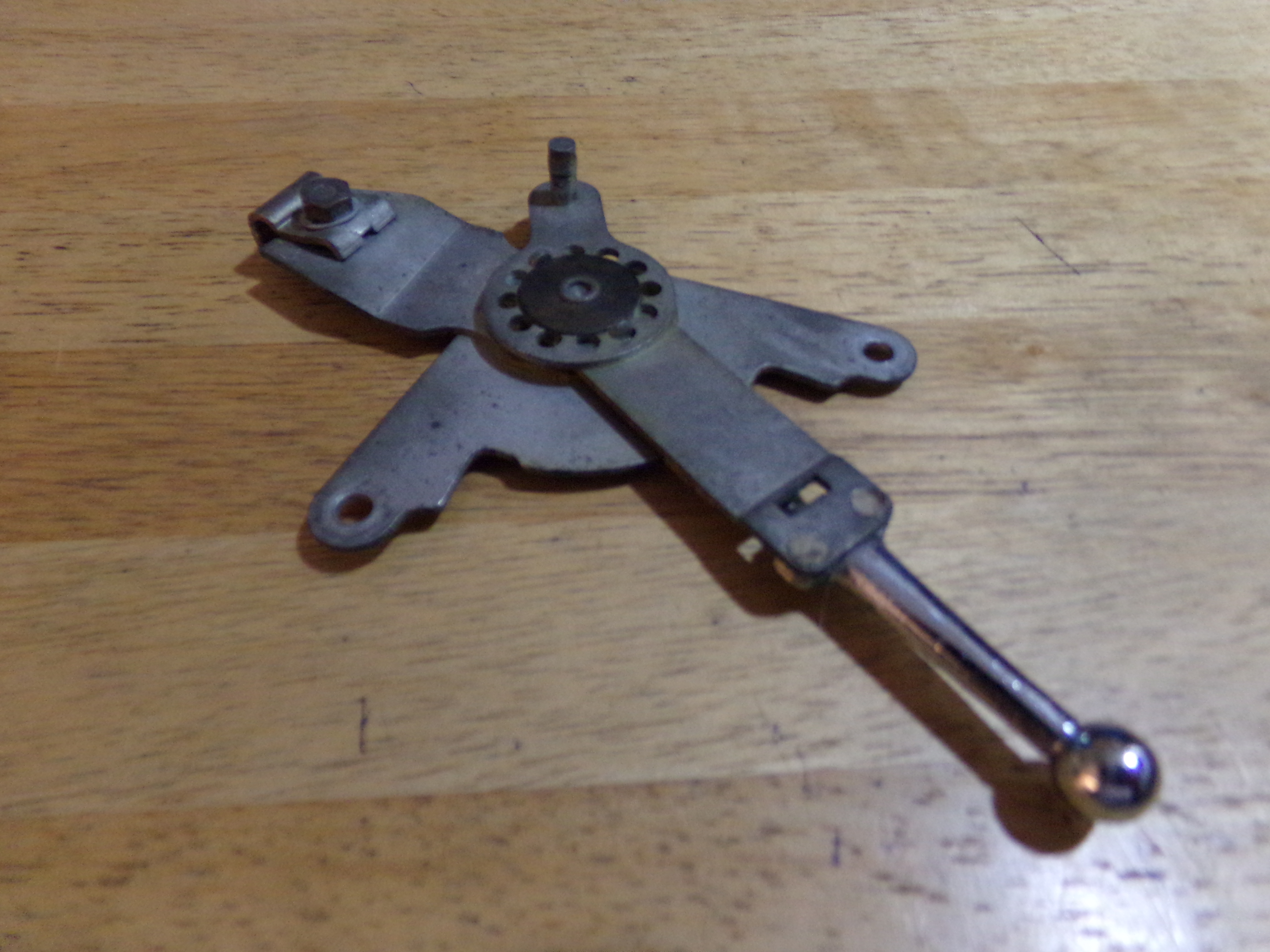

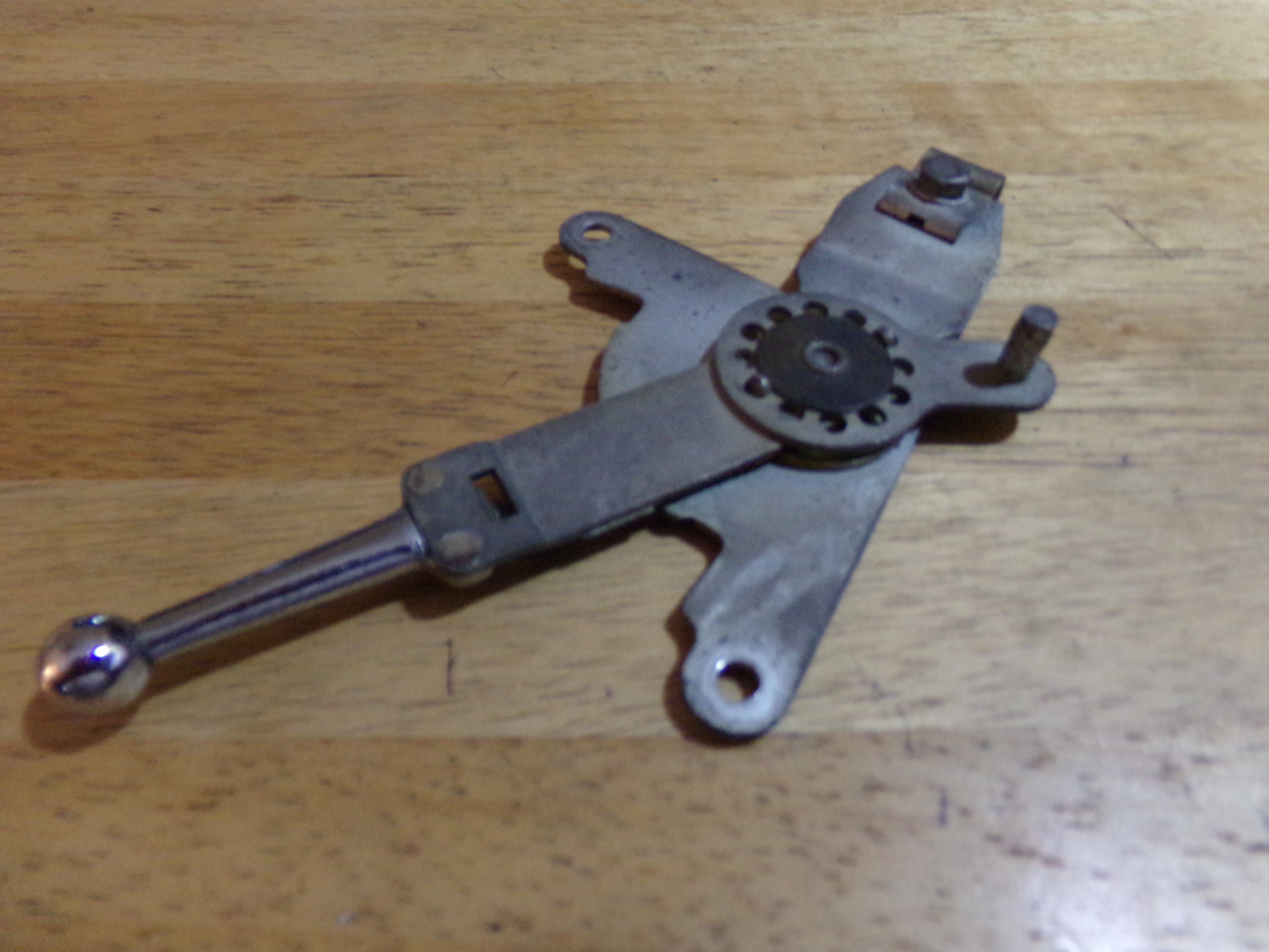

A good rule of thumb is cars with 2 speed fans have the plastic knobs, Have a MK1 Tiger in the shop right now in the 900's. (Dec '64) single speed fan, chrome ball knobs.

The round, chrome knob has female threads that fit onto the matching, threaded male lever. The end of the knob has a phillips 'cross' cut into it to make tightening and loosening the knob easier.
