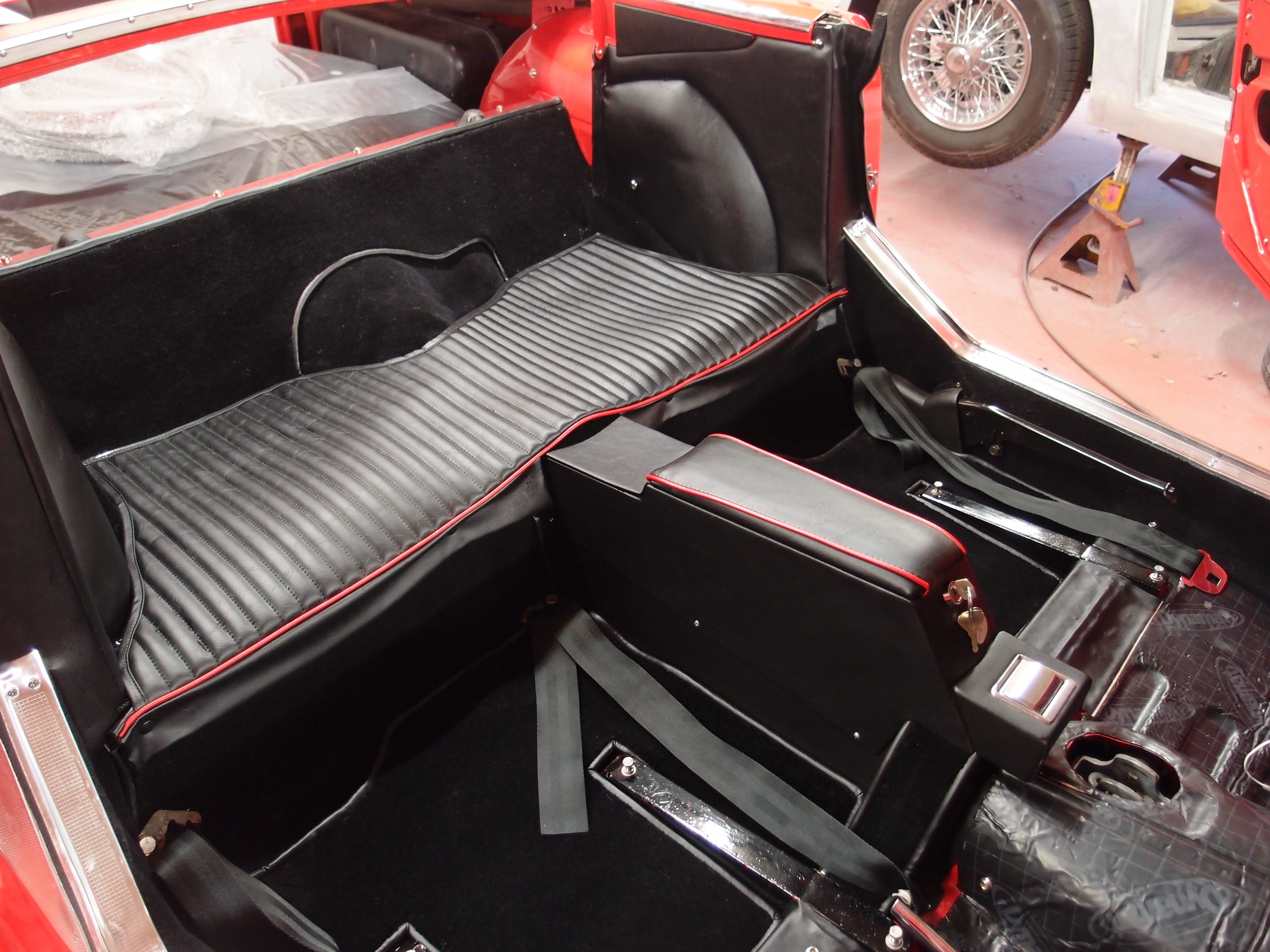

Most of my experience has been with the later MK1a and Mk2 so I have a question for the folks with early cars. I'm installing the rear deck padded occasional seat... originally this car had carpet. I do have the original heavy tarpaper and jute pad and it doesn't have a holes for snaps at the rear portion of the platform, so I am wondering how the carpet (original) or the padded seat is secured at the back end. The front has 4 snaps which I have installed. Is the pad simply secured (held in place) by the folding top door?
1,842
I didn't use back snaps because the hard top never comes off.

Mine has the rear snaps x 2

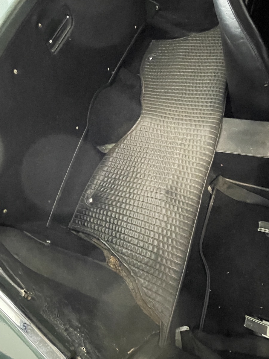

If you pull up the TE/AE web site and click on the judging guidelines for stock Tigers you'll see the photo for the cover shows two snaps. These guidelines were put together by several clubs.

Yes, the 2 snaps on the rear of the horizontal parcel shelf are the factory setup, so no need for you to check it up.. only 1 respondent seemed to be confused by a question about originality vs how they choose to do customisation

Thanks for the kind words about the judging guides. Both the Tiger and Alpine guide took years of work and the contributions of many people. I wish the Tiger manual had more detail, but that was our first effort. Making updates/changes is a time consuming process, so we have been saving a bunch and hope to get them done this winter.
As for the snaps on the rear deck pad, the Tiger manual only provides a photo, which shows the two rear snaps. The Alpine guide provides more info but failed to mention the snaps and focused primarily on the heat sealed seams and pleats.
