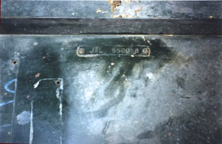

Using the STOA single look up of a TAC shows Certificate No.134 was issued for B9470061 in 1994. The attached image shows this Tiger's scuttle with JAL in place but not the VIN plate. The image is well over 10 years old.
Well, now I know the story behind the JAL tag! it would appear that someone wasn't happy with the original chassis number and made up a new tag with incorrect number and got it registered in a no title state... Now Bruce Paul can be informed what the real chassis number is for his car and that it has been tac'd in the past. He can also probably figure out who changed it between the owner who had it tac'd in '94 and the entity he bought the car from.

From Graham we know that the car was tac'd in 1994, so it was titled/registered as B9470061 at that time. from the pic Graham supplied it's obvious that the car wasn't restored and the outline of the original vin tag was still visible. Whoever changed the vin tag, did it after 1994.. Graham should be able to figure out the name of the person who had the car tac'd.

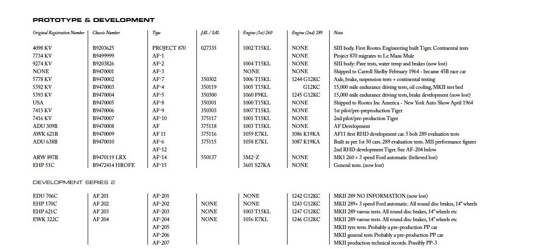

Returning to the subject of the correct B9470001. This extract from a STOC 2020 Register of Cars shows what I believe the first 10 VIN numbers went onto. Blanks are 'don't knows'. This information was gathered over many years from Rootes Experimental Department records, first hand accounts , VIN and SAL plates seen and close inspection of development work on them. It helps to have B9470002, B9470007 and B9470010 here at my home!
A quick mini-bio. It is thought the order of vin numbers at the outset happened once an AF build was completed and ready for road testing work (and purchase tax paid!). B9470001 to B9470005 had all been built and given VINs and license numbers by mid-February 1964. This group included the Shelby race car, the two 15,000 miles endurance test cars and the New York auto show Tiger.
The next AF’s, 9 & 10 / B9470006 & B9470007 - the pre-production pilot testing twins, were on public roads in the UK and Europe by mid/late March.
The last of the batch, B9470008 to B9470010 were also finished in March.
