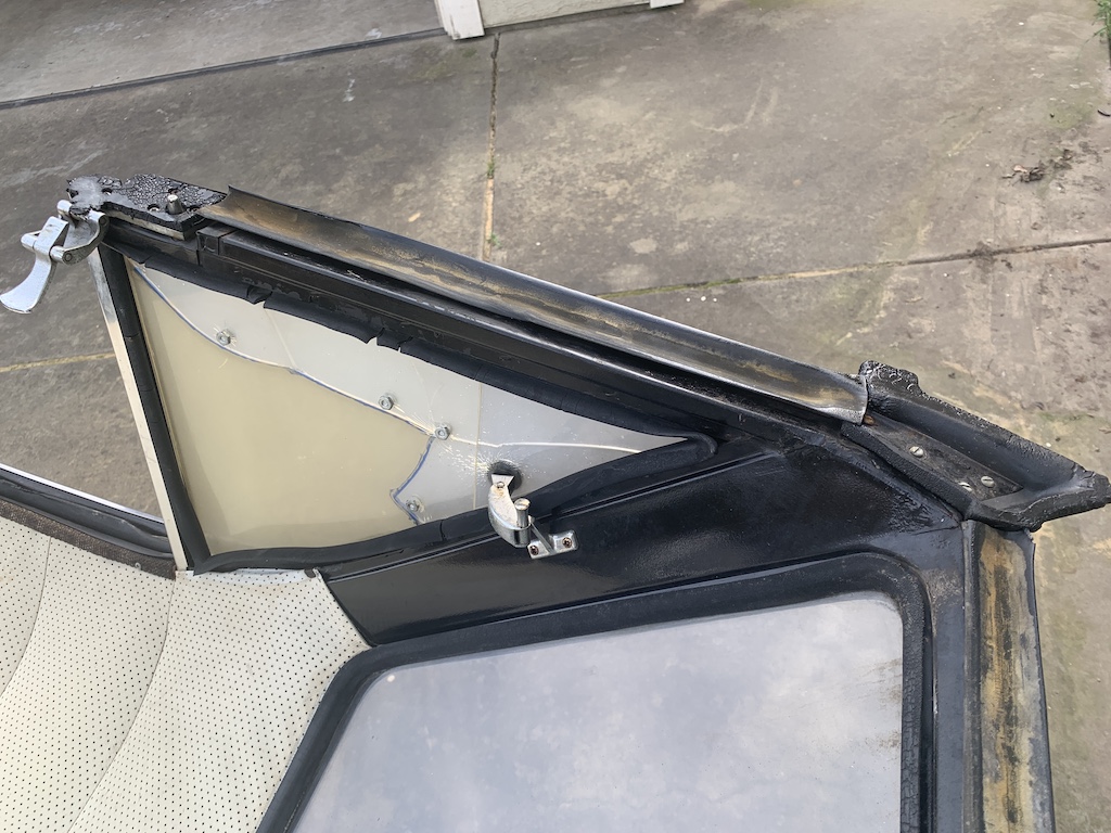

I noticed I have 2 different inside door handles. pretty sure the one on the right is not correct, and not sure what it is from.
If any anyone has a door handle for sale, please let me know.
Thanks, Ken

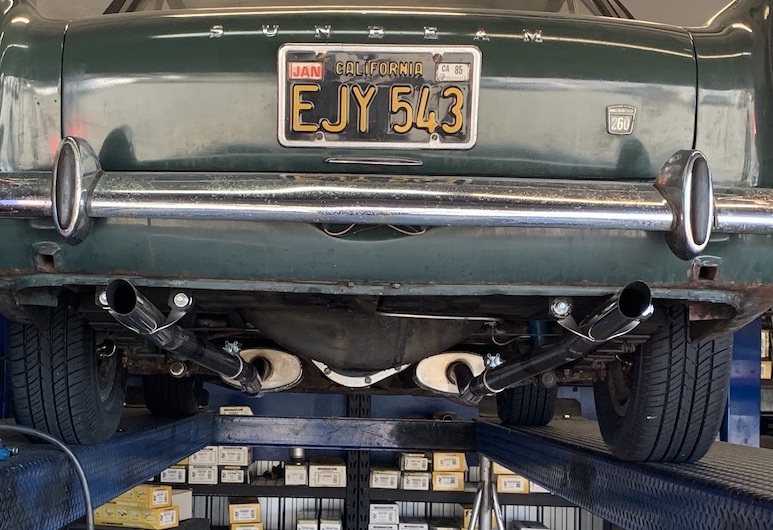

Took car to the exhaust shop to get the left tailpipe adjusted so that it and the muffler are at the same angle. In the before picture you can see the left muffler being pulled up more than the right side when tailpipe is bolted up. To me it seems like the left tailpipe has about a 1/2 inch less depth of the bend below the rear end housing, and a slightly less bend down out of the muffler. So it was cut right behind the muffler and re-welded. Not perfect, but better than it was. Not sure if all the SS kits are like this, but mine was, and had to pay extra $ to get it leveled out. The fit up front is great and it doesn't rattle at the x-frame holes.
It sounds good too. On a scale of 1 (my 13 Honda Accord) to 10 (427 Cobra with side pipes) I'd rate the noise level around 5, maybe a 6 around town. Neighbors will know you're coming. Noise seems pleasantly lower at freeway speeds, and no droning.
Been meaning to speak to Rick about the pipe bends. It's a good thing we have a conduit bender available. They are all out (the pipes) just enough to be frustrating. After 4 sets recently, I can say that the errors are not consistently in the same spot but always there just the same.

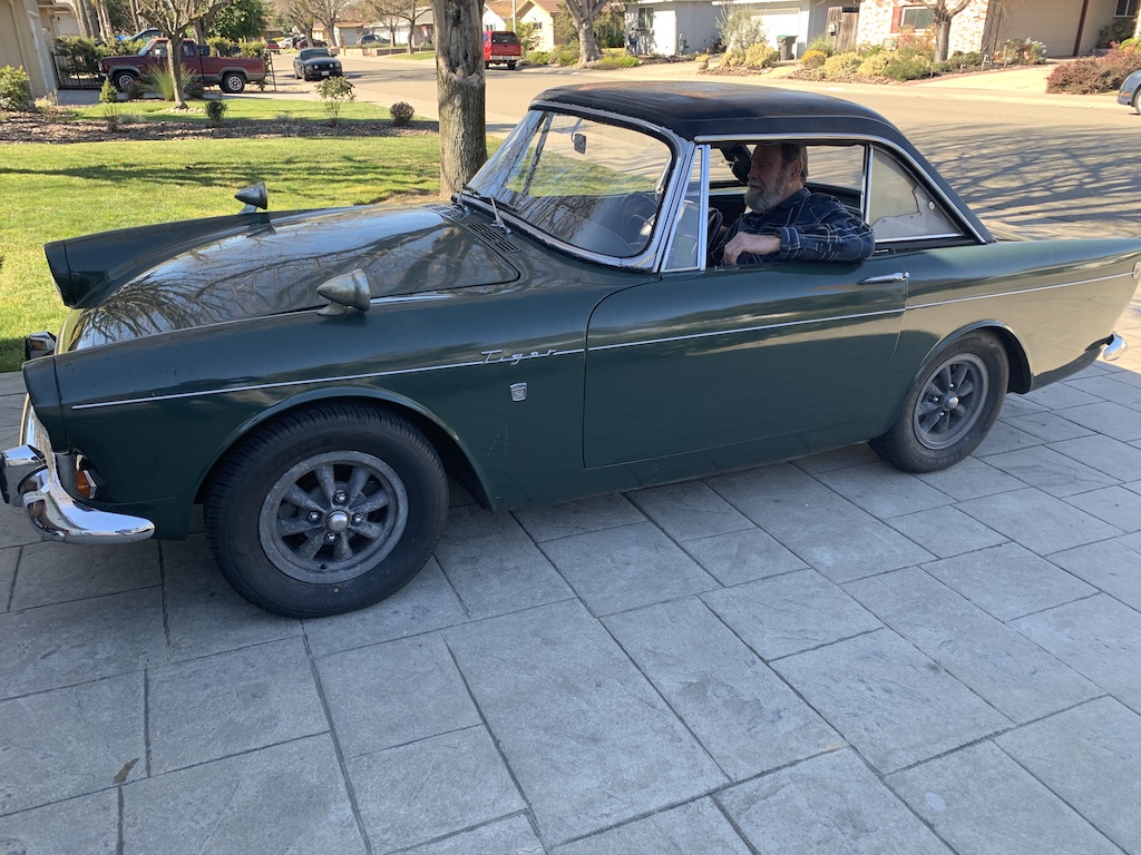

Original Owners
I drove the car about 40 minutes away to the original owners house. Rich and Jeanette owned it from 65 to 75. They talked of all the trips they took to the California coast in it, and mentioned how bright and shiny it use to be. At the time they owned a VW bug and later got a Toyota Corolla before selling it as it didn't make much sense with their 2 boys. They sold it to the high school kid across the street, who drove it for another 10 years before parking it. He was surprised to see the CSEA sticker still on the wing window, he worked for CalTrans.
While looking inside the trunk I pointed to where the tool roll use to be. He said "wait a minute" as he headed to his garage, which got my heart going. But, didn't find it, probably long gone or buried in house where they've lived 55+ years.
Gave him a ride, but I think the fuel gremlins started coming back while driving, but he still got a kick out of being in his old ride. Told him I'd bring it back when its running better.
Real nice couple and enjoyed the visit. Thanks Rich and Jeanette for taking good care of it then. The only casualty they had was slowly rolling it under a pickup truck bumper when she took her foot off the brake while reaching for something on the floor. That's probably when the front Sunbeam letters were removed.

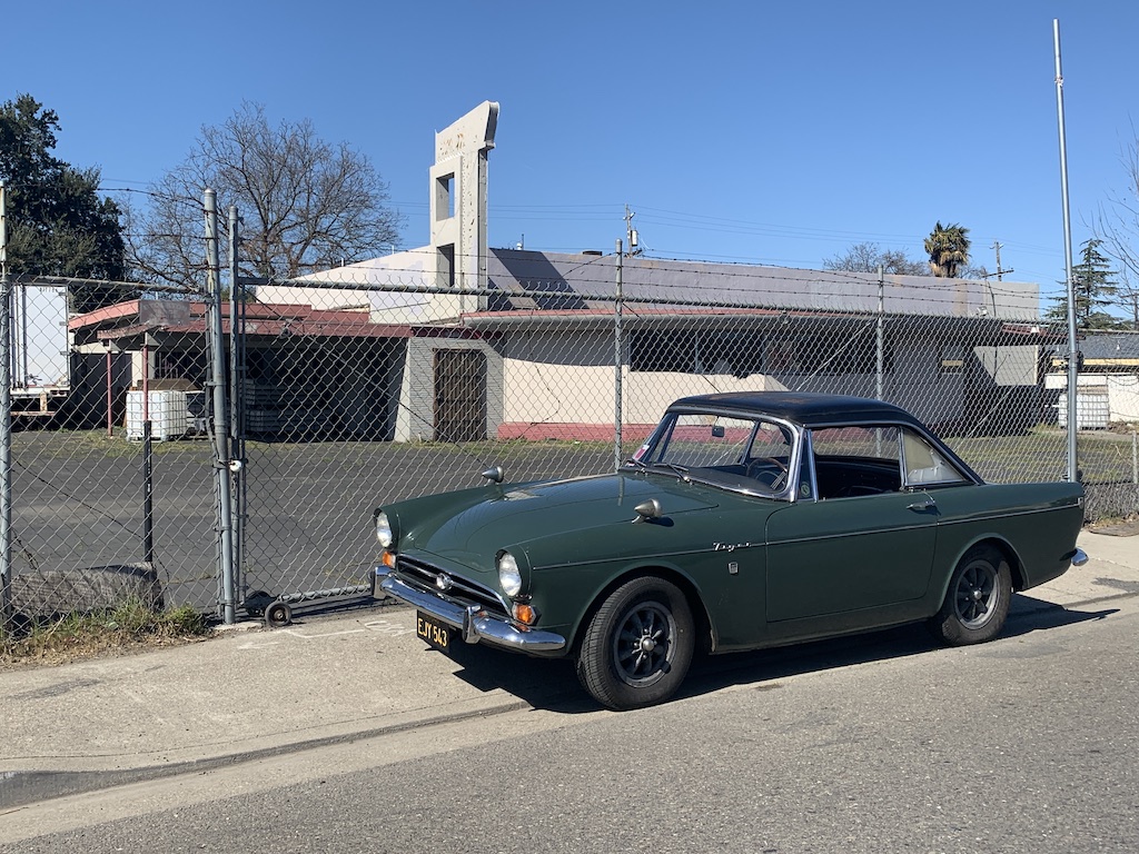

Took the Tiger back down to Stockton today to visit Rich, the original owner again. The car problem last time turned out to be the battery was so far dead the generator couldn't recharge it. Generator and regulator checked out fine, just the battery was replaced. I took it to an old school electrical guy to verify, and he said it's getting 15 volts to the battery and regulator may need to be adjusted down when the weather warms up. Going to install one of the voltage gauges that Jim (66TigerMK1A) has available so I can keep on eye on it.
His son Dan was there and he took his dad's old car for a drive. No luck in finding any old parts, docs, pictures, but they will keep looking.
Next week or two I'm going to drive a bit further to Pleasanton to visit the second owner, Rick. He's now a retired attorney who drives a Turbo Porsche I hear. Maybe he'll know where that tool roll or the hubcaps are, and tell me a little more history of the car.
While in Stockton I took a picture of the old Crown Motors building where the car was first sold. Rich went there in 65 to buy an Austin Healey 3000, but didn't like the lack of room in it. He tried on the Tiger instead which fit him better and definitely sounded better.

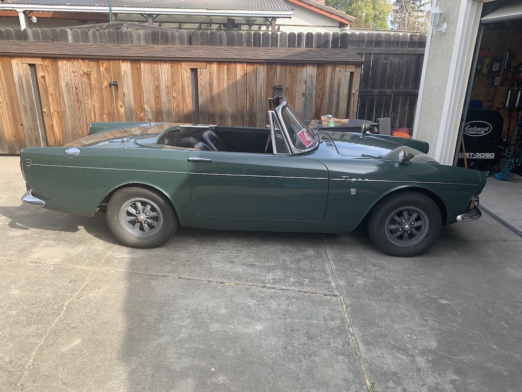

Top Off

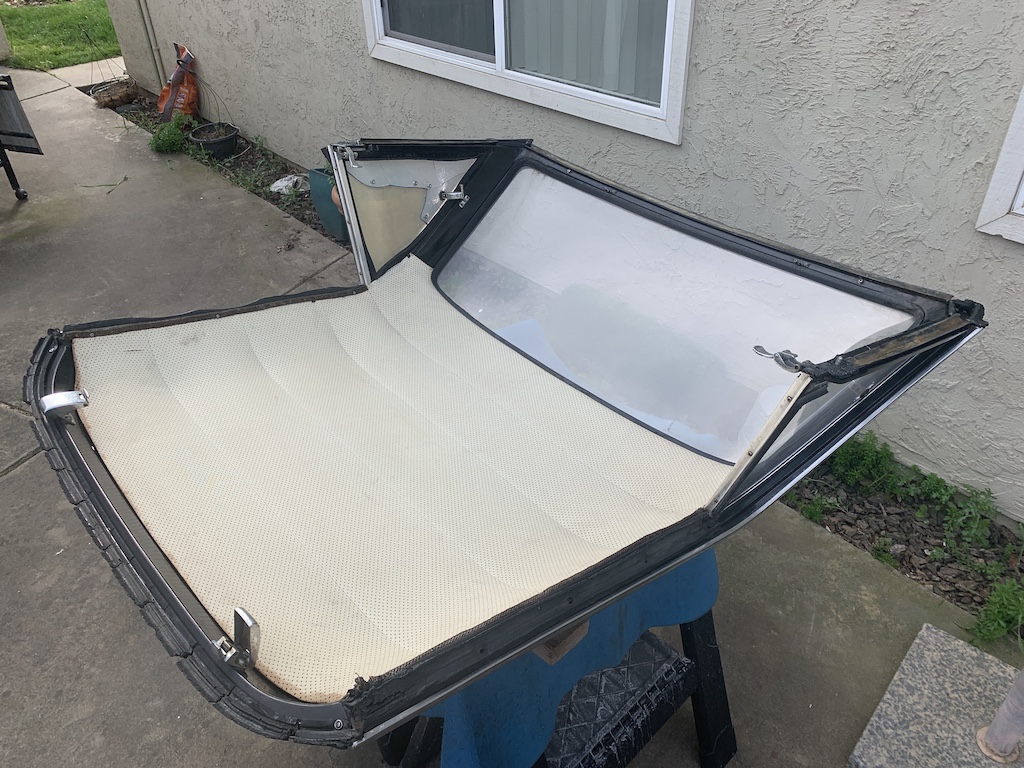

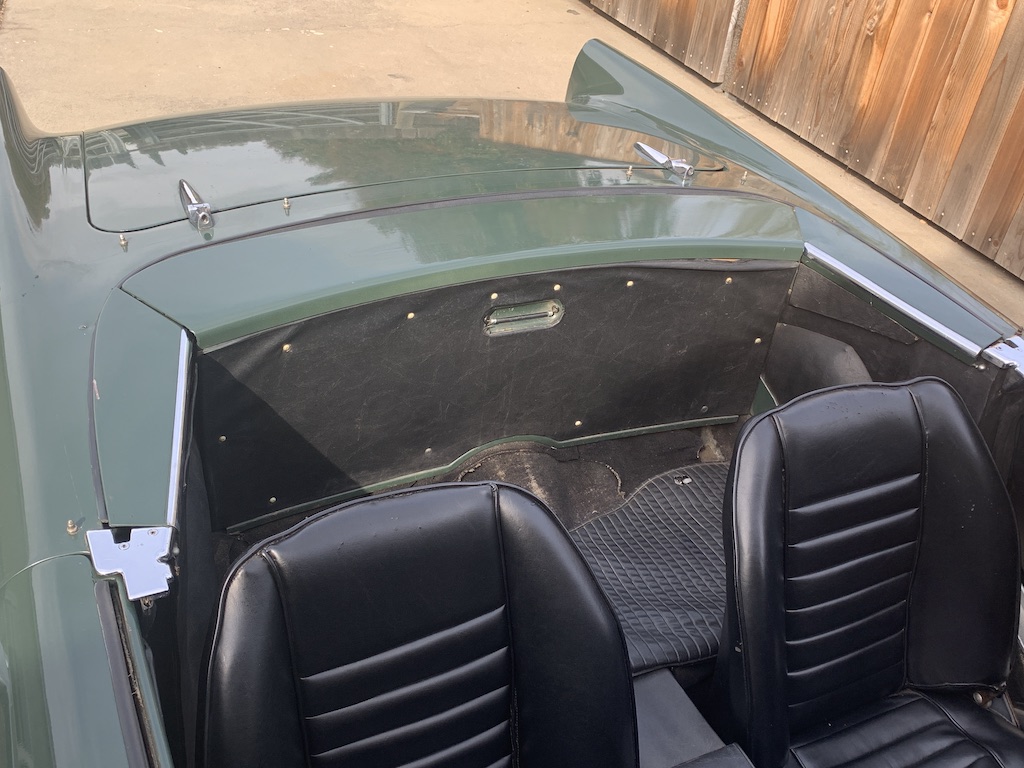

I finally pulled the top off today, which probably hasn't been off in over 35 years. Headliner is a bit stained, and a small rip in drivers side. No signs of rust, but I haven't taken the rubber off yet. Will probably replace all the rubber for now, and not repaint until the car is painted, whenever that may be. Wife drove it for the first time, she loved it.
I need to find a way to store this thing. Was thinking of getting a Thule Multilift since I don't want to use my floor or wall space.

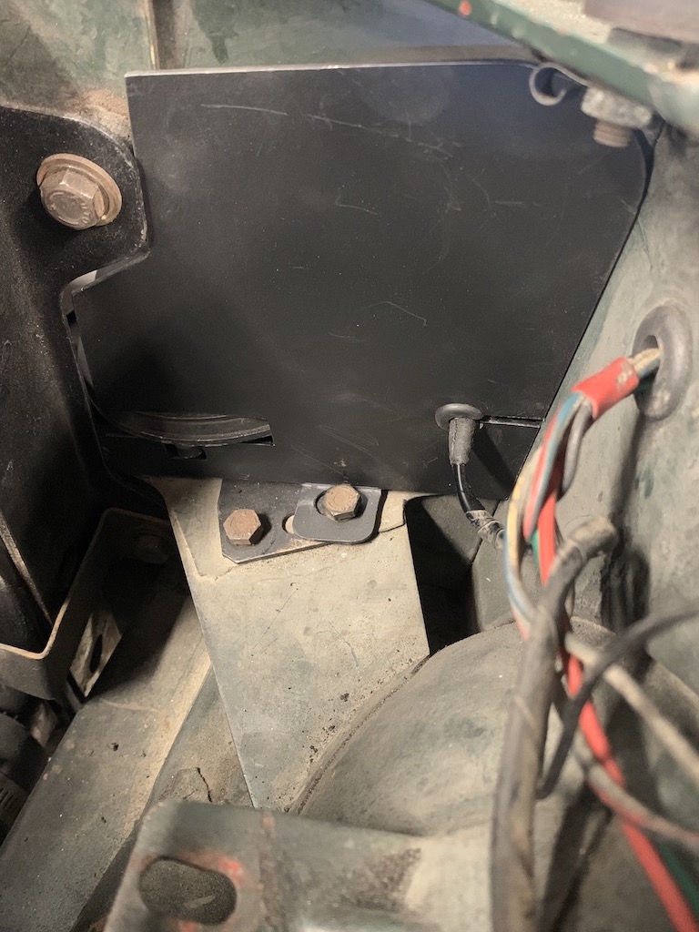

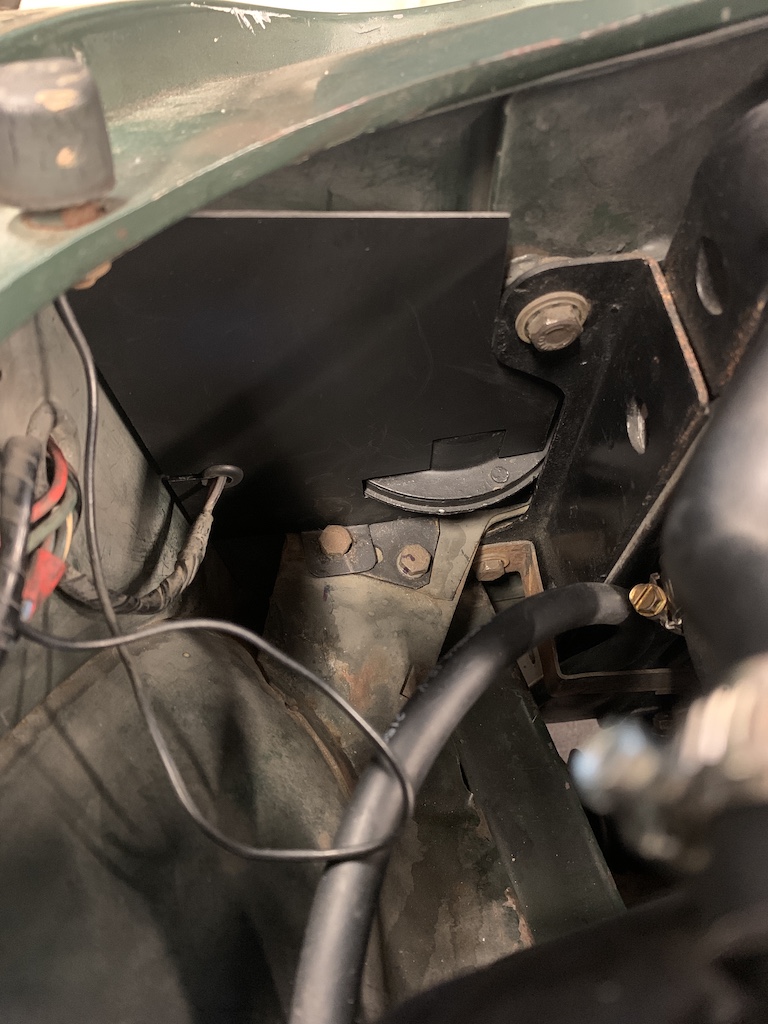

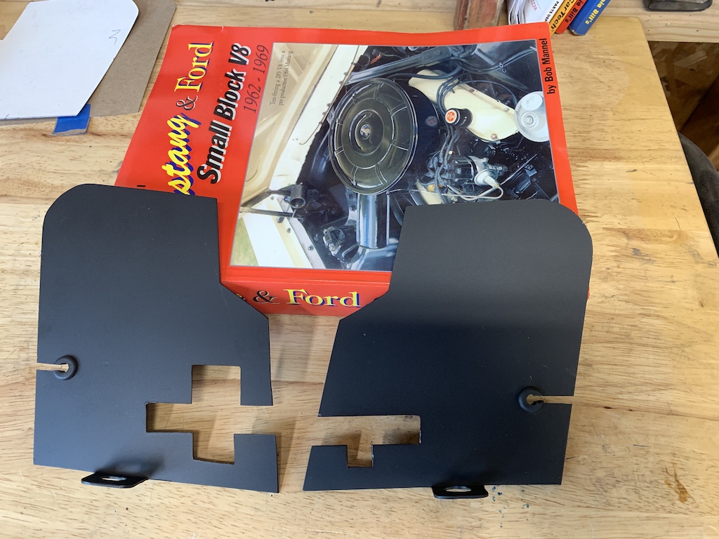

Horn Hole Plates
I noticed the engine temp creeping up a little as the weather gets warmer, maybe 220, after driving it a bit hard. :rolleyes: In anticipation of 100+ temps in summer, created some horn hole block off plates, which looks like most everyone makes up their own. Didn't feel like relocating the horns, so here is what I came up with.
Nice workmanship . . . .

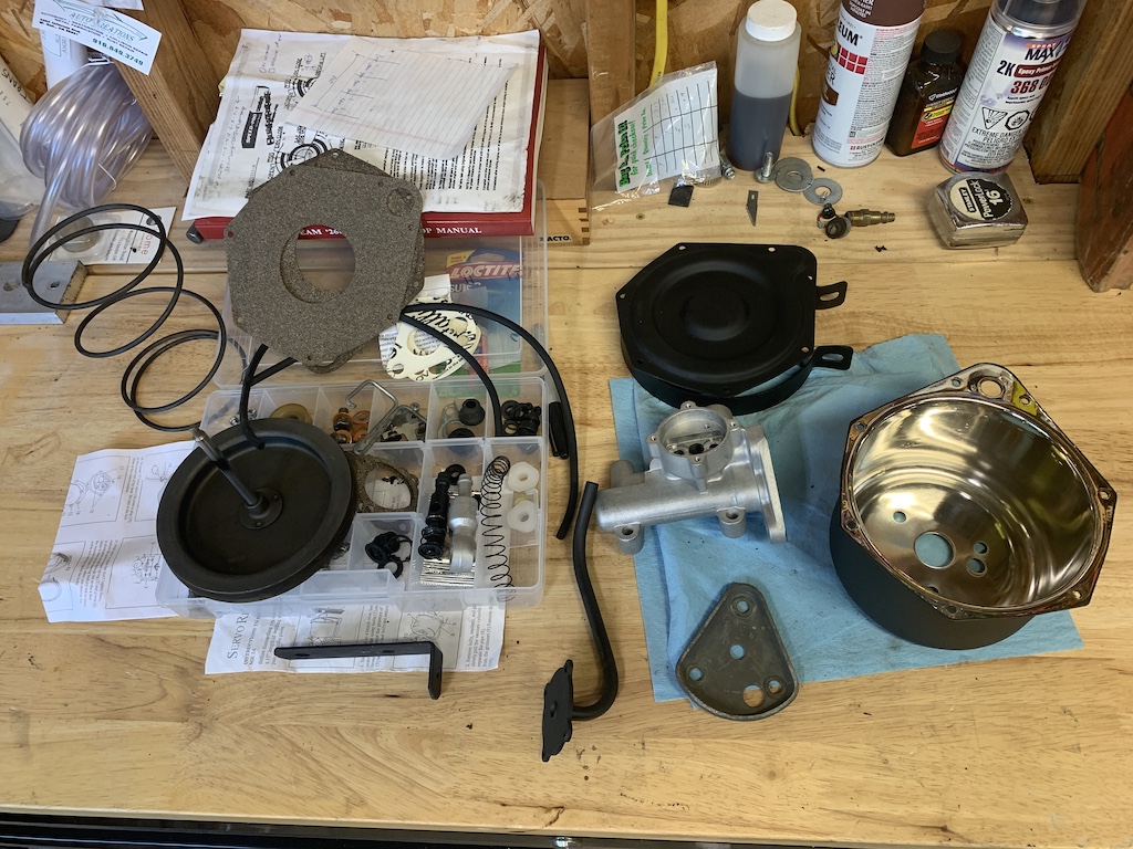

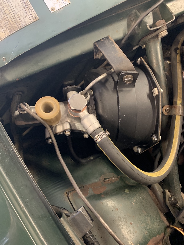

Finally rebuilt the power brake booster and installed it. Sent the cylinder out to get chrome plated, then painted the outside black, and put back together using SS's rebuilt kit. Thanks to Bryan for helping me get it back together.
Installed. Works, doesn't leak, but feels a bit weird after getting use to a solid unassisted system.

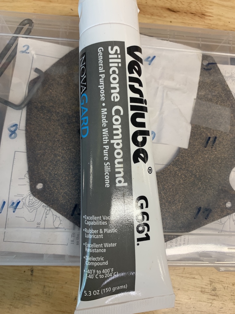

Secret sauce used on the piston seal. Used the supplied red grease everywhere else.
4,267
Yeah, wish I could get a more original looking hose clamp! :confused:
Any other options out there?
You want the sardine style clamp? Iirc there was some cross ref to a similar clamp in the forum somwhere.. Otherwise hunt an old alpine s3-V parts car with booster....
