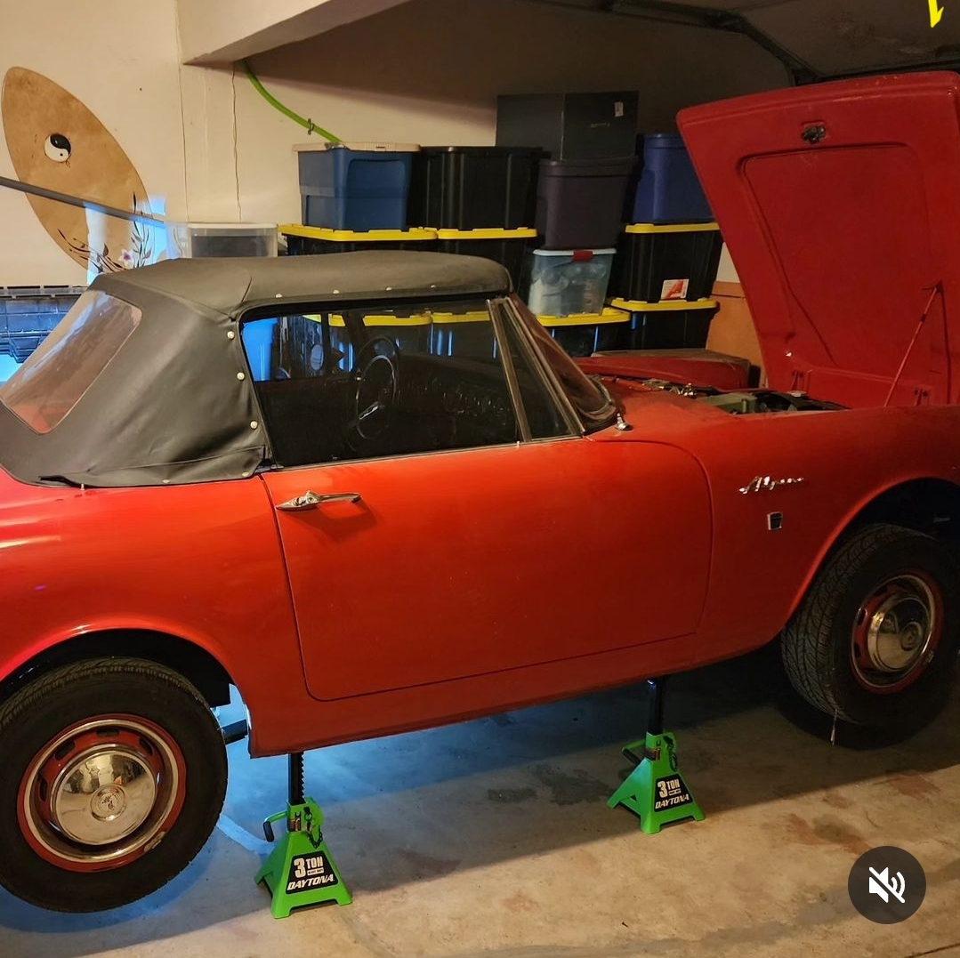

Hello fellow Sunbeam owners!
I have a 65 Sunbeam Alpine that runs has a very nice 1725 motor in it but I have grown tired of the plucky little 4 cylinder. My next door neighbor growing up had a tiger and I would like to emulate that in my own Alpine with a sbf v8 and a t5 trans for highway cruising.
I am looking for a well documented conversion but seems like all those folks that have build v8 alpines didn't take extensive notes or blog their progress.
This will be my first hot rod build so having extensive advice and instructions would be welcomed.
As it stands I was in the progress of pulling the trans and installing a replacement I bought on the forum right before the pandemic hit. I then got distracted by going back to school and becoming a dad 😁.

Thanks for the input, I'm trying to see if this is when feasible. I've got a project budget of around 15k, if that's not doable then maybe I put the new trans back in and sell it and find something else.

Those are all great points.
My main thing here is reliability, the car has spent more time in the garage than anything else. Local so called British specialized mechanics got it running but only barely and then I was out thousands.
So that begs the question.
Is the v6 conversion worth it? What's the cost? Is there step by step documentation?
Or should I keep the engine I have and do something like a 5 speed swap and use a holly sniper efi rather than the Webber I have to make it more reliable?
All the help is appreciated 🙏👍
Oh also anyone local to my area that may have a v6 swapped alpine? I'd love to come check your build out.
I live in placerville ca so I'd drive a couple hours to come check yours and maybe go for a ride and pick your brain for build thoughts.
