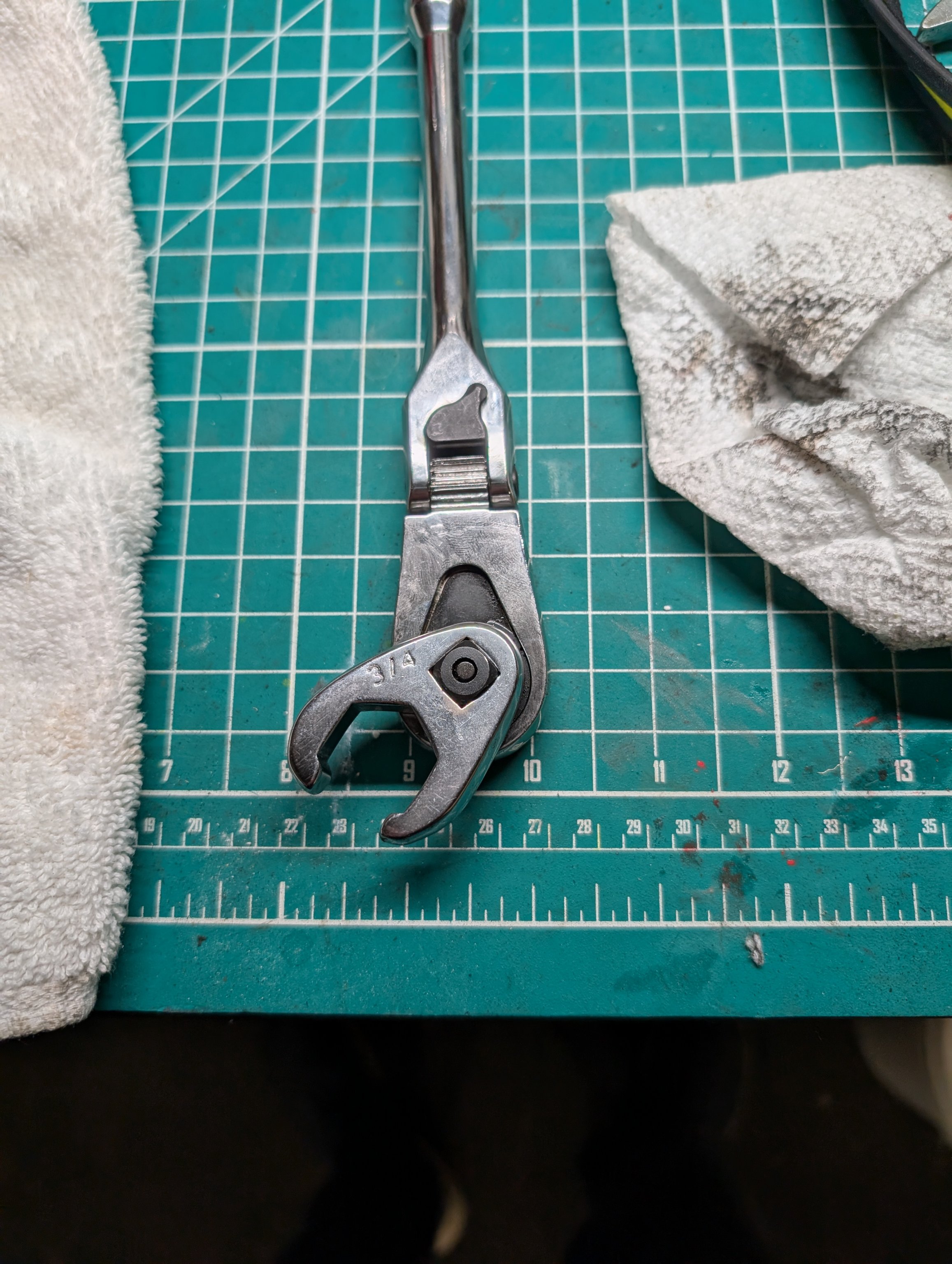

Does anyone know what size socket the drain plug on factor Mk II external oil cooler takes (SAE or metric). Appears to be close to 34 MM or 1 5/16?
Thanks,
Dan

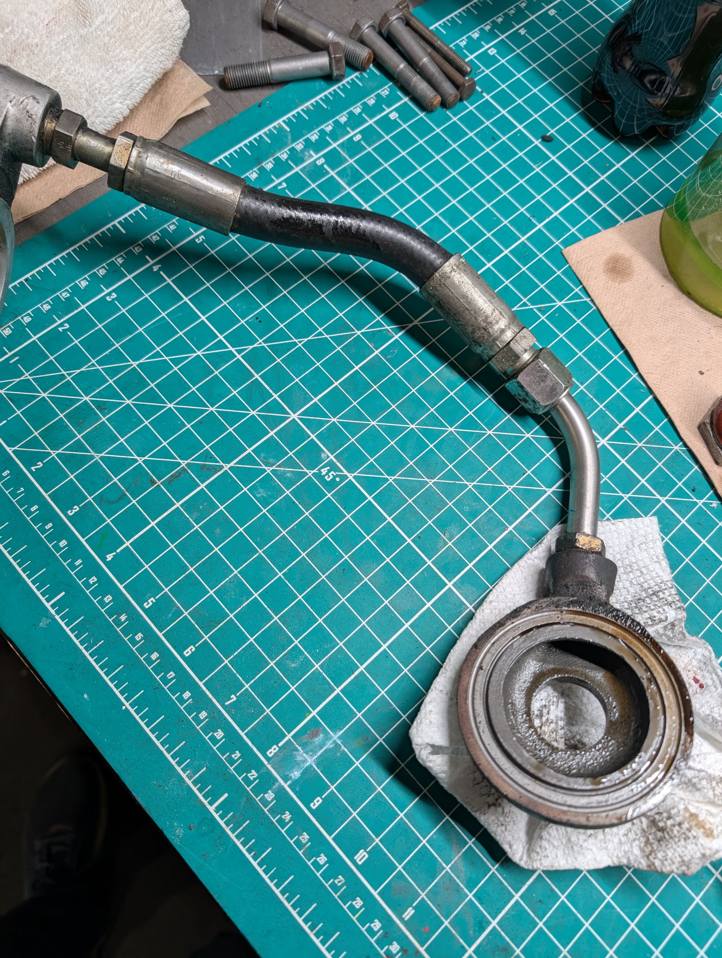

The Mk2 supplemental wrench only fits the fittings at the oil cooler. The other hose fittings are all 3/4" AF (SAE)
I have a crash damaged Mk2 oil cooler (it doesn't leak). I wanted to take it apart to either repair or replace the cross tubes. I had thought about using Alpine cross tubes as I have several. That's when I discovered the difference in tube diameter. I ended up just standing on the oil cooler which straightened it out... Now all I have to do is pull all the cooling wires out again to make it pretty... as it's a spare, I'm in no hurry.

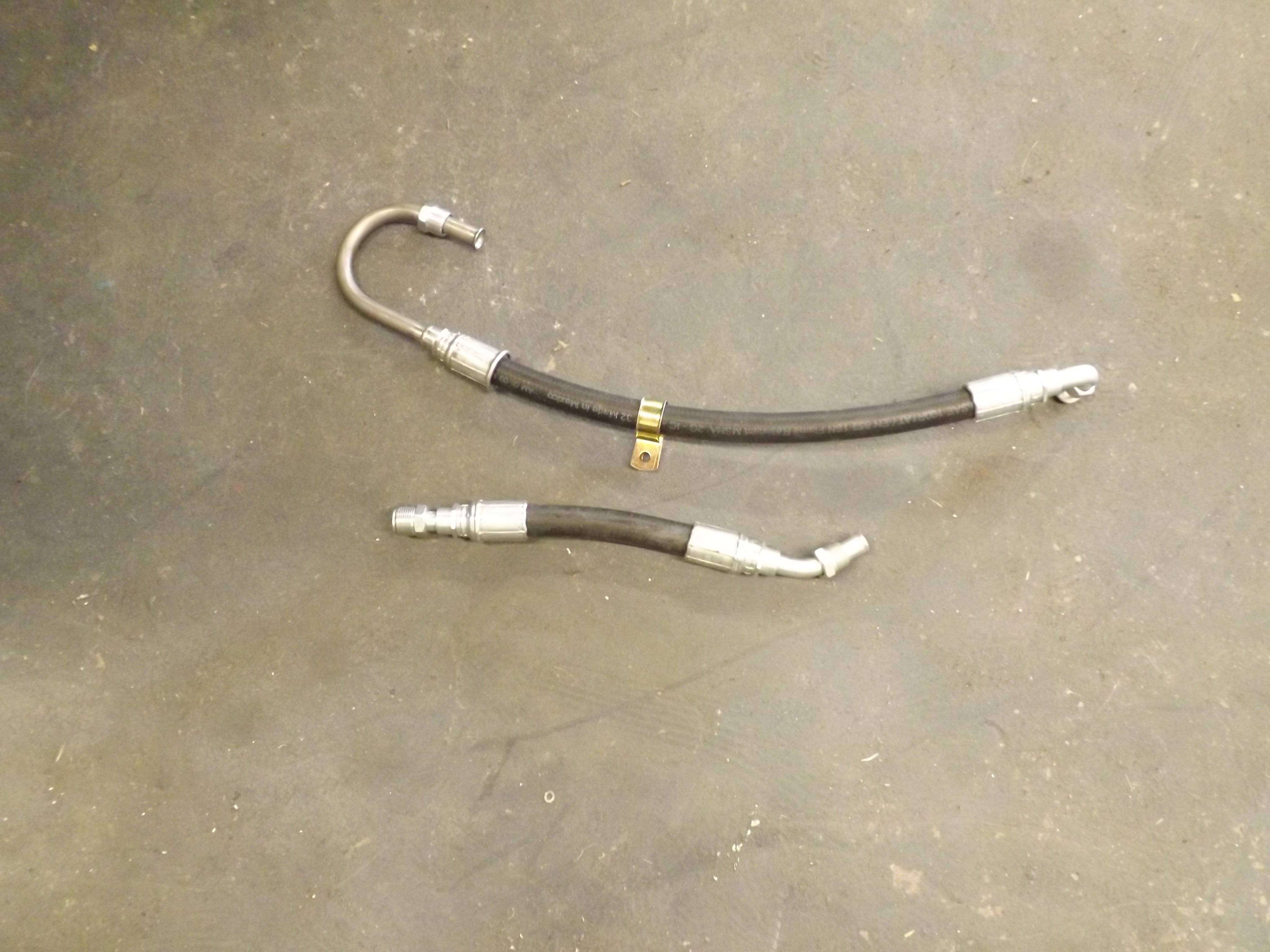

as you probably know, I make hoses for the remote oil filter set up for the all Tigers. I did specially make a set of hoses for someone in Florida to run an Alpine cooler with a Tiger. New fittings for the Alpine hoses are made of unobtainium and the hoses are different internal diameters (Alpines have larger fittings and hoses) I was able to recycle some original Alpine fittings and cobbled up a set of lines. I wouldn't want to do it again.
So, a little more than "some" modification required...
