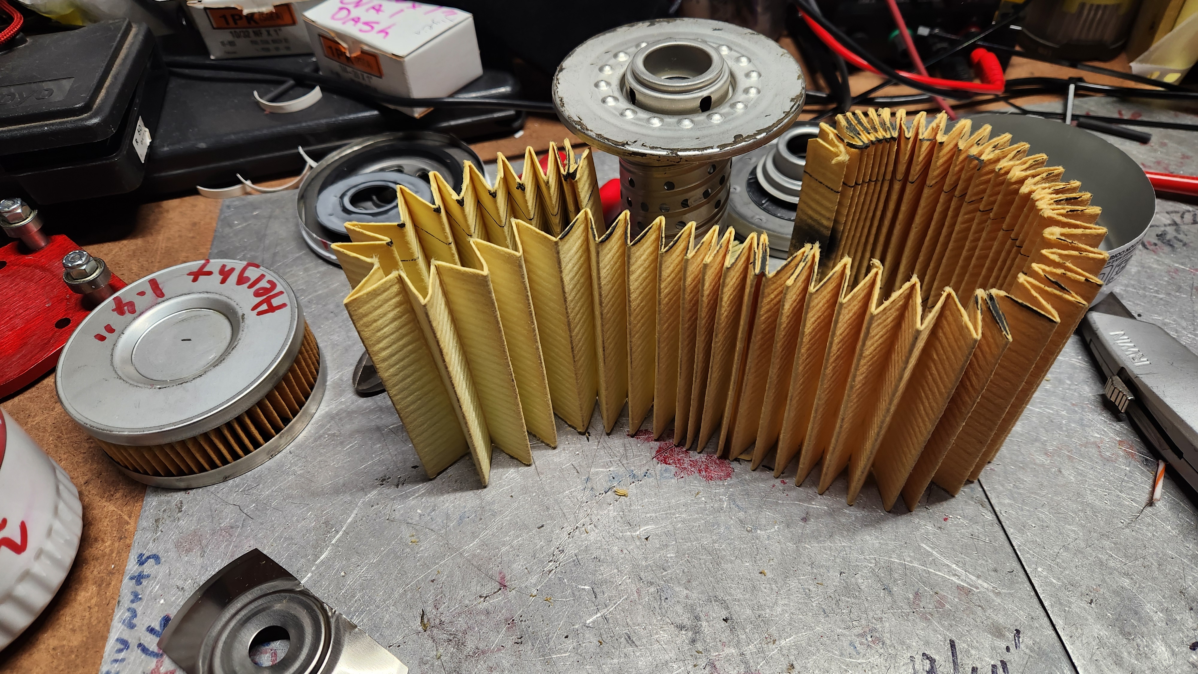

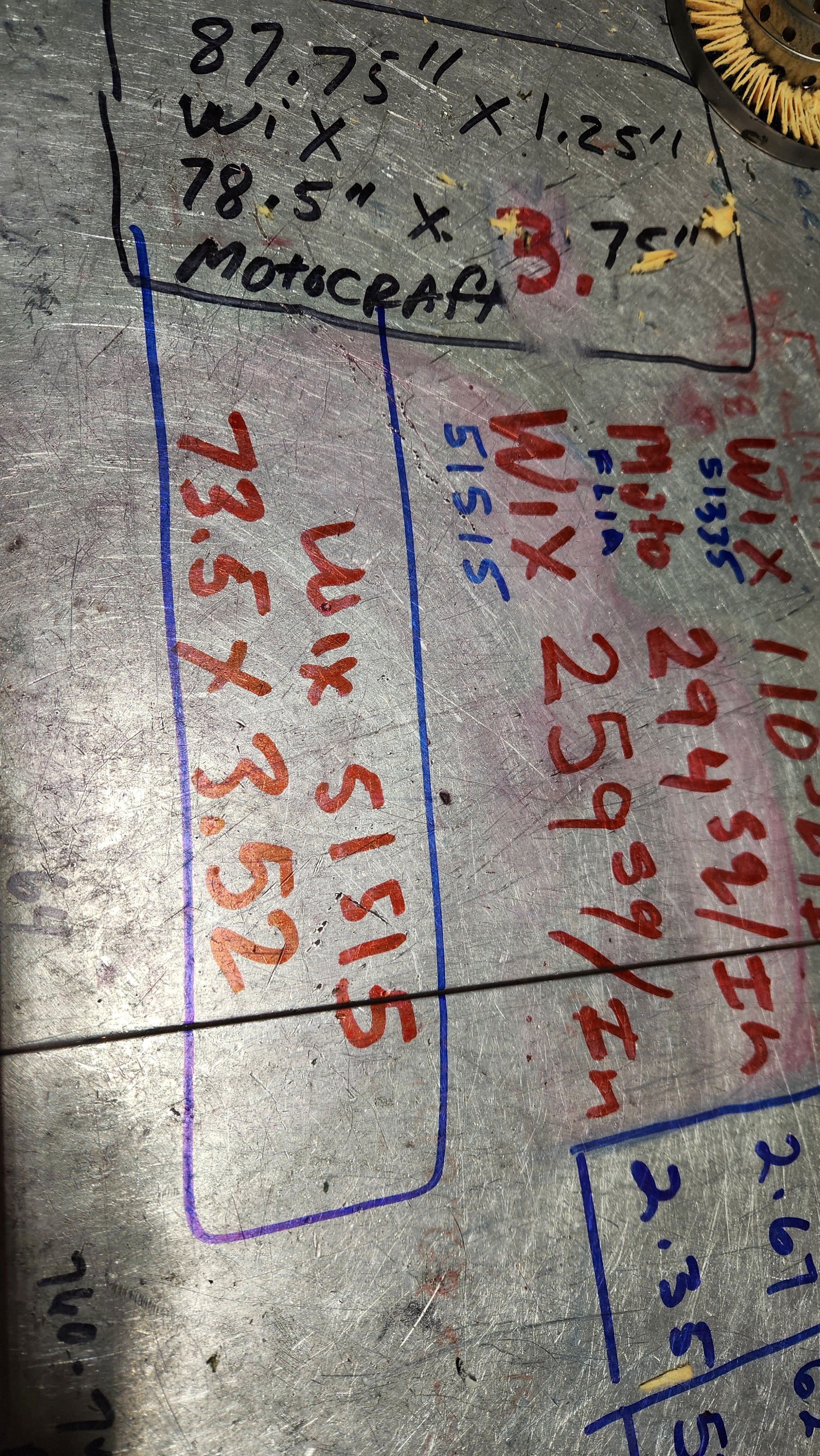

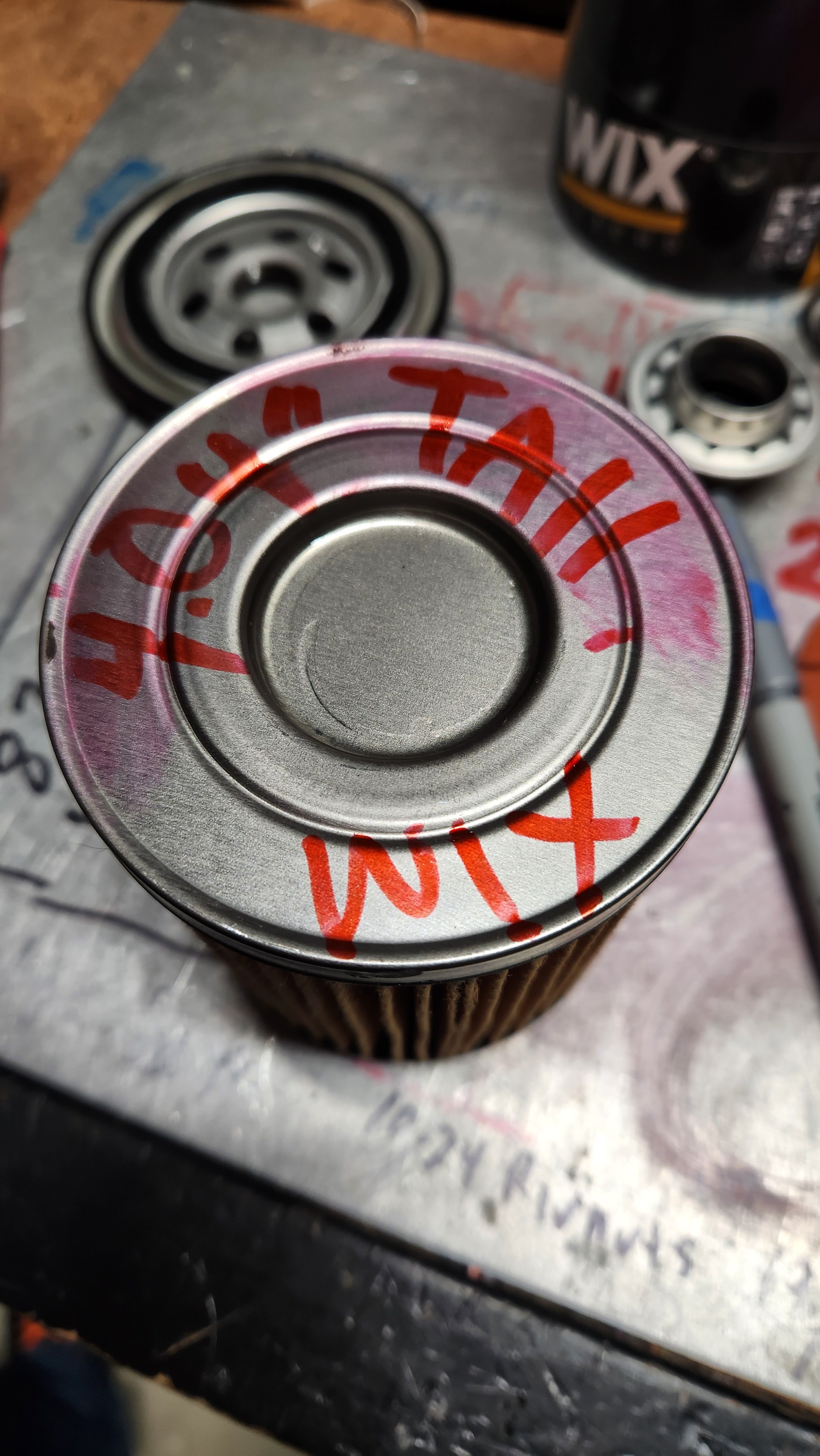

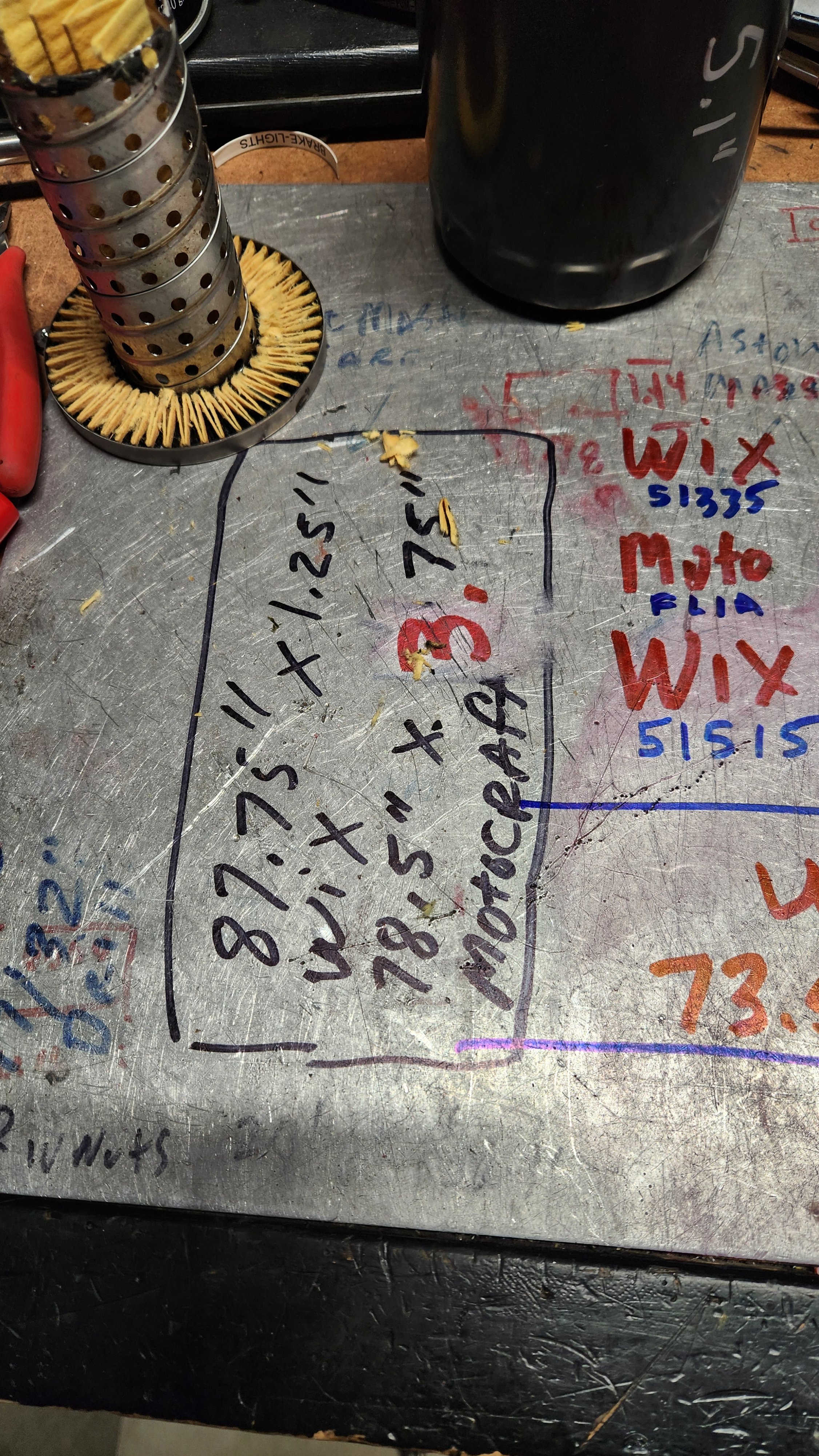

Was talking about oil filter sizes and as such on FB, and decided to do it more from a fact gathering approach and put more information for others to make their own decisions. I do not run either of these type of filters so I have no skin in the game so no need to convince me either way.

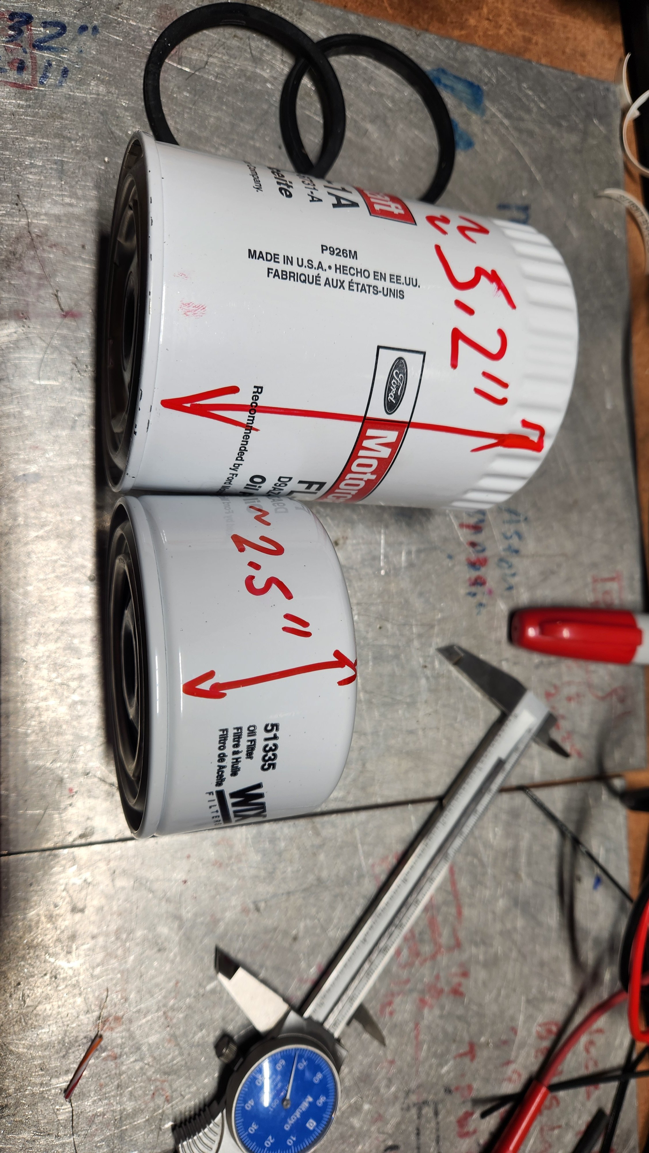

The discussion was the super shorty filter like the Wix 51335 and a full sized FL1A for the Sunbeam Tiger.
My position is the filter is small, and will be more prone to bypass when cold or as it catches more particulates. Internal bypass pressure is the same for shorty and full size. And overall just lacking filter capacity.

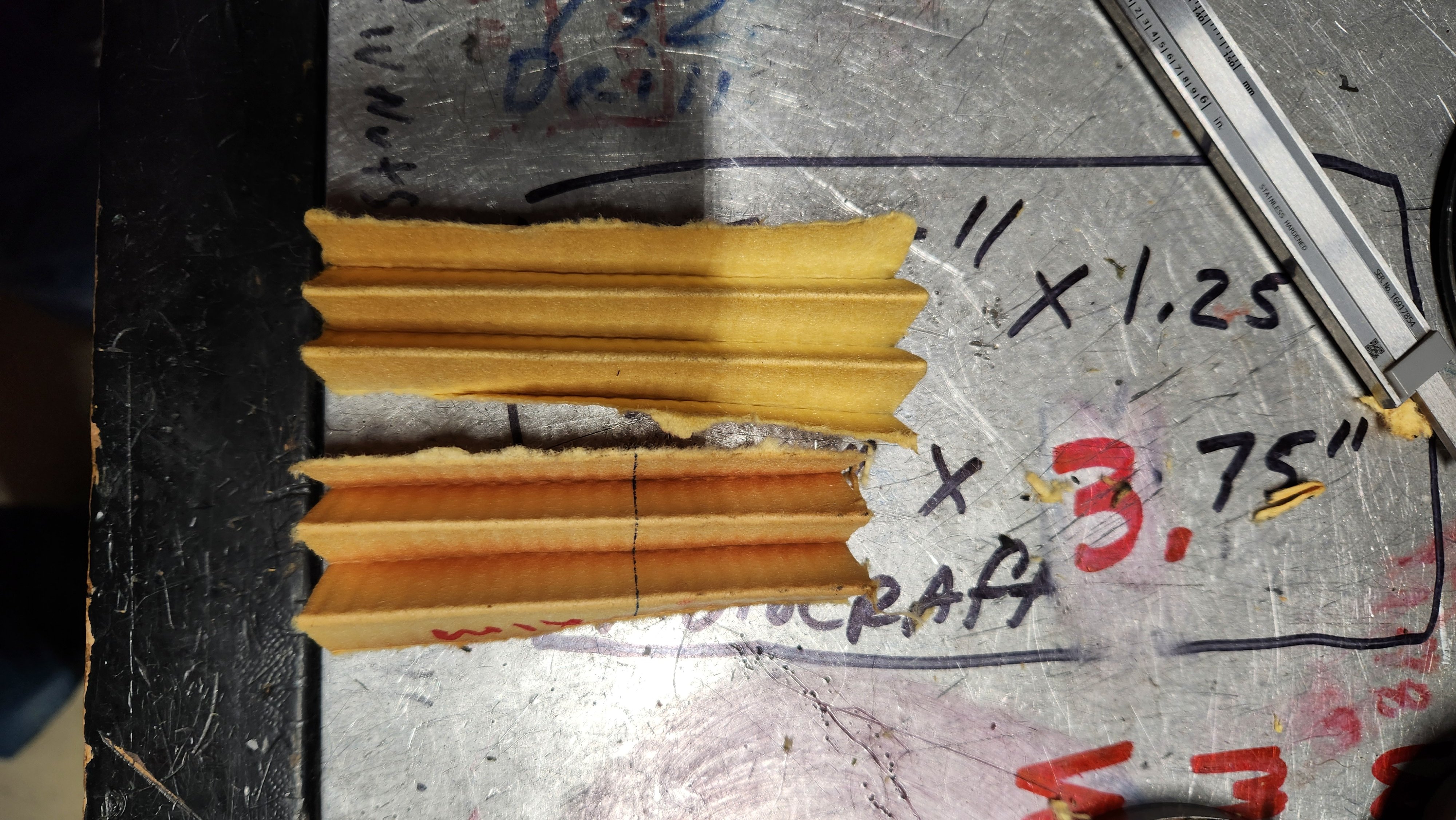

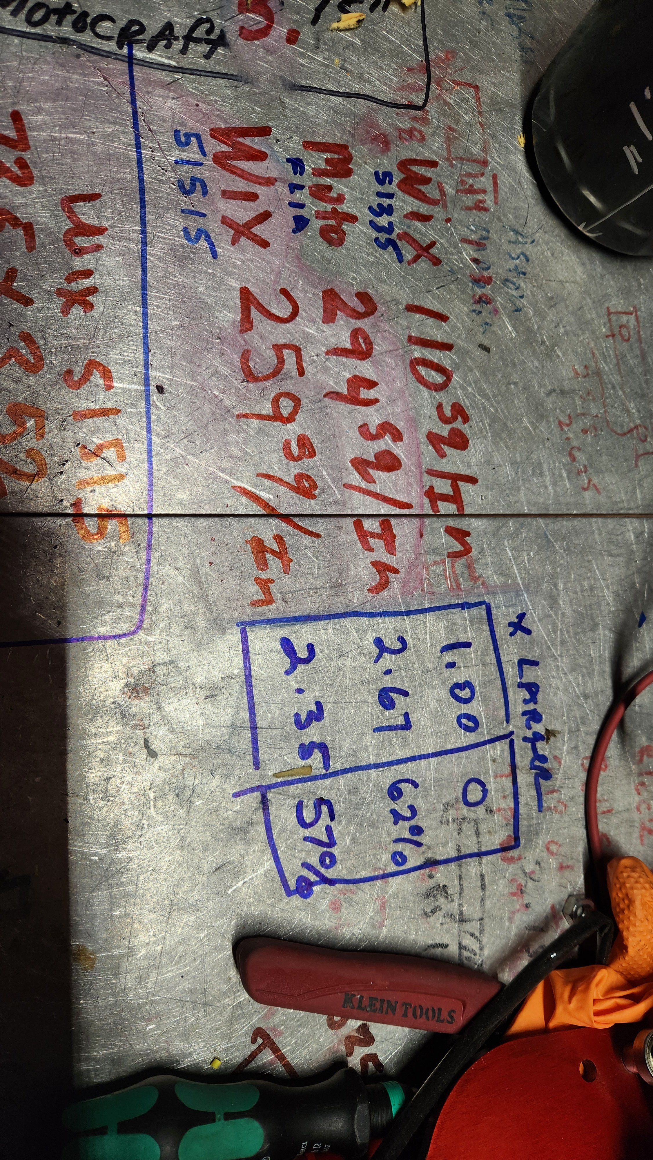

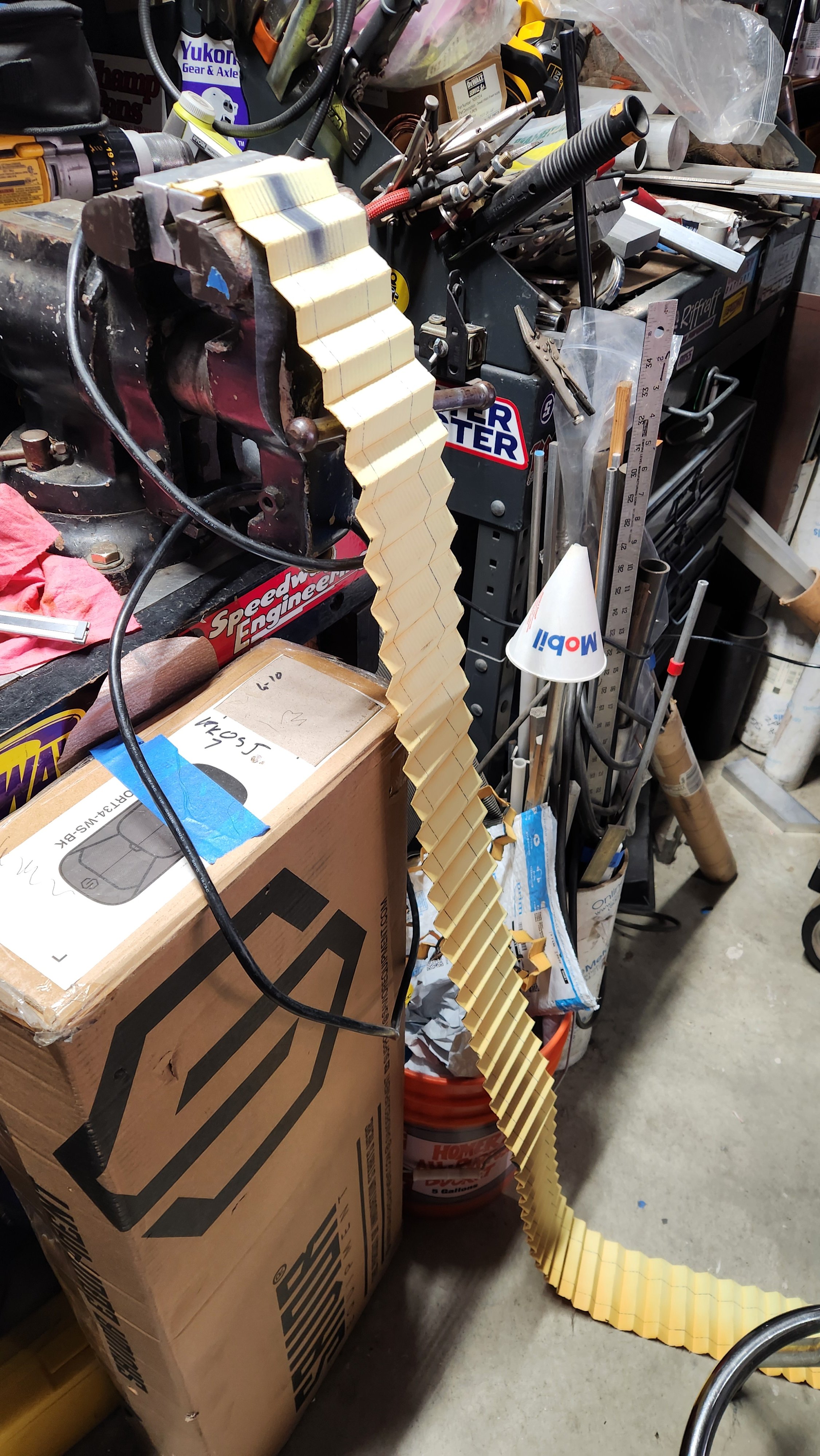

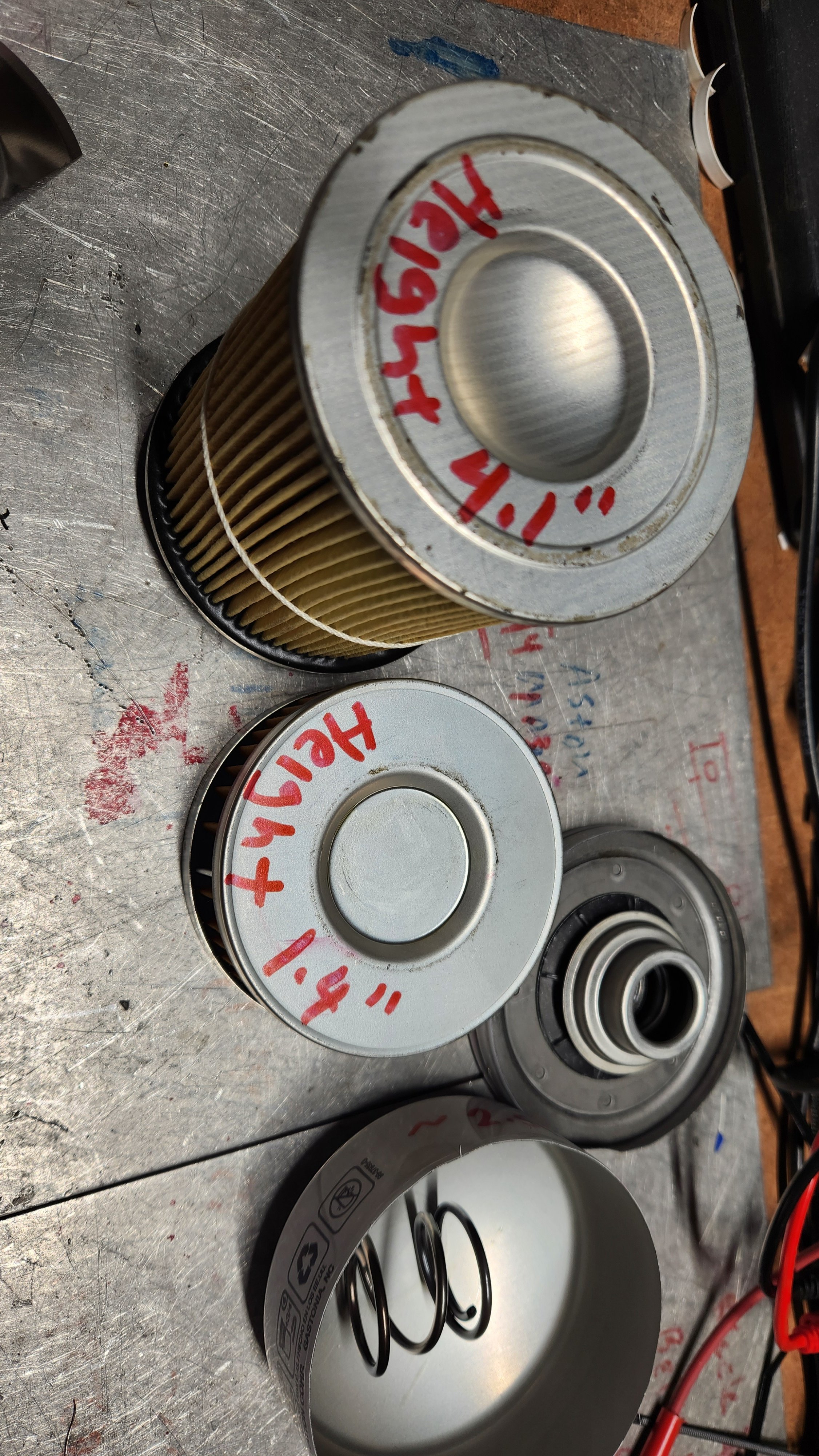

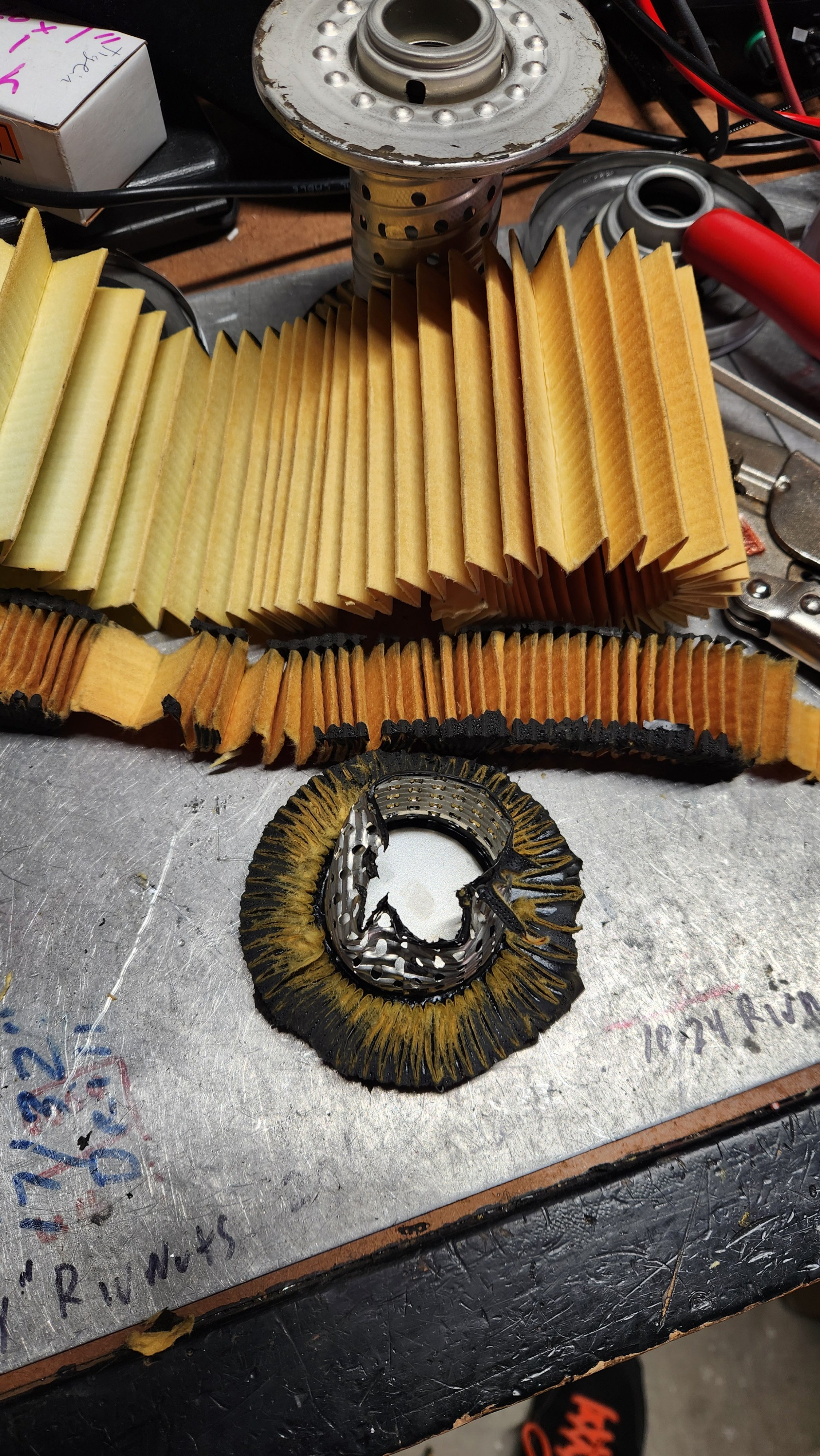

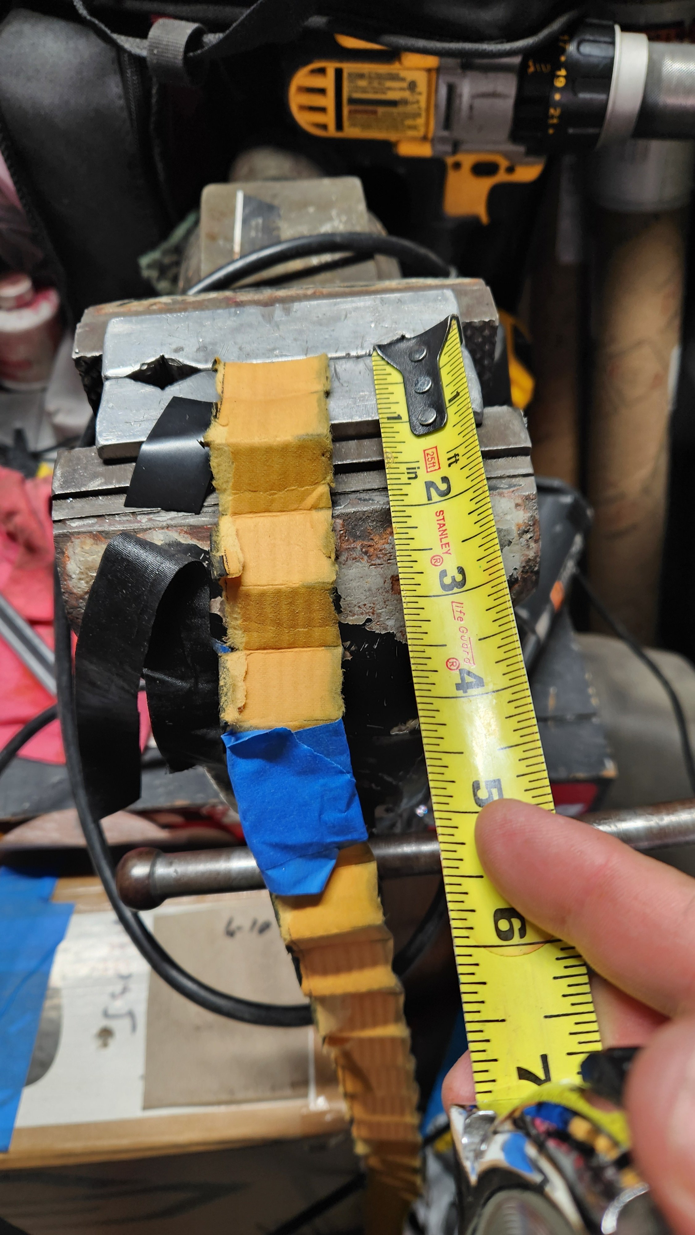

The filter difference is pretty dramatic. After cutting out both filter elements the were stretched and measured. Note the lengths are not apple to apple since different brands, but the favor of the longer element was to the shorty filter.
Details in the pics with measured area of short to large being 3x the element area.
Also note the exterior filter height is about 1/2 of the full size but more of the smaller filters guts, like bypass and related really kill the space for the filter element, it's definitely not 50% smaller but much worse.

Not sure if you are saying both filters flow the same and no pressure loss due to smaller element? And what I mean by pressure loss is the differential across the filter which will impact flow. The smaller filter has a smaller area and is more restricted. I think pressure and flow must be considered or do I have it wrong?
Oh, think both filters were Wix, just didn't have the wix version of the fl1a, so didn't show this to compare wix to Fram, but element size.

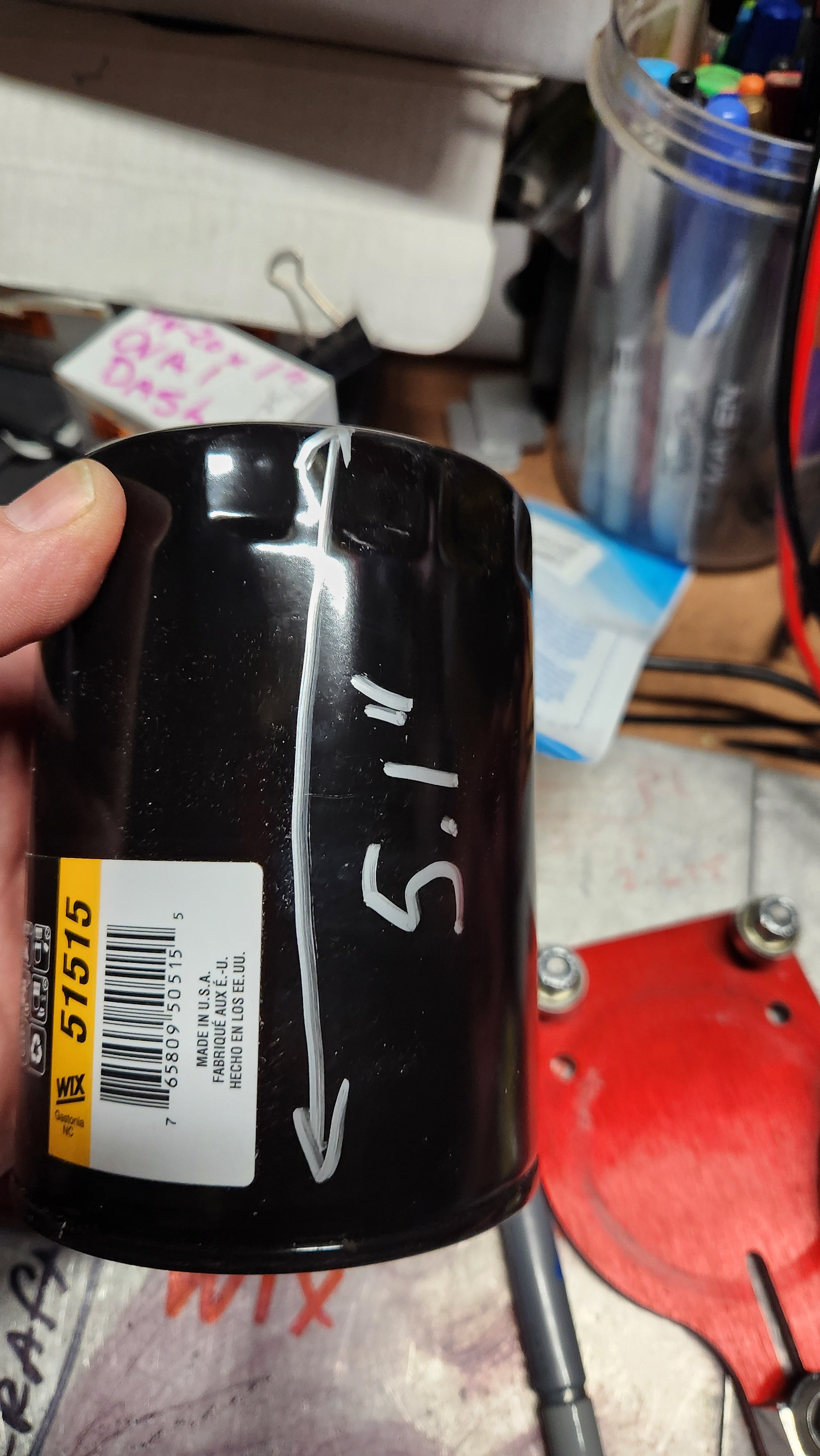

I was curious how the Wix 51516 filter I use with the Econoline filter adapter compared, so I took an old one apart. I wish I had an industrial can opener like you have!
Effective filter dimensions of filter material was 3¼" x 53" or 172 sq. in.
On your big filter calc, I'm confused where the 4.75" height came from when the paper filter assembly height is 4.1". :unsure:

Ken, you are correct. I need to learn to read a caliper!
Updated and added the Wix 51515 which oddly has a shorter element at 3.5" and length of 73.5". The Motorcraft FL1A height on the usable element was 3.75" x 78.5" and the wix 51335 1.25" x 87.75"
